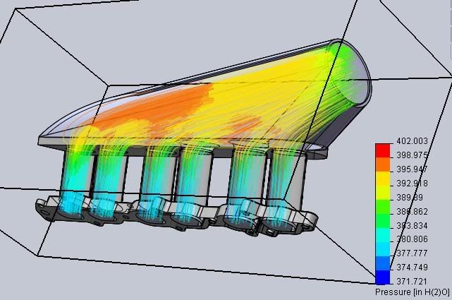

Want to put a FS-DE engine into an MX5 (Miata). I have a couple of options, one is a B18 manifold which has its own issues (port spacing), custom manifold like yours or ITBs.

pretty sure iracemine has a V2 mani on his NA race P5 and has noticeable gains
Yep.
A nice thing would be a 505zoom fabbed manifold for N/A engines... ITBs is what I'm talking about!
Havent ruled it out. But its all dollars and unfortunatley it all has to come from overseas (parts that is), and with the AUD parts have gotten about 30% more expensive in a matter of months. That 1600 dollar ITB system you'd been saving for is now just shy of 2100 dollars.
That plus the requirement of a custom header (Was going to use a BP item slightly modifed to fit).
Interesting. Checking out his thread seemed vaguely familiar, but I think that's because I saw it back before he even talked about doing the swap. Very cool. That setup is really sick though, and I think those cams played a big part on him getting power from my manifold. I doubt many NA setups out there can pull like that.
