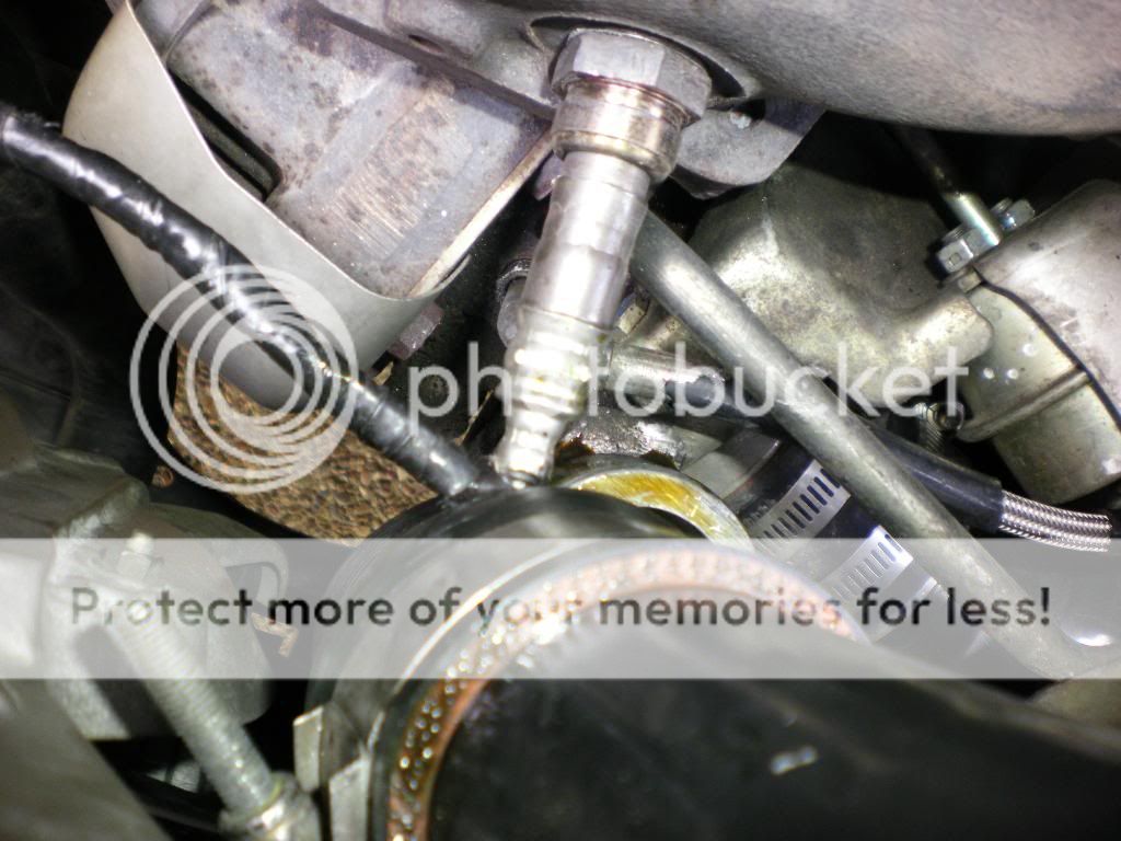

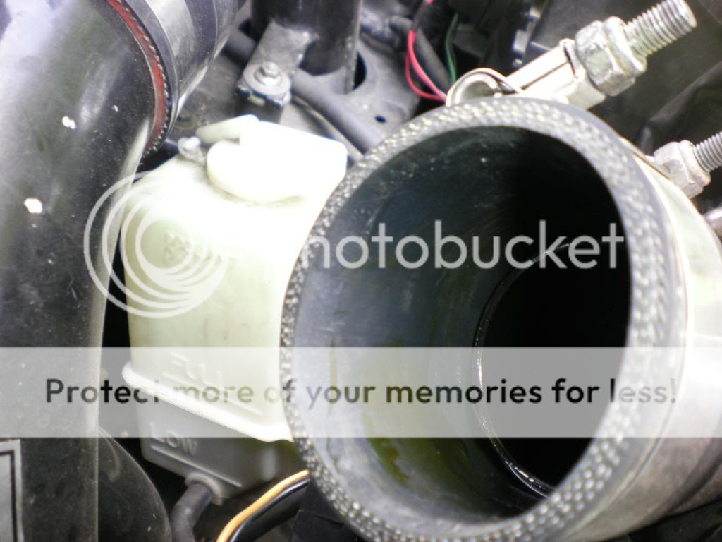

I found my high dollar motor oil today in my intercooler pipes.
and the pcv vavle is new. I'm still going to get a commpression test asap.
