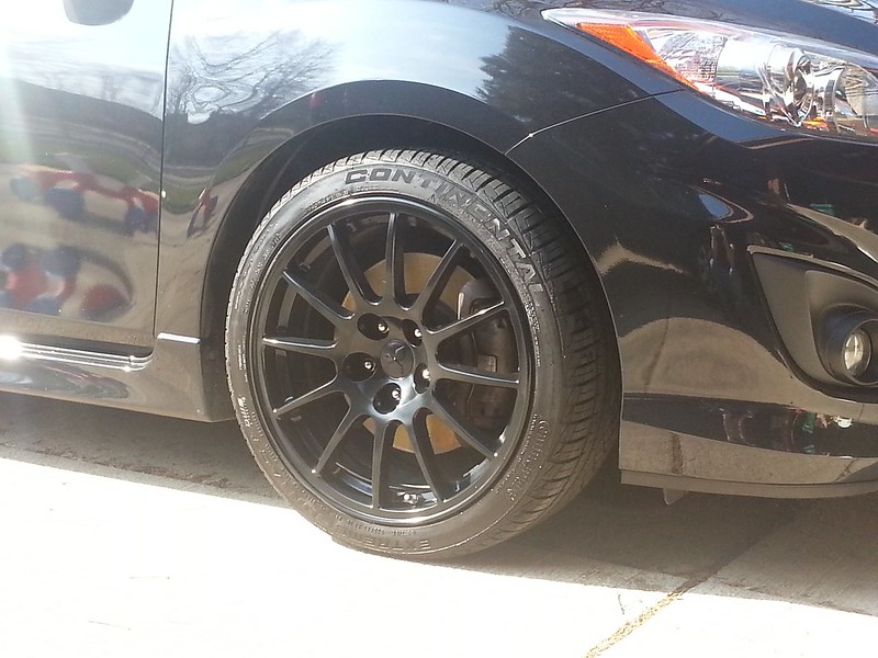

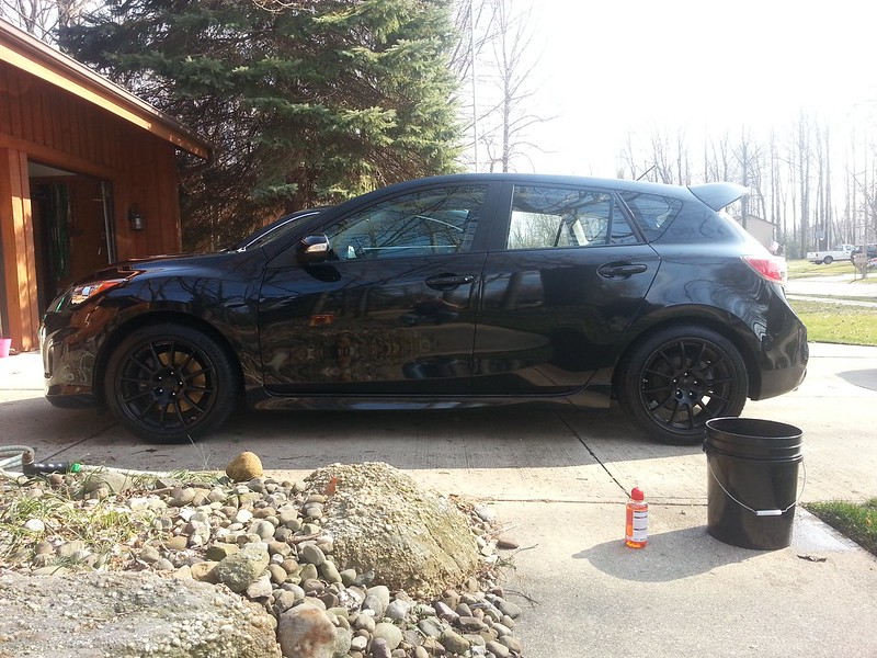

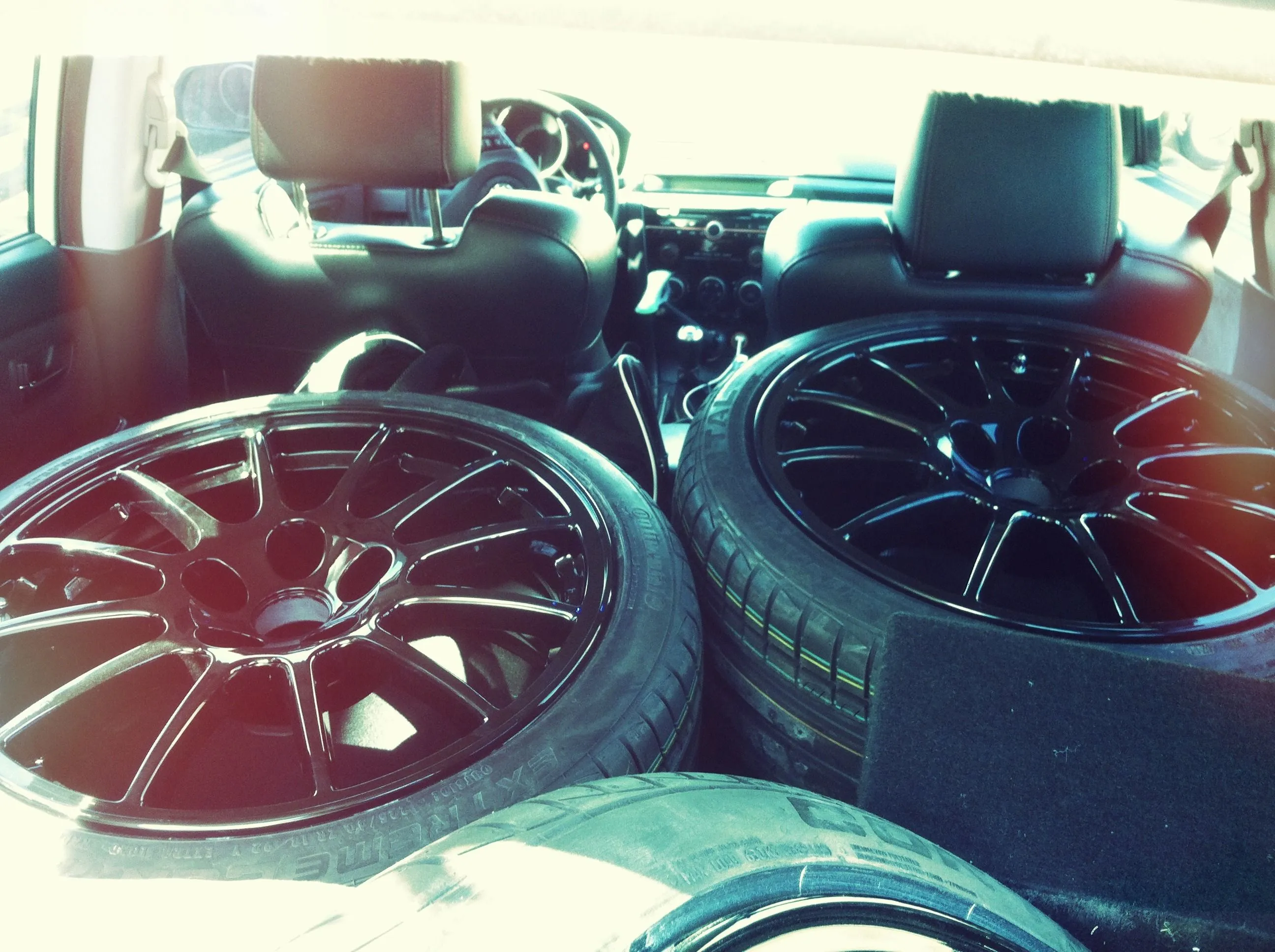

Got evo x's back from the shop after having them refinished. I am likely going the plastidip route at first. Yellow DPS delivers Monday. Need to find a fender rolling and install party.

How soon do need to roll the fenders?
What size tires did you end up going with? And where did you find Contis! They are sold out everywhere lol.
edit: Nevermind, I saw the specs in your signature. They look good!
I need a fender rolling as soon as possible. I can get the tools I just have no idea how to do it. Nor have I seen it done before either.
Lolol 'let me google that for you'. I have dremeled down the rear qrter panel/bumper tab. I tried to use a PVC pipe to roll the fender on stock suspension but the gap was too big for it to have any good leverage over the area of the lip. I heard people have seen cracking even with a fender roller, so I am trying the heat gun and PVC/baseball bat route once I get my coils installed possibly this weekend.
I haven't seen anyone riding evo x's on stock suspension, but it looks like it will hit the fender due to lack of negative camber. My factory alignment has my tires wearing down the outside more than my insides..so hoping the coilovers will add some neg camber without the need for camber arms.

I had mine done awhile ago with an actual roller and a heat gun. Was definitely worried a bit about paint, but everything went well. We flattened the rears completely - even with -2 in the back I needed the full flush roll.

....with evo x/225/40?? or a diff setup?
koni / rpm springs - far from slammed.
Don't remember the offset.. 39-42? somewhere in that range.
