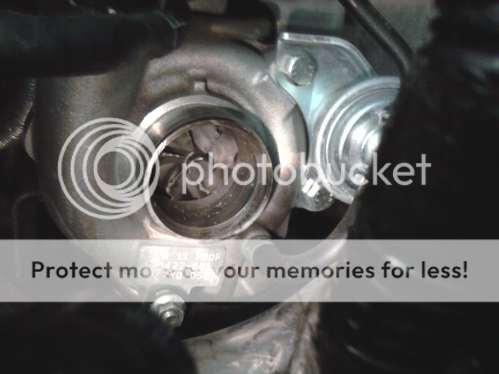

I bought an '08 MS3 back in March from a dealer up in Tyson's Corner. Essentially the exact same details as the car listed above. I got a little bit better price on it because of a ding in the driver door. Anyway, so I have been thoroughly happy with the car, and have enjoyed it.... until.....
Last weekend when I was putting on a PG TIP, and saw this

So I don't mean to appear stupid here, but wondering what makes the turbo spline chip? I picked up a '08 MS3 GT with 8800 miles on it about a two months ago and haven't had any issues yet, but like to be informed. It has very completed maintenance records and the guy has the dealer change the oil like every 1500 miles.

That had to be from debris getting past the filter some how...even if you drive it pretty hard I can't see that happening unless the turbo was defective from the start or has extremely high miles on it.
When I bought the car it was VTA, and I think that they put some sketchy plug in the recirc inlet and the turbo just sucked right in. Outside of that, I can't think of how anything could have gotten in there.

I've seen similar damage from the turbo shaft nut coming loose. It happened in my buddies RX-7 and it was not pretty...
That looks to me like cavitation on the blades, doesn't look like it's from debris but who knows for sure..
