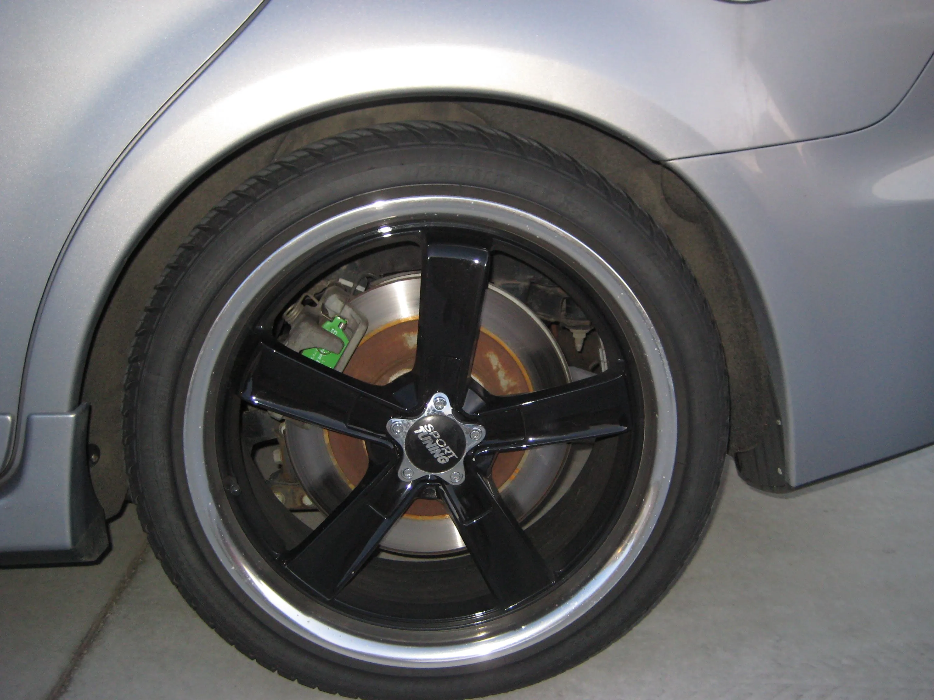

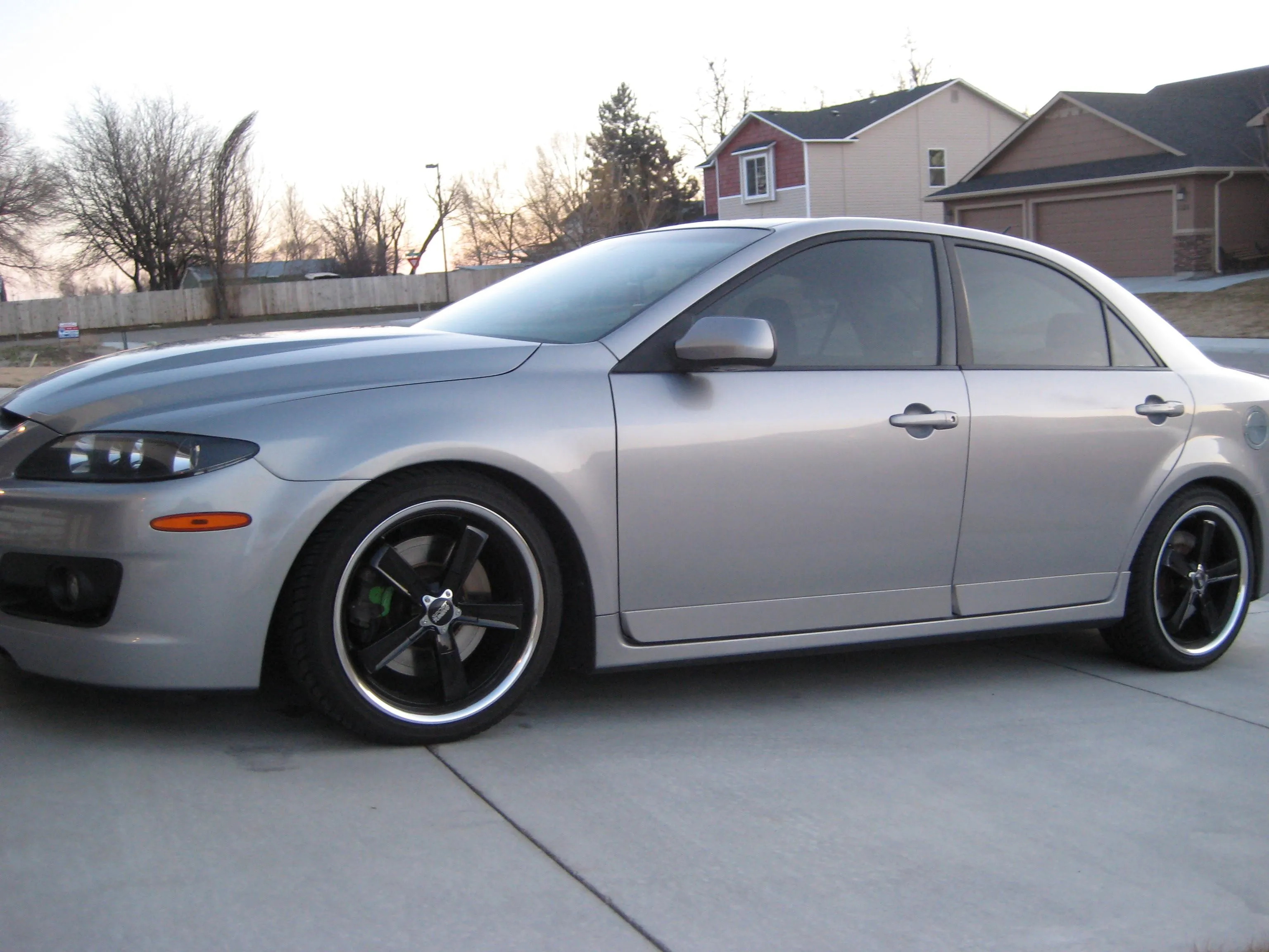

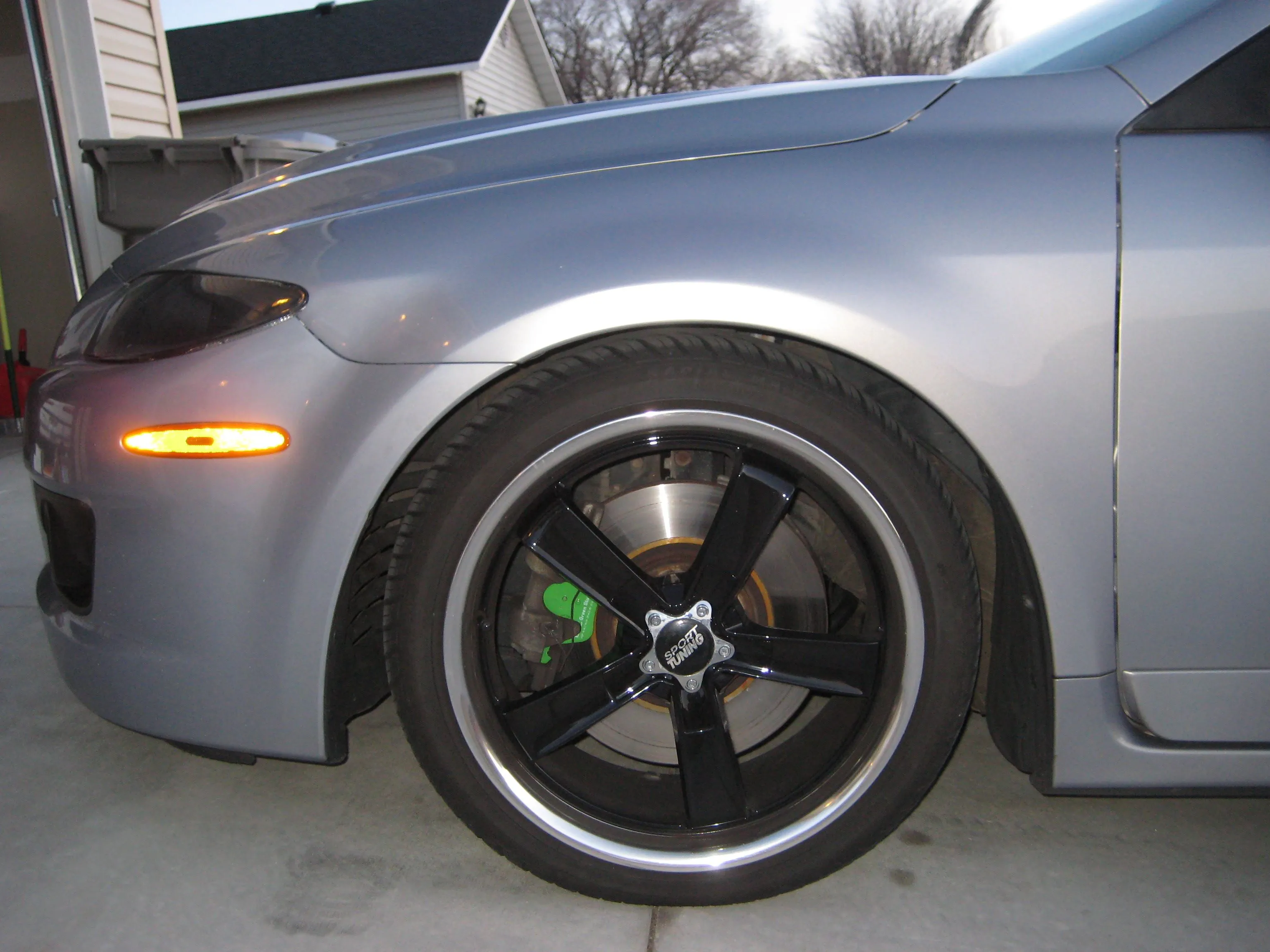

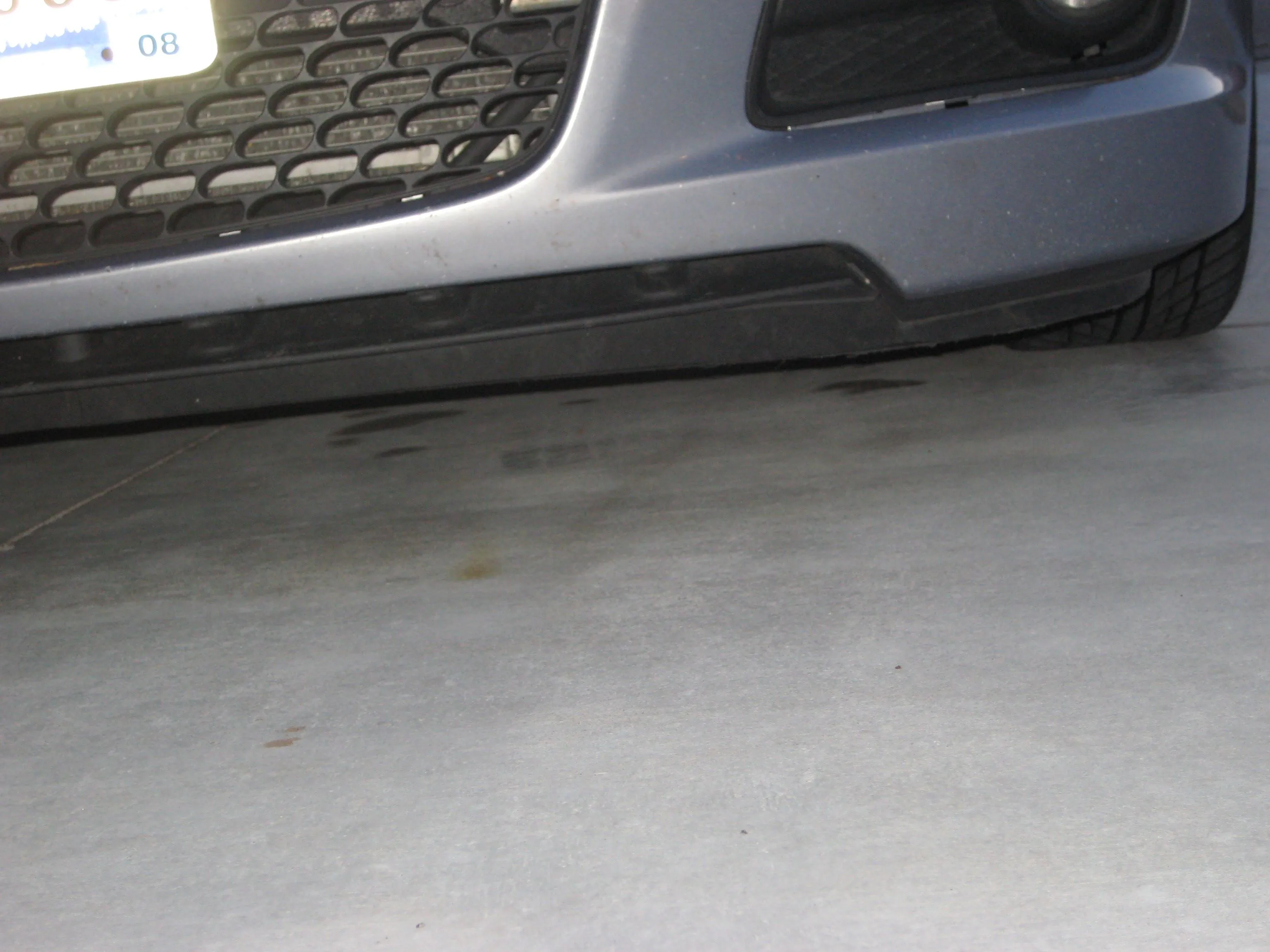

Wellllllllll.... The directions said tooo so i did. I should have asked before hand but i didnt read the entire HOW-TO... and i didnt wanna put everything back together and then take it apart again. I took pics too, im gonna try loading them now.
Pics...
So guys, before u say it..I know the rust on the rotors look pretty awesome! Thats custom! Ok so not really. I bought paint and i am gonna do it soon. Trying to work slowly cause the WIFE keeeeeeeeeeepppppps complaining about me working on the car. Did the turbo inlet today, maybe ill paint em this weekend.
