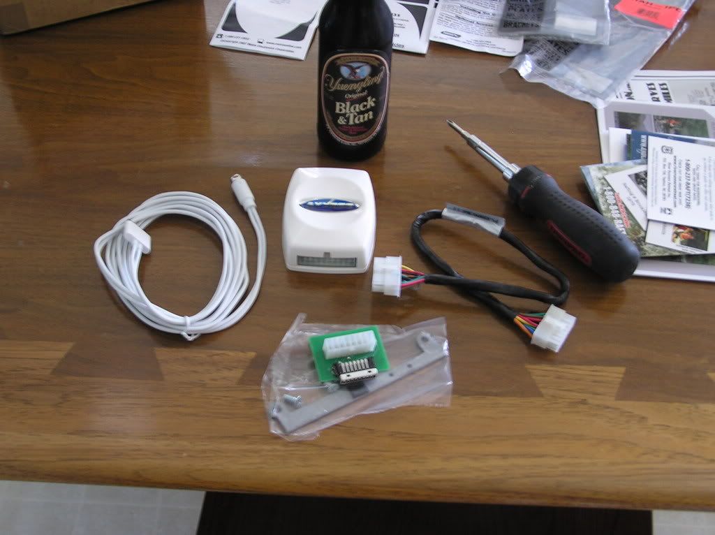

Heres what you get when you order the kit, with the iPod adapter (there are a few options, iPod, xm, aux, or any combination)
(beer) beer is much needed, as it was hot as hell out there....

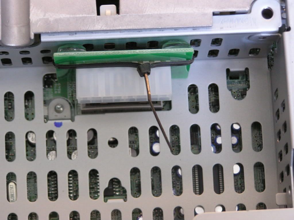

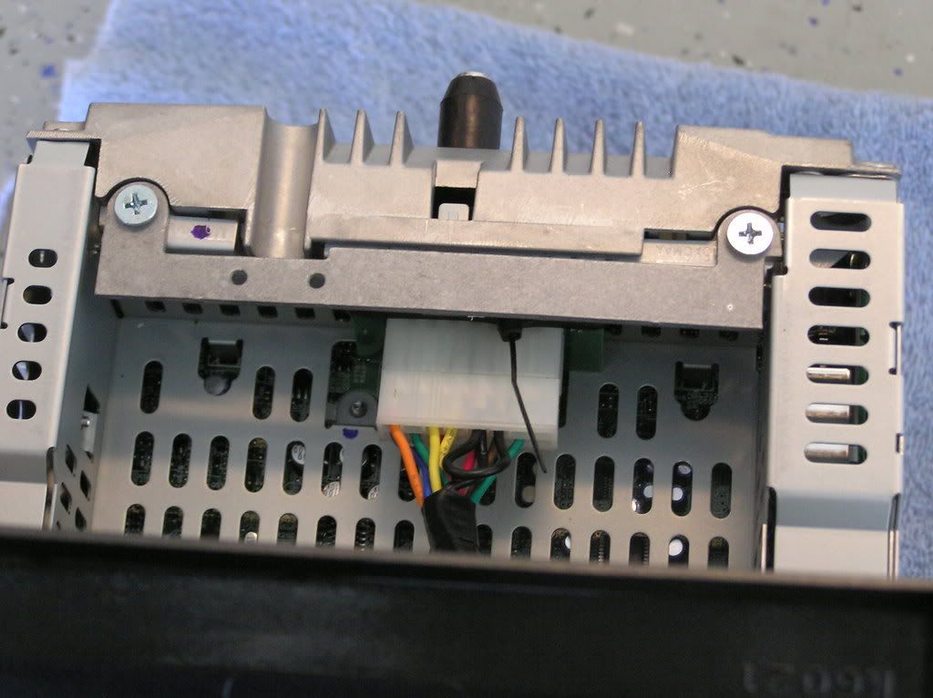

Flip the radio over, and you will see an unused plug under the CD player. This is where the circuit board goes.
I personally did not feel this was secure enough, even with the strap of metal they give you to secure it in place, so I ziptied it to the radio.
Then attached the strap.
Next attach the wire the came with the unit to the board and the Axxess box.

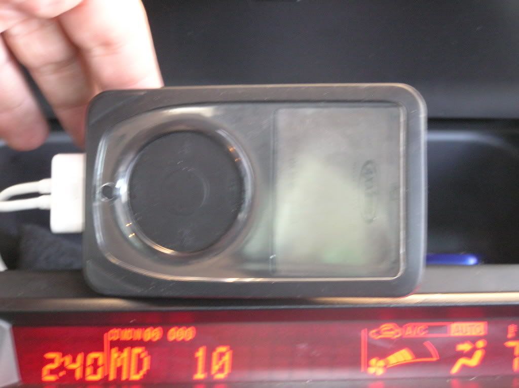

I next tried to figure out where I wanted the iPod to live. We basically have two options. The armrest, or the map pocket. I decided to go with the map pocket. To remove it, simply remove the two screws under the LCD and pull forward. I then cut a hole in the bottom with my pocket knife to the size of the plug, then slipped the plug through.

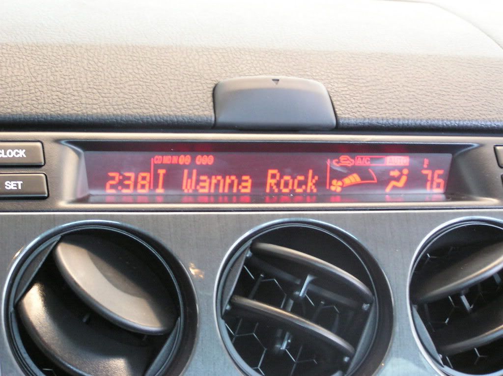

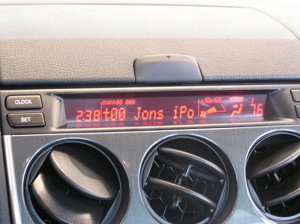

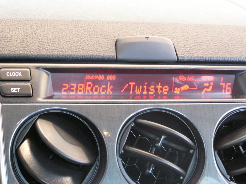

impressions:
works well so far :D
I have heard that the unit can overheat, so I will watch for that and report back if it does..Otherwise, I've got to figure out how to switch playlists and stuff, but it seems to be working well :D

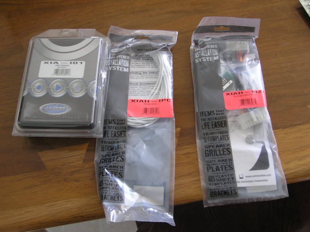

here are the part numbers you need:
Axxess control unit: XIA-I01
Mazda Specific adapter: XIAH-MZ1
Pick 1-3 of the following:
iPod cable: XIAH-IPC
XM cable: XIAH-XMC
RCA(aux) cable: XIAH-RCA

At $175, not too bad. I can get it for about $150 as well as I am direct with Metra, I'll think about it. I have the one from eBay,works great. I can select songs via stereo, steering wheel, or iPod. Only downside is there is no text,but I can also switch playlists through the radio.
I just got my 6 2 weeks ago, and installed my axxess unit tonight. Took a couple of hours, but was simple overall. The write up helped....THANKS!
So far so good, but I don't get any text, maybe b/c I have the iPod Nano instead of the "normal" iPod?
