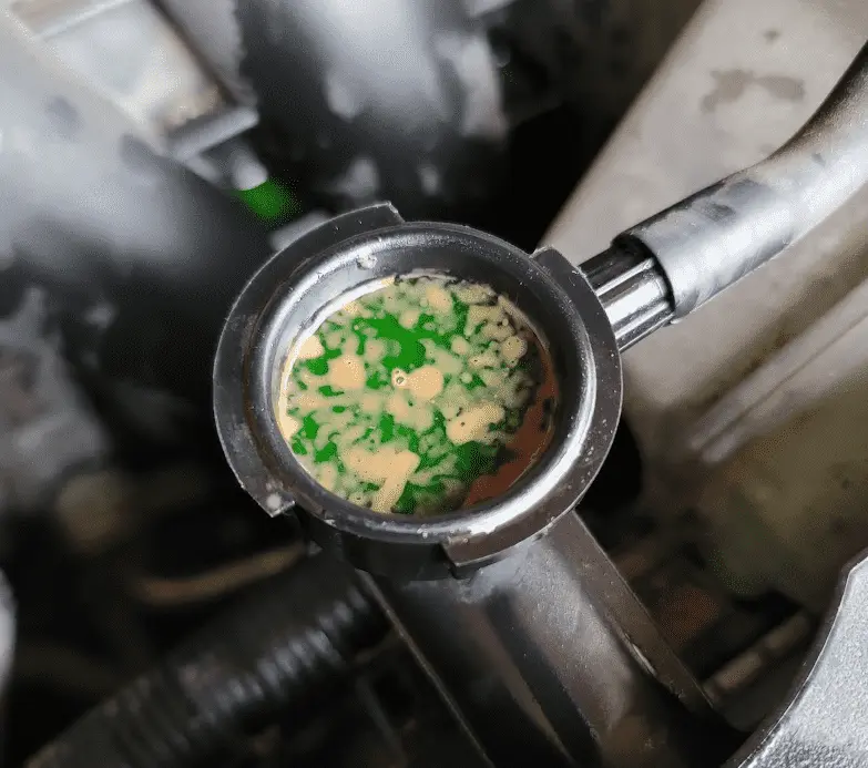

So, after 9 years of loving the hell out of my 2014 Mazda6 Touring with a manual, I went for a drive this last February and got an overheat warning on the way home. Got it home fine and started some investigation. Didn't take long to figure out that I had a real problem on my hands
Obviously the oil ain't supposed to be in the radiator. Pulling the dipstick, I had a real nice looking milkshake going on. Not want to face the inevitable yet, I called a local shop that I always take our cars to and talked through the options. Obviously the prime culprit was probably a head gasket, but I did recall reading about some early year Skyactiv engines that had cracked cylinder heads. My options were thus:

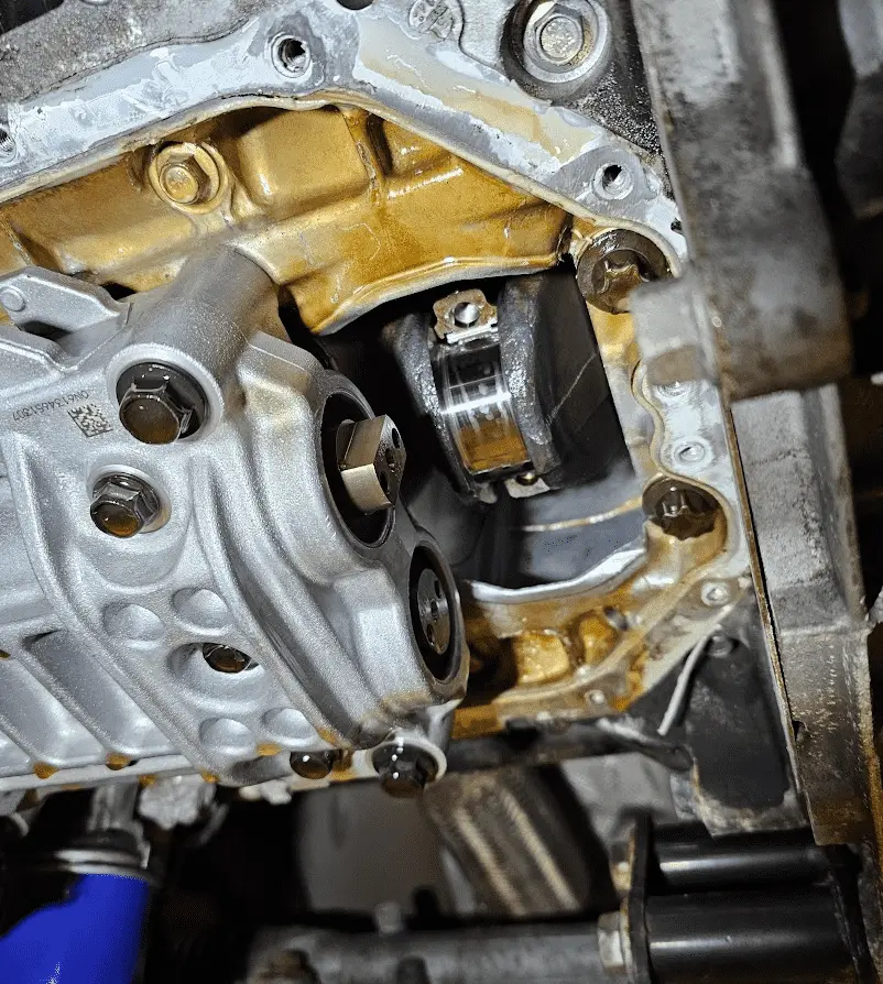

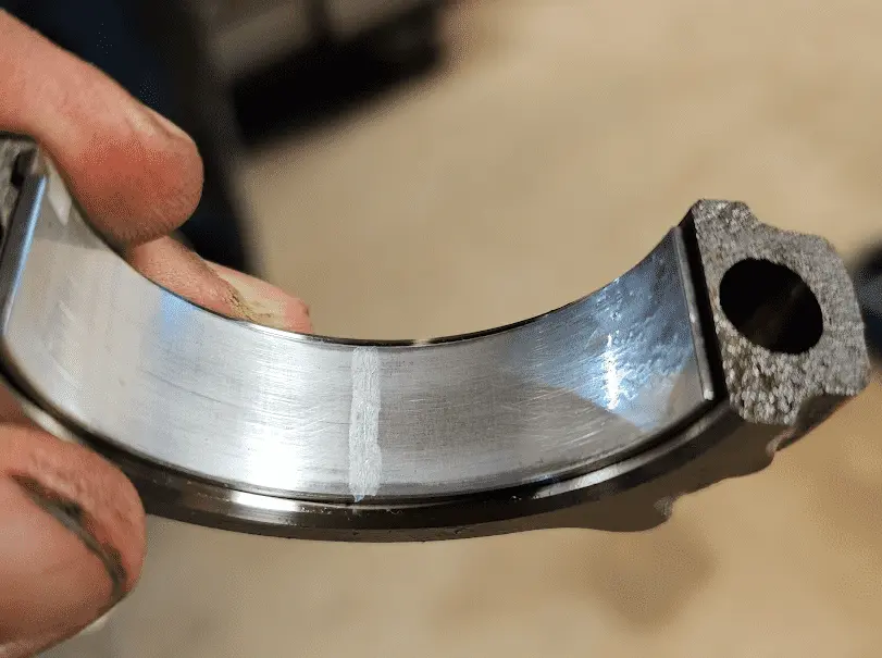

First order of business was to see if the engine was worth saving. I've done plenty of car work in my days but nothing to this extent, which is why I had engaged an outside consultant. In his words, "We'll pop the oil pan, pull the lower rod caps, and see if the bearings are washed out or still within spec". Now, I'm a mechanical engineer and have worked in engine design so I know what he's talking about. The thought of doing it on a modern automobile engine that's installed in a vehicle is another thing entirely. "Go to O'Reilly and ask for plastigage, one red and one green. Don't bend it, open it, or get it too warm". This was a new one to me, so off I went.
Turns out Plastigage is very thin plastic rod that you put in the bearing races then reinstall. When I asked at O'Reilly I got a blank stare from the younger guy and a "Holy hell, what are you working on?!" From the old gent in the back. I think I made his day. took both of them working together about 14 minutes to dig it up in the back.
Once you pull the cap back off, depending on how much it squashes the plastic you compare it to a gauge and you can see what the clearances are. Pretty ingenious. With the big oil pickup underneath the only rod we could see was cylinder 4, so we pulled that cap, popped the plastigage in, and retorqued it. Took it back off and took a look. Lucky me, the clearance was right in the middle of the factory spec. From that, we made the great assumption that the other bearings are probably okay too. So the engine might be salvageable, on to step two

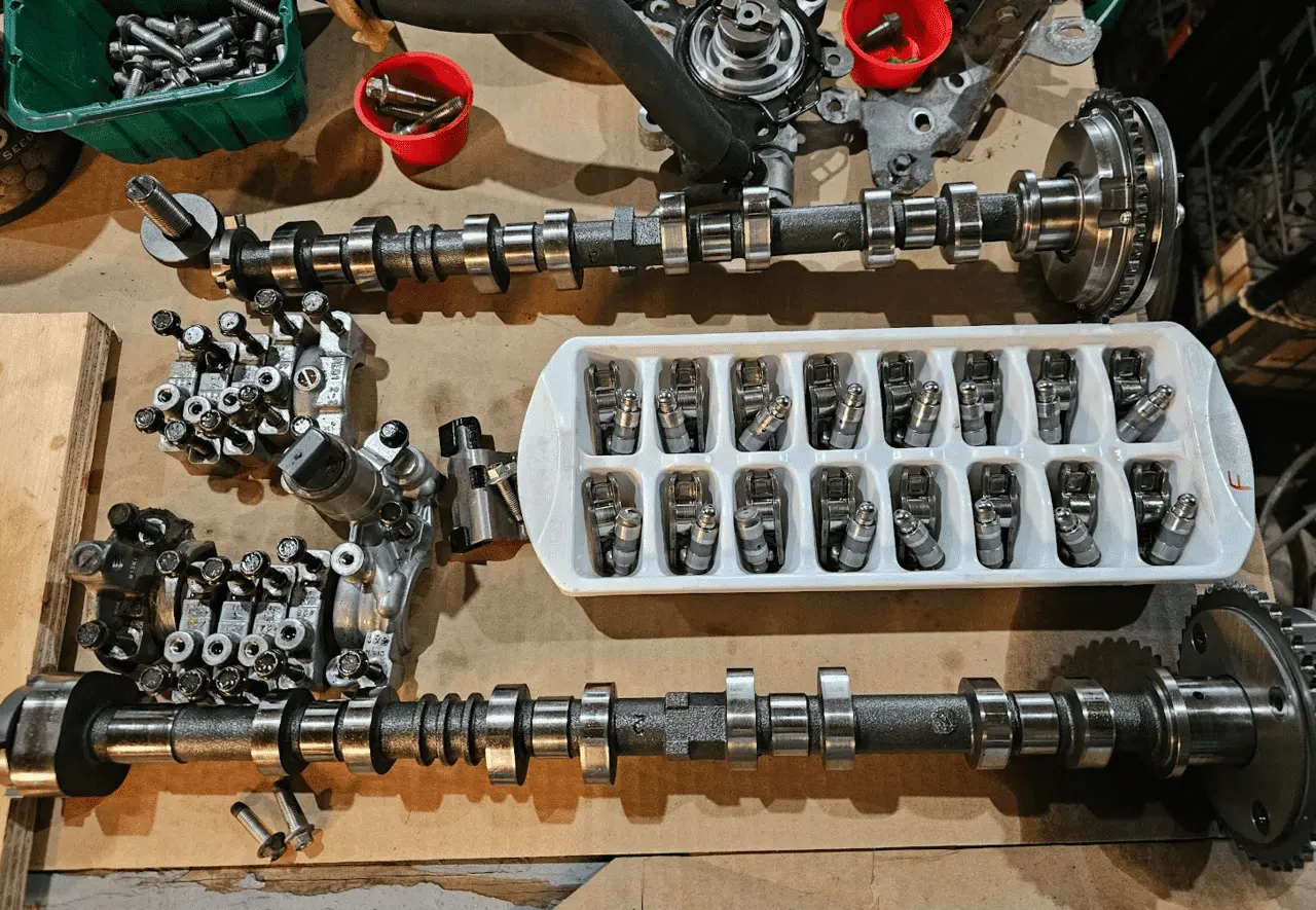

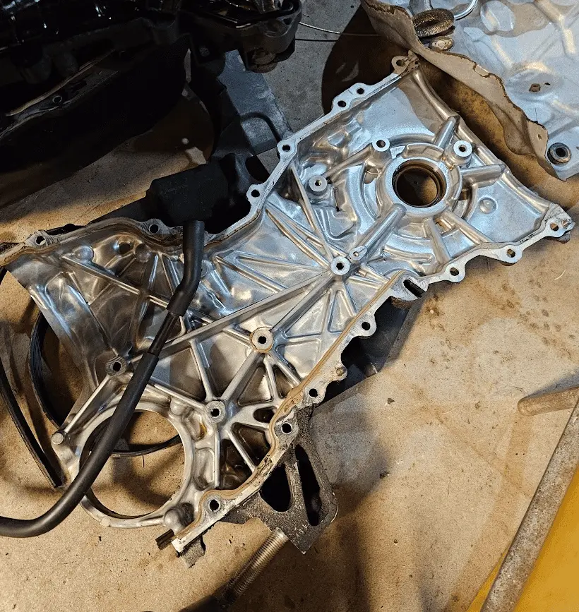

I don't have a ton of pictures of the disassembly process, suffice it to say it's not something I'd want to do for fun more than a few times. Not much room in there, and there are a ton of parts to be aware of, things to keep track of, and small parts that are easy to break if you don't know what you're doing. The timing chain cover sure wasn't fun, and the exhaust header in back took some creative socket extensions to get all the bolts off. After about 7 hours though, the head came off.

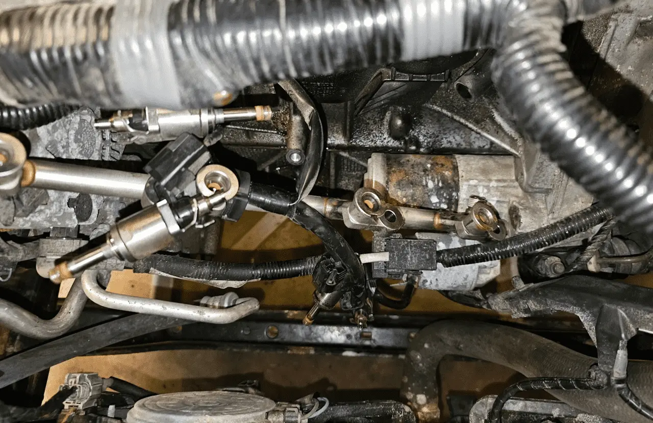

Fuel rail and injectors
Don't mix up the cam bolts and lifters!

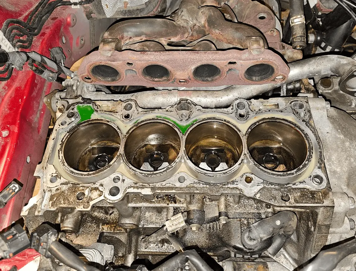

Pretty sure that green stuff shouldn't be there

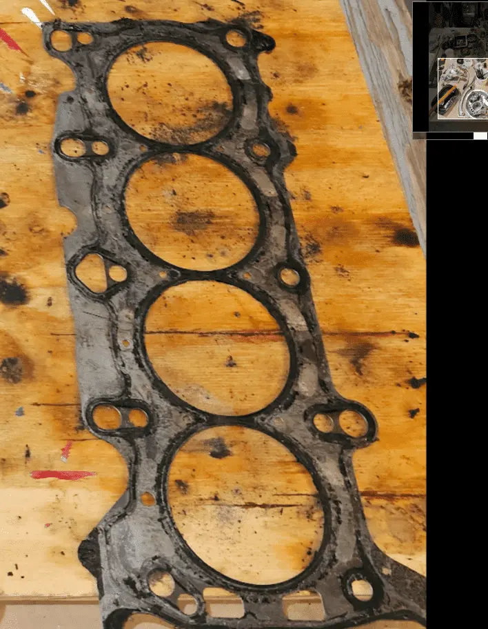

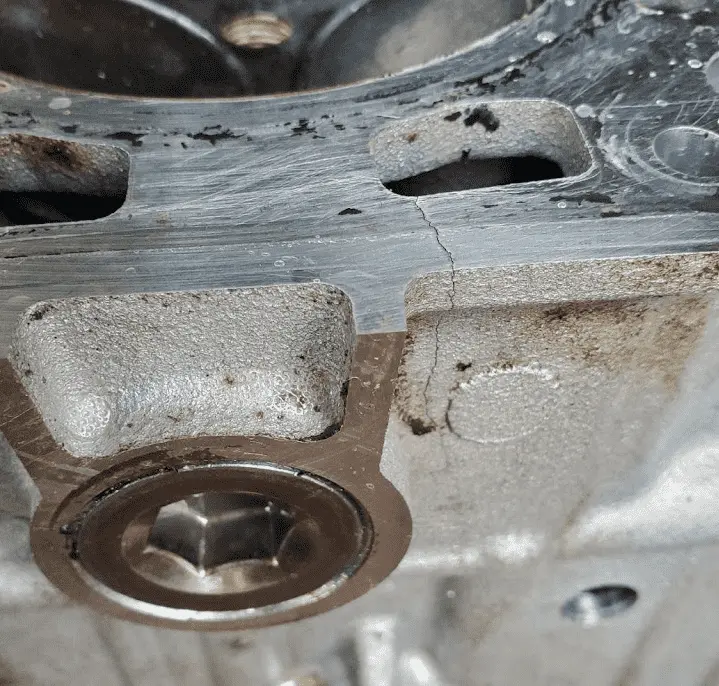

Once the head came off we quickly looked at the gasket to see if we could find the smoking gun. Nada, couldn't see anything obvious.

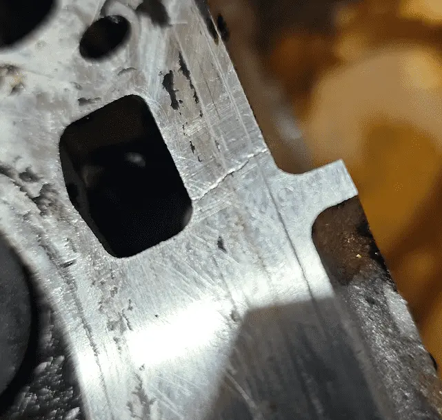

However, it turns out we didn't have to look very far to find the issue. The dreaded cracked head. From what I've been able to dig up it seems like this is the spot where they tend to fail, between the coolant passage and area where the timing chain cover sits. This explains why I was losing coolant into the oil so quickly.

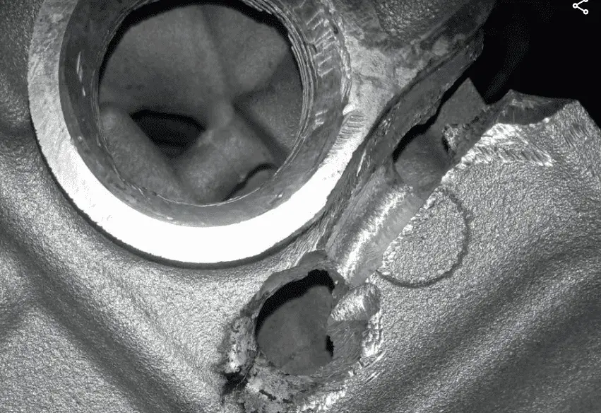

At this point we broke for beers and discussed options. The good news is it wasn't the block, but it never crossed my mind that something like this could be fixed. Imagine my surprised when my wife's uncle throws out "I'll call Bob the Cylinder Head Guy on Monday and see what he thinks". Wait.....you mean see if he can get a new one and install it? "No, he might be able to repair that". So apparently Bob's been around the block a few times. With a tentative plan of action, we broke for the day.
Monday comes and goes and I get a text from the Uncle. "So Bob took a look and his theory is that your thermostat failed, causing the engine to overheat. Once that happened the difference in expansion rates between the metal plug and the thin portion of the casting there caused it to crack. He'll pull the valves and that plug, weld the crack and plug hole shut, grind it, tank it, clean the valves and touch up the seats, then reinstall everything." According to Bob he's never seen a steel plug that size in a section that thin. With no other options on the table I tell them to go ahead.

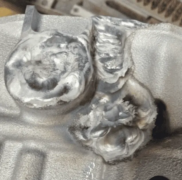

As of this weekend, this is where we stand. The welding is done, and the head is waiting for cleanup grinding and machining. According to Bob I got lucky there's an oil passage in there and he was able to grind out the crack (which went a lot deeper than we though) and reweld it without affecting that passage. While Bob was working his magic I went over and we did all the necessary cleanup on the parts that came out to prep them for going back in, including washing and relubing everything and cleaning all the seal faces. We're waiting on additional parts as we speak, and hope to start putting her back together next weekend.

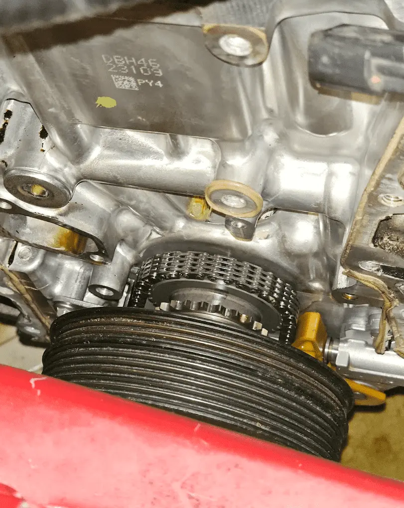

  • Torquing the crankshaft pulley is easiest with the oil pan still off. You can use a block of oak or other hardwood to stop the crankshaft from rotating by sticking it in between the number 4 connecting rod and the block.

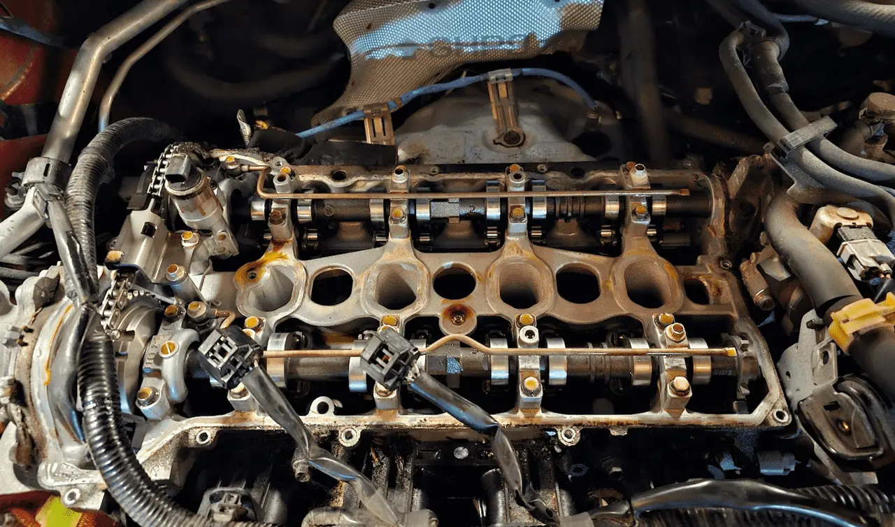

The cause of the rattle was immediately apparent. Somehow, after running smoothly for almost 15 minutes, it had spit a rocker arm out. On the way, it had made a nice gouge in the lifter bore. Not good, but we thought maybe if we could get the lifter out we could smooth that out and give it another try.
That plan lasted about 2 minutes. When we tried to pull the lifter it suddenly disappeared.....out the bottom of the casting and into the valve cover area. We could also see metal pieces down there. When the rocker arm had come out, it had mashed the lifter down and punched right through the area where the lifter oil passage sits.
1689784330492-png.249356
Shouldn't be able to see oil through that hole
1689784351020-png.249357
Bob the cylinder head guy can work wonders, but there was no repairing that. The UiL was having a mild breakdown, which for him is saying something. Never in his 30 years had he seen something like this, where it ran fine for almost 15 minutes then catastrophically failed. Our best guess is something got flushed into the lifter pressurization hole and plugged it, causing the lifter to leak down and allowing space for the rocker arm to pop out. The world will never know unfortunately.
