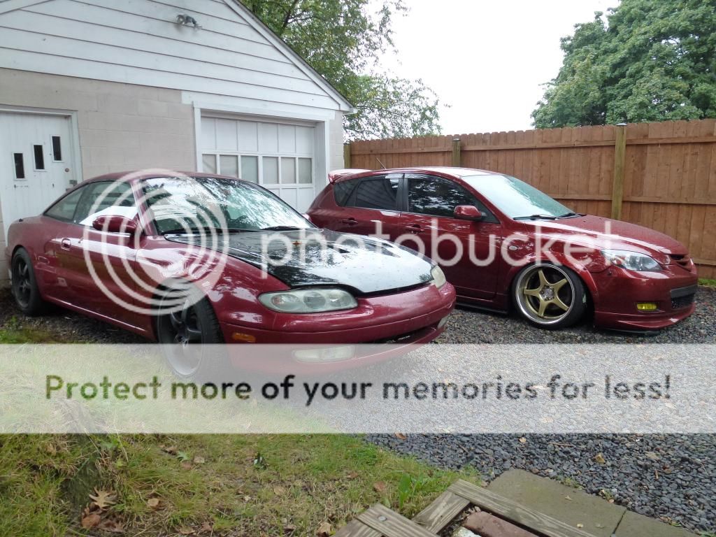

Pushed it out to put a new clutch/flywheel in my mazda3 and then my buddy needed a garage to swap motors in his mazdaspeed3 so she was pushed out again.
Shot this yesterday.
I have a thing for redheads. Even if the redhead women don't stay around long I still have the ones in my driveway to keep me happy.
