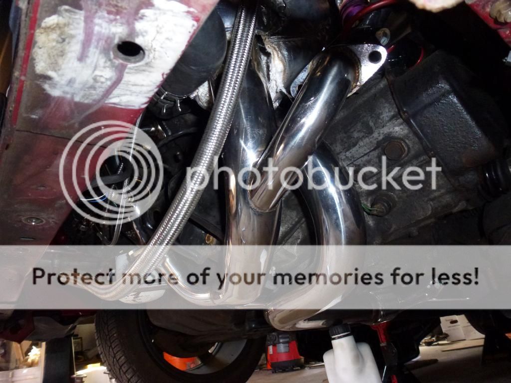

So I am going to need an exhaust and I want to go with 3" pipes. I am toying with the idea of just doing a straight through system with blast pipes on the end like you'd see on a drift car. Not sticking out far or at a crazy angle but it would be loud and crazy sounding.
Similar to this kind of setup.
i really like the looks of that, no doubt you will be loud with that and an open wastegate but it shouldnt be too bad since the turbo muffles your sound. i have a 4-1 header, sls catless 2.5 inch midpipe and 3 inch non resonated underaxle exhaust and its pretty damn loud, but its tolerable. i could imagine itll be ok with a turbo in there.
I could always add a resonator later on if it gets too loud. I removed the radio/speakers anyway and plan on pulling the interior out too so it will be better than the radio. You're absolutely right about the turbo quieting it down some. My buddy's msp has a 3" exhaust and it was loud but not crazy.
I am going to start with a VTA wastegate and if I don't like it I will get the dump pipe hooked up to the downpipe. Going to see how I like it open first.
This looks like what I need. I'll have to measure tomorrow and make sure there is room.

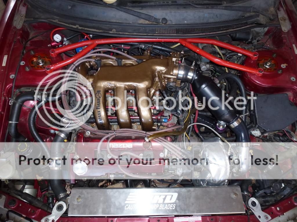

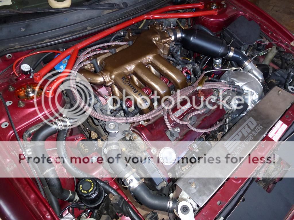

Got some stuff mounted up today. Waiting on more parts before I can get anything else done.
Still need to mount the wastegate. Got a dump pipe on the way.
