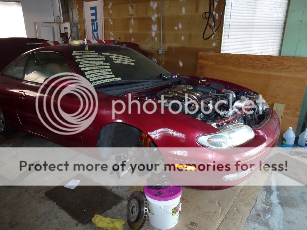

Today I put the subframes/x-members back on and finished the water to air system plumbing. Once I wire up the pump I will be able to fill it, check for leaks, and see how it flows. After that the list is somewhat short.
Get the BOV flange welded to the w2a intercooler, hook up the turbo oil feed line, get a downpipe fabricated with a wideband O2 flange on it, wire up supertones and high beams so I can pass inspection, install a new accessory belt, drain and refill oil, gas, and coolant, connect the battery and make sure the gauges are working, then fire her up.
After I know she runs I need to lengthen the clutch slave cylinder rod for better clutch action and get an exhaust fabricated. Then inspection and registration and I can start stretching her legs.
The list. LOL

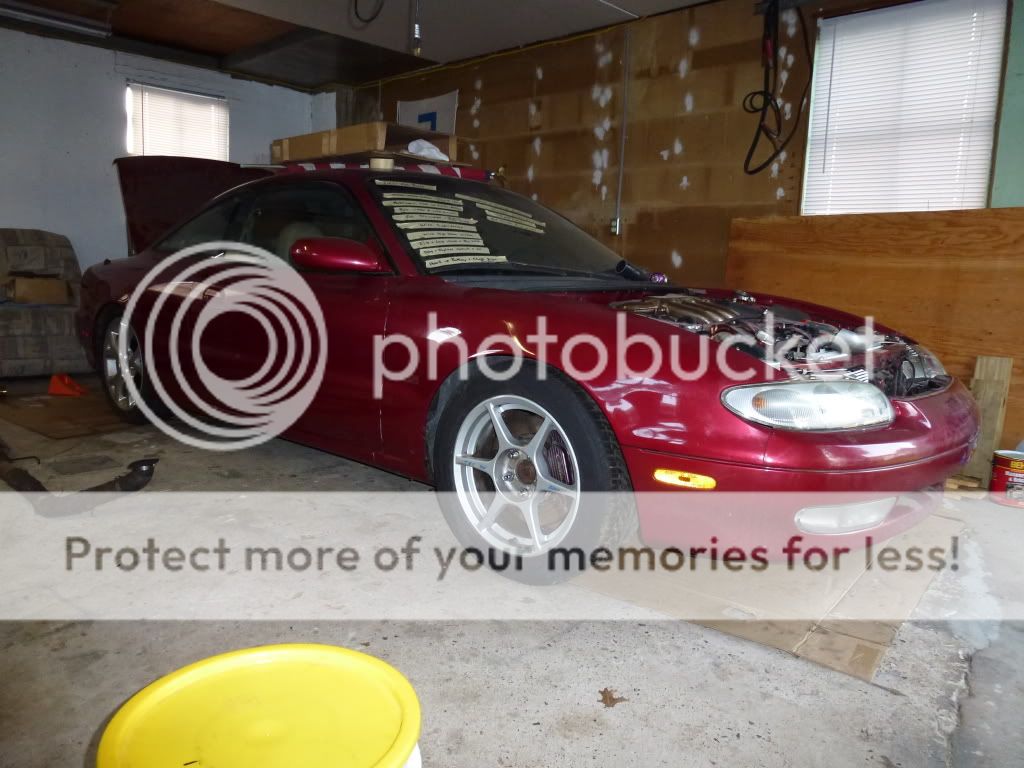

Got the brake bolts after my previous post and now I have the front end back together and the car on the ground. It will be back up again shortly but it's nice to see it sitting on its own instead of on stands.

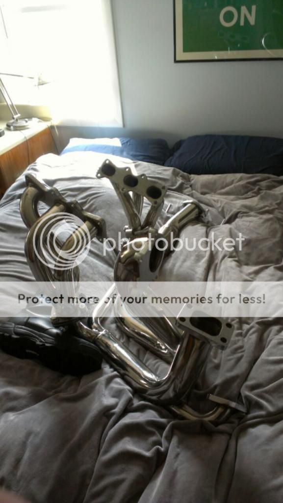

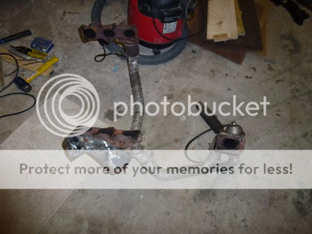

So In the process of swapping over from a bad turbo to a good turbo I had to make a few changes due to different flanges. I ended up just buying a whole set of hot pipes from an ebay seller with a downpipe included that would fit the new turbo. They arrived today and my brother and I spent 4 hours removing the old parts and installing the new ones.
The old pipes removed.

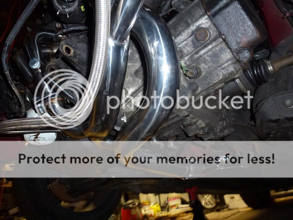

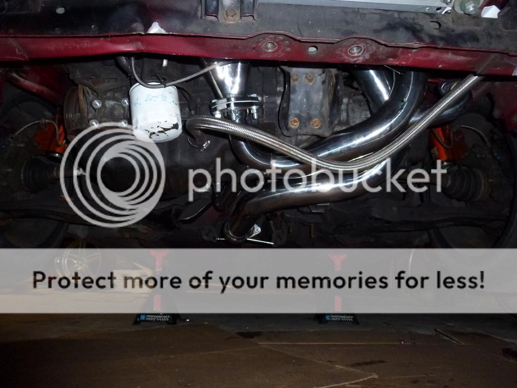

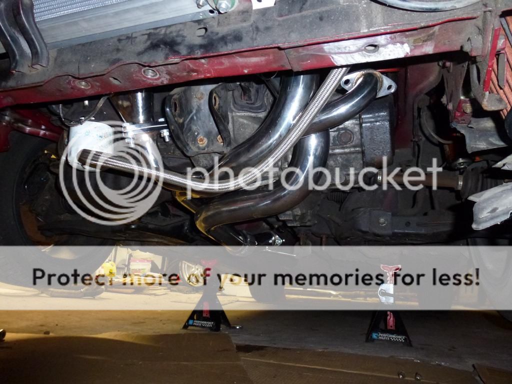

New ones in. Didn't take any in progress shots because space is too tight. Had to remove the intake manifold to reach the rear exhaust manifold bolts. Also removed the entire radiator for better front access. Made things much easier.
Under car shot. They are a little low but I think they will be fine. The angle of this picture makes them look lower than they are. The downpipe is the lowest part and I'll have to see if the crossmember fits with the new pipes. Probably going to have to go with a tubular crossmember setup instead.
Thanks man! They went on very nicely and they should flow a million times better than the old ones. They do contact the trans in a few places but I think I am going to leave them as is until I start noticing some wear on them.

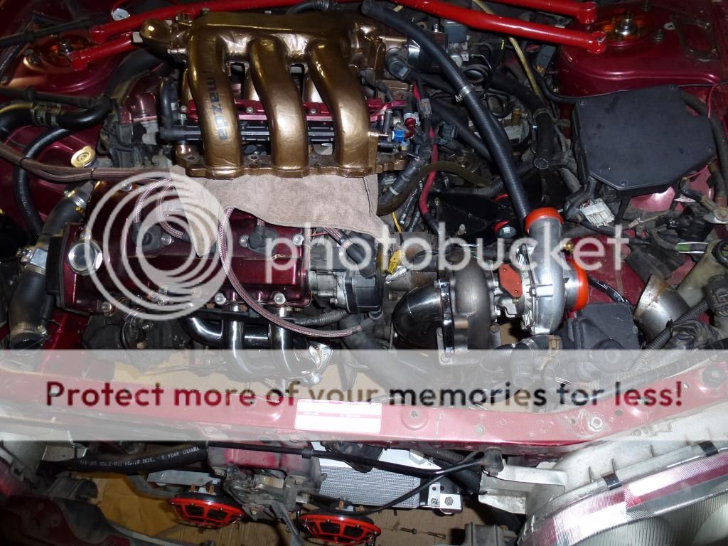

Here's a more recent picture. Crappy cell shot but you get the idea. Painted the intercooler that day so it's not on in the picture. The turbo is fully mounted and has an oil line hooked up now.
Once I get the intercooler setup filled and tested I will be a lot closer to getting this thing started. I ordered a bunch of stuff within the past few days too.
new spark plugs-1 step colder than stock
new exhaust hangers- I might have cut the old ones off when removing the old exhaust
a shorter accessory belt-deleted the AC system
a new rear o2 sensor because the other one is frozen into the old turbo pipes
a wastegate dump pipe
a slim radiator fan- pusher style because I need the space for the front turbo manifold
