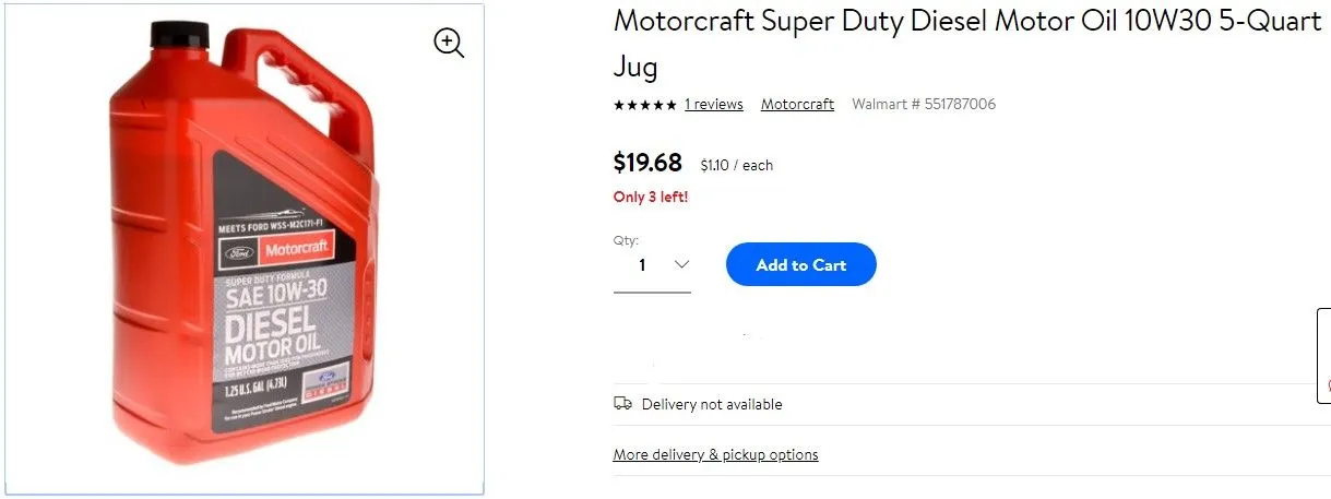

Ohh beat on it? I can do that. I wish I had remembered when I bought oil... I'll just drain it back into the bottle lol.
Like this stuff? I'm not sure what "only diesel" means

You can put diesel fuel in your oil...
(it's a solvent.)
The link posted about putting straight Diesel fuel into the crankcase to wash it out but he thought that was too much..
He just added some diesel fuel to his regular car oil...
Ohhhh I thought it said he bought diesel only oil I know you can put diesel fuel in but he said only about .5 quart of that.
"We removed the old oil and put in oil designed for diesel engines only (not oil designed for diesel or petrol) and about 500ml of diesel mixed into the crankcase."
"Another 50 km's like that and we changed to 10W 30W normal petrol oil with new filter."
Okay, he did both...
Diesel engine oil and 1/2 liter of diesel fuel...
"and about 500ml of diesel"
He most likely meant diesel fuel.
