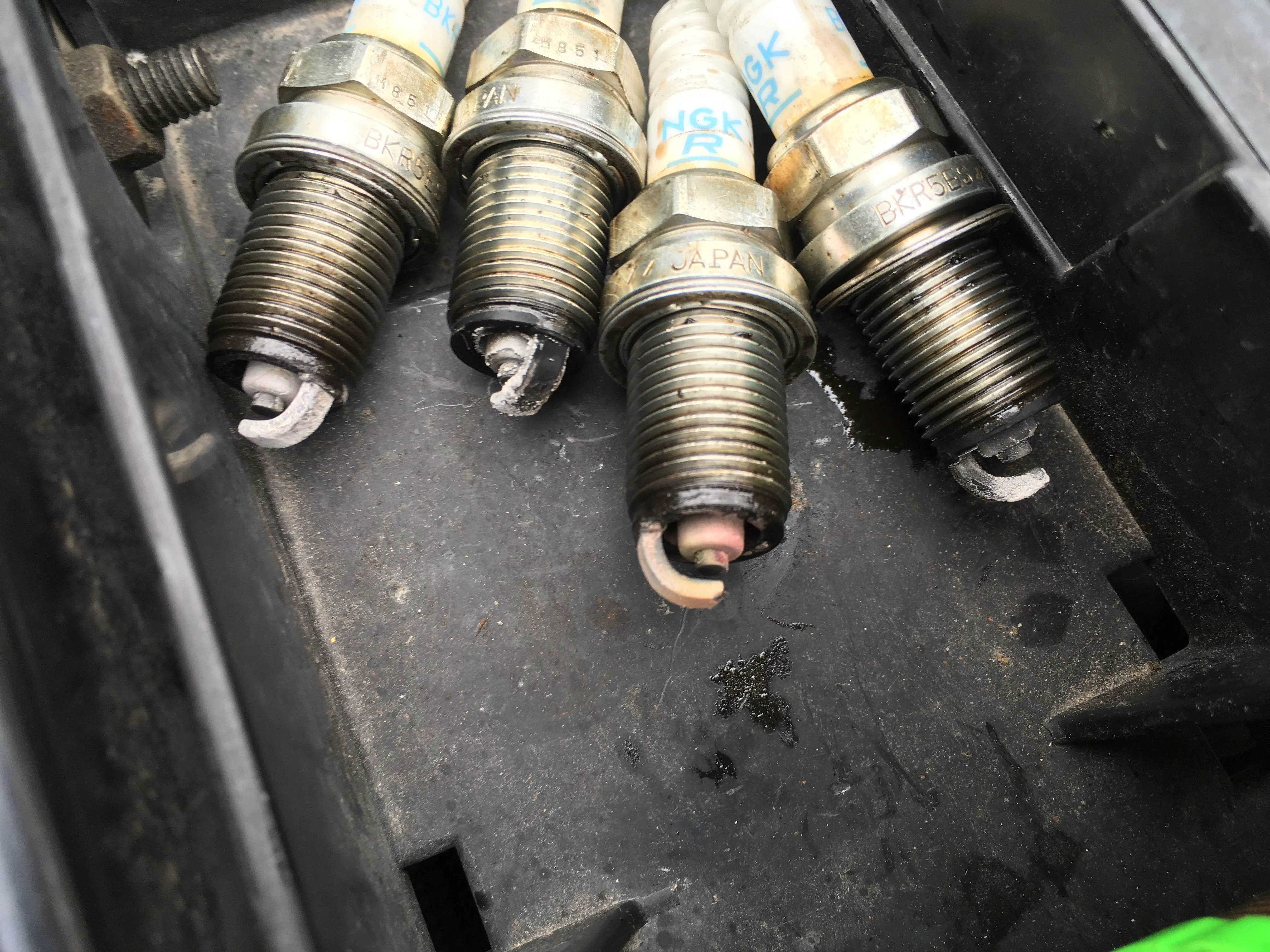

I drove around for about 25 minutes and after the first minute or so it stopped smoking. I pulled over to check everything over and the upper cat was dry and the only thing smoking was the rear caliper that was seized up. Once I got back home I pulled the plugs and the two cylinders that were just wet were dry and the two that had a puddle on them just had a drop of oil. The hottest my scanner said it got was 209 F. What's normal operating temp? When should the fan kick on?

Oh heres a picture of the spark plugs, dry and white

Now is the time to do your smoke test again.
Everything seems pretty dried out.
Check for oil in the morning then fire it up.

I'll pull the plugs again tomorrow and see what I find.
