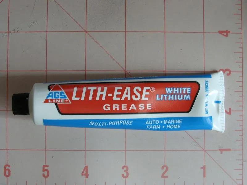

I have taken driver side apart. I even unscrewed motor unit and took it apart, add more grease to two actuators, but no help at all.
On the passenger side, even though the mirror is moving when we tap it but it is not shaking at freeway speed.
I will take a look closer to both side to see what's difference.
I used this tube.
I apply grease inside 2 actuators, the hole in mirror panel and motor module.
I am afraid that the vibrate is whole mirror, not just removable mirror part.
What kind of grease did you use?
Where exactly did you put it?

Okay, so I put die-electric grease or any other thick grease I can find in the female sockets of the rear side of the glass. One last question, do you just pull on the glass mirror and pry it off the tiny arms in the actuator?

SportOwner fixed his vibrating mirror by pulling the glass part off the mirror housing assembly and packed the sockets behind it with grease. This way the ball sockets that snap into the glass assembly are nicely packed and cushioned by thick grease.
