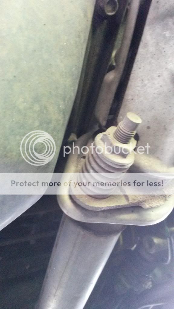

Any suggestions? Does this mount look worn and should this exhaust be replaced? Car seems like its mechanically sound, but just taking the precautions.
how the heck can the underpan look THAT good and the exhaust look THTA bad lol. im pretty sure thats fine, but i wouldnt try to take it apart without replacment nuts ect on hand. maybe just leave it until you get the desire to upgrade to an aftermarket exhaust.
the mount looks fantastic, but that isnt the one that commonly fails. if you can rock the motor, chances are the rear mount and front mount are broken. New exhaust? get new mounts at the same time. solid side mounts and front and maybe just inserts for the rear on a brand new oem.. the 70 and higher dm rear mount SUCKS.. turns my windshield into a great big speaker lol.
Yeah man the car has only 32.5k miles but it sat outside with only a car cover on during bad weather. I am planning on replacing exhaust because I hate all that rust, although I like the OEM exhaust tip with mazdaspeed logo on tip! lol But I want to upgrade to an exhaust with similar sound as stock.
And yes I check my rear mount and from what I could see it did look like it was more worn. The mount under the battery looks pretty good still too. Ill be posting some more pics to get your guys take on the condition and what should be replaced, before things wear out.

This is my front mount. Going to need to be replaced soon! Front and rear are recommended to go with OEM and Poly inserts correct?
Yeaaaa that's phuced lol. You could do just the front one for now easily though. Rear one is a realy b****.
Solid sides and front if you can afford. For the rear it depends what you want. Solid.mount will drive and shift wicked but be noisy and rattly. I only have side inserts but I might go solid soon and a softer rear mount.

I would like to go for little noisy and rattling as possible, I know thats the nature of the msp, so should I just go with new OEM front and then inserts? My msp is a DD and I dont use on track btw.
ps, for some reason i thought you were looking at the front of the car.. my bad.. you could just take that axle back to an exhaust shop and have a few flange/pipe end welded on. if you get corksport 2.5 it goes from the Jpipe back i believe. lots of people run the pipe with msp muffler to keep the noise down and keep a performance boost from the bigger exhaust.
i just cut the cats out and replaced with pipe but ill be going cs fairly shortly. cant beat the quality for the price.
And got it I might just do that and keep the MSP axel back since I would like to see stock look.
