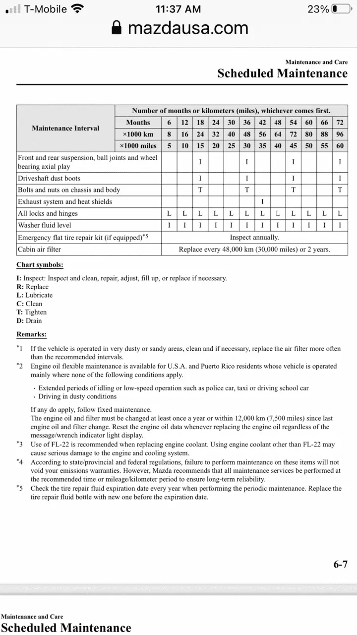

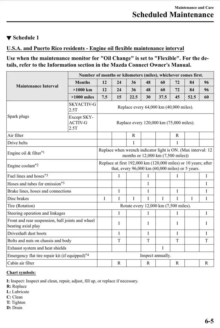

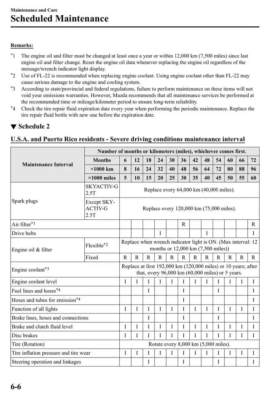

This’s what the 2023 Mazda CX-5 owner’s manual says:
Based on mostly highway driving by the OP, it’s hard to be qualified as “severe driving conditions”. The best is to follow Mazda’s recommendation and use “Flexible” OCI which can be used in normal and severe driving conditions. And the maximum OCI by “Flexible” is 12 months or 7,500 miles.
IMO any current synthetic oils can handle 7,500 miles of service under most driving conditions. There’re too many UOA reports can support that. Considering Toyota has been using 10,000-mile OCI under any driving conditions with a super-thin 0W-16 oil for many years you should feel Mazda’s oil change interval at 7,500 miles is pretty conservative.
I wouldn't go 12 months on an oil change, maybe 6 months max, definitely wouldn't do 10k miles.

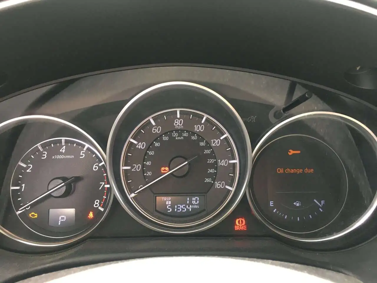

did oil change yesterday, ez. glad not to have to mess with cartridge/element mess like on the rav4 but where do you reset the wrench after changing oil? went thru manual and all the dang menus on wheel and infotainment and there was nothing that let me reset maintenance interval.

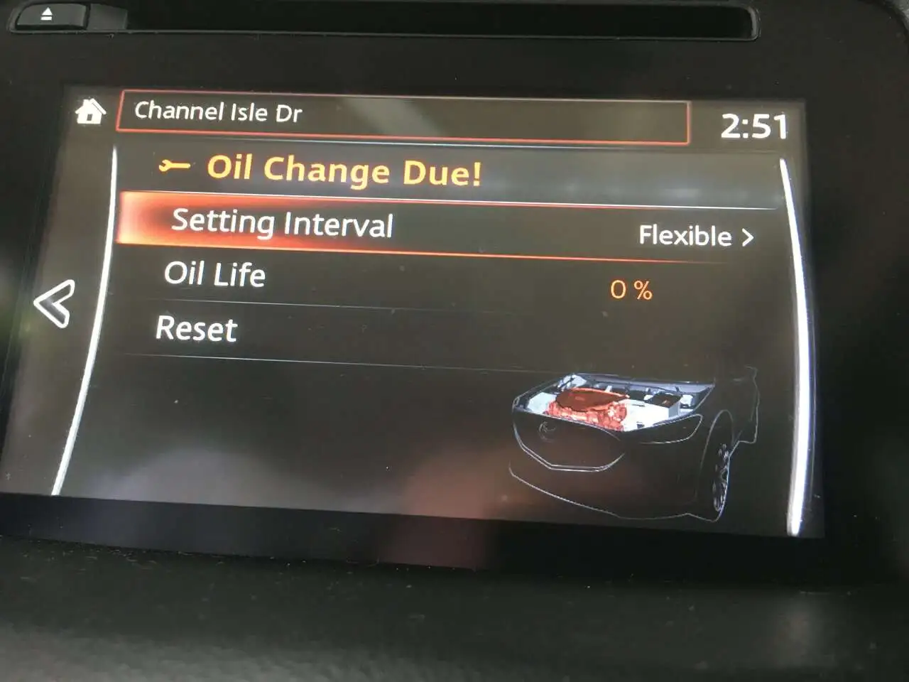

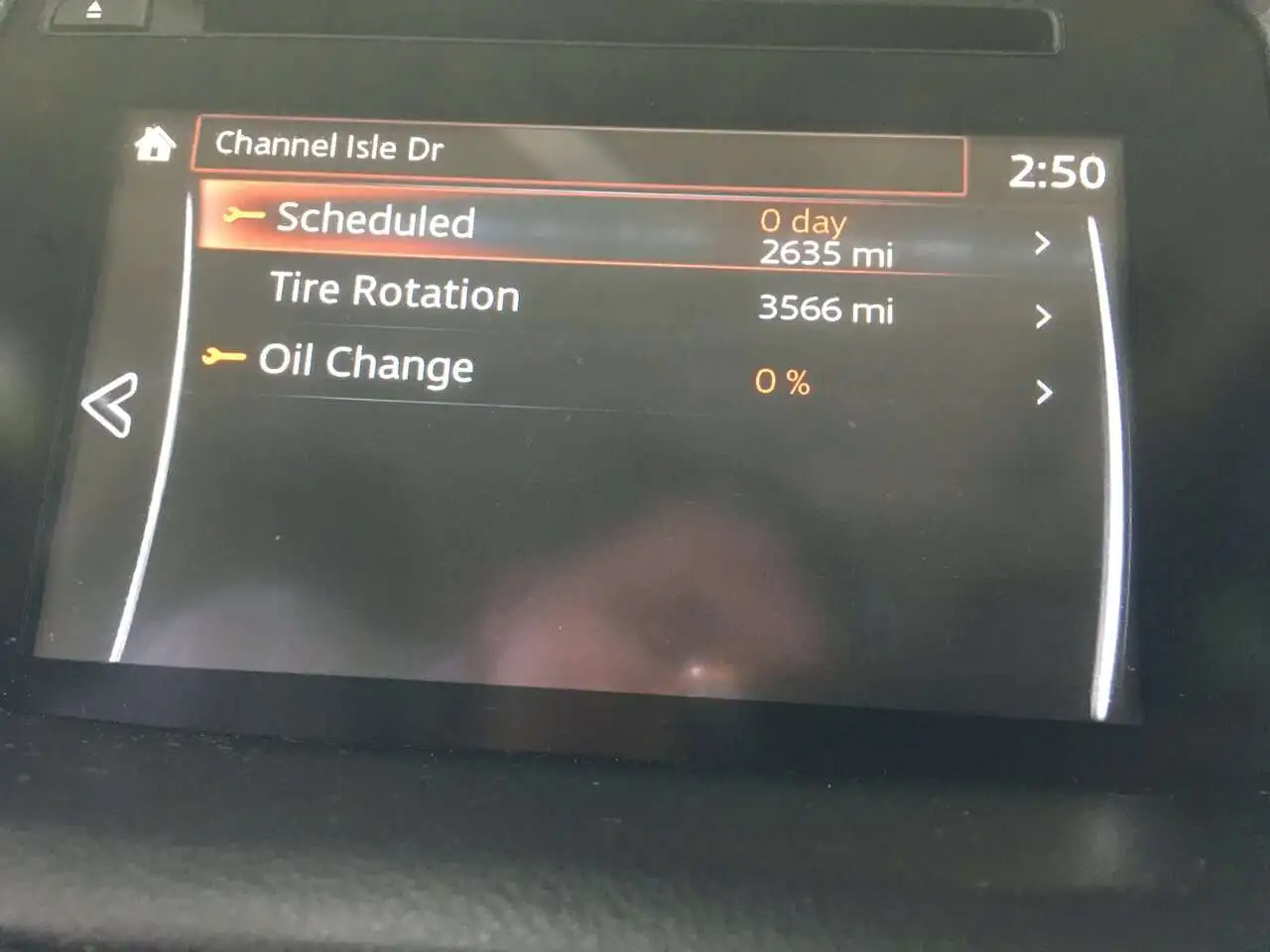

thanks....now tell me why vehicle maintenance settings is grayed out and won't scroll there. maintenance details has no serviceable settings. also doesn't show miles or date, just dashes. next service shows 2647 miles but date is dashes. Found this yesterday but dunno why it won't allow me to reset it.
does it only allow this after wrench comes on? by then i'll have 2650 miles on new oil.
Alrighty then....figured it out......had to put gauge display on next service and then went into information on infotainment and the maintenance settings selection was lit where i could put next service date on automatic and reset service interval and now shows next service in 7500 miles.

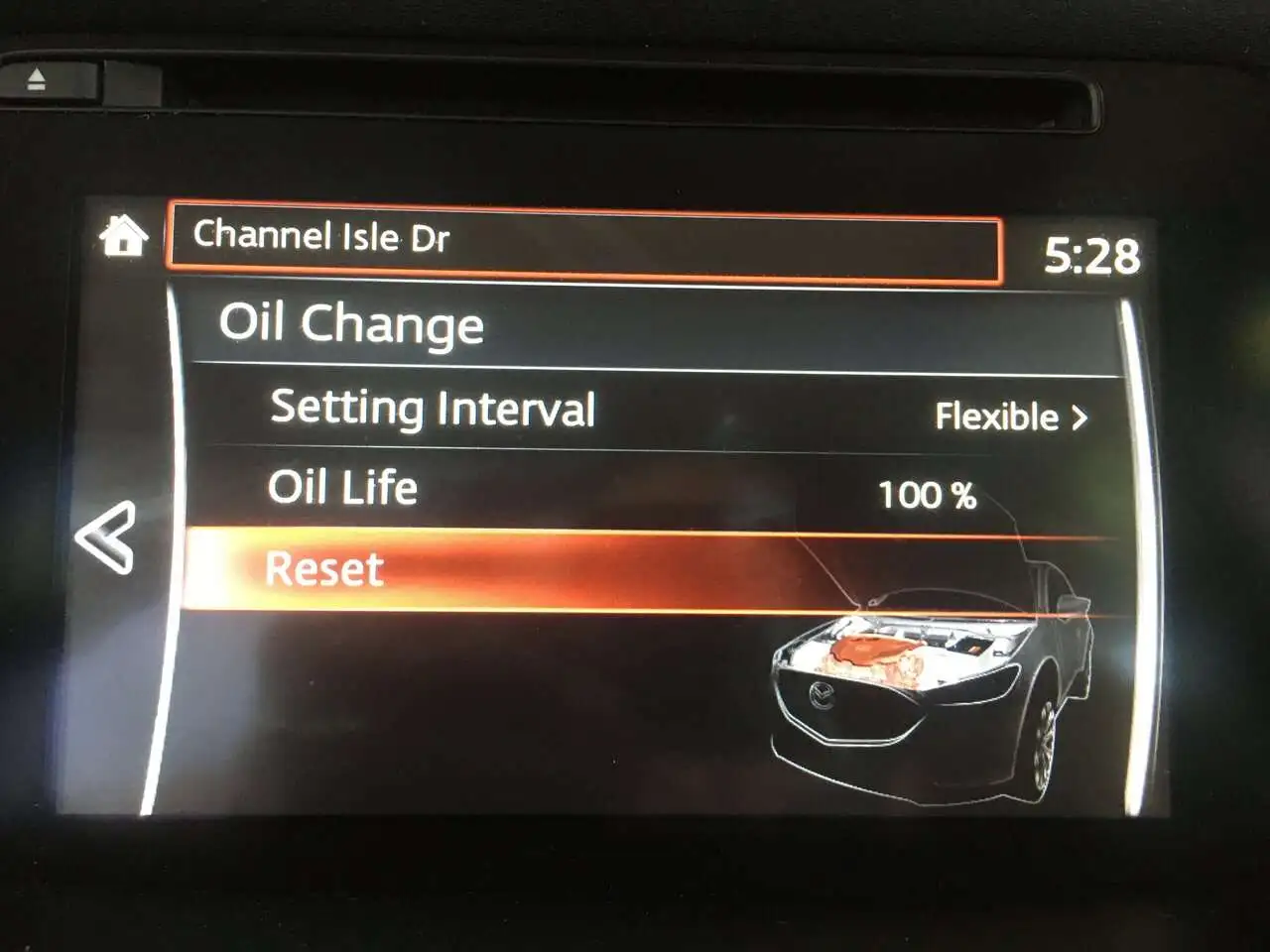

On my 2016 CX-5 it’s easy. Just go to infotainment screen to select Maintenance Monitor and hit the “Reset” under “Oil Change” menu. The oil life will be changed to 100% from 0%.
The only thing is you can only do the Reset with the ignition on without engine running.
