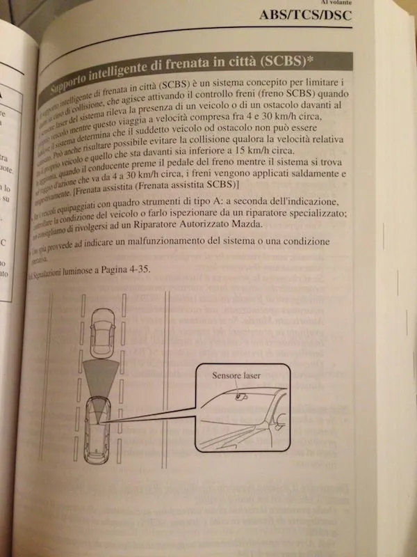

The tech package has that huge City Brake sensor on the top. From the picture she sent me, that's where it seem to came from.

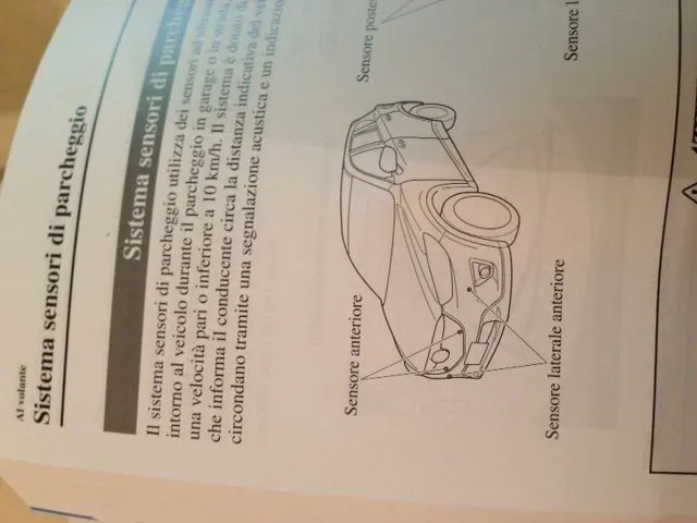

The scbs sensors are in the front grill in the bottom left & right of the honeycomb grill.
I don't think so. In the front grill there should be the frontal parking sensors. I'll take a look on my manual.
Oh I hope that's not the SCBS sensor's fault - bad news for a lot of us then. But it certainly looks like it.
the front parking sensors are in the bumper/fender not the grill

Here I am! The manual is in italian, but pictures are... international!
SCBS sensor position
In the grill there are also two frontal parking sensors, frontal lateral ones are in the bumper.
I'm sorry if I'm a little bit OT.
Well i now know were the laser is, good work.
