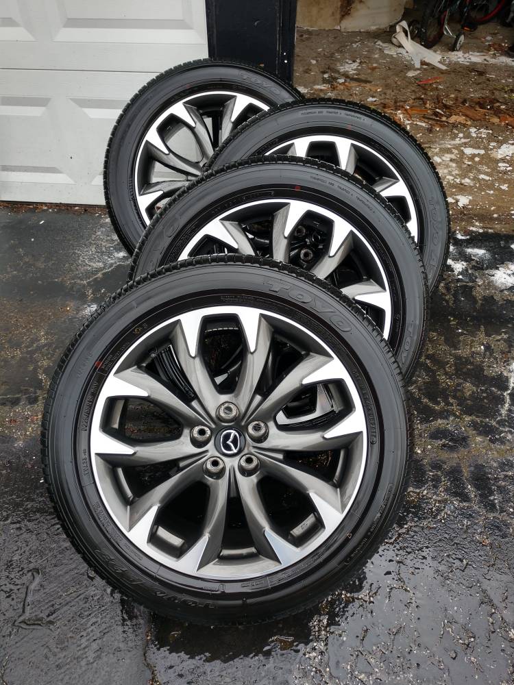

Another advantage of dedicated Winter tires that never occurred to me until today: being able to thouroughly wash them every change...
Looks great! I do the same thing when I rotate the wheels. Not as convenient of course and it makes it a 4 beer operation.
