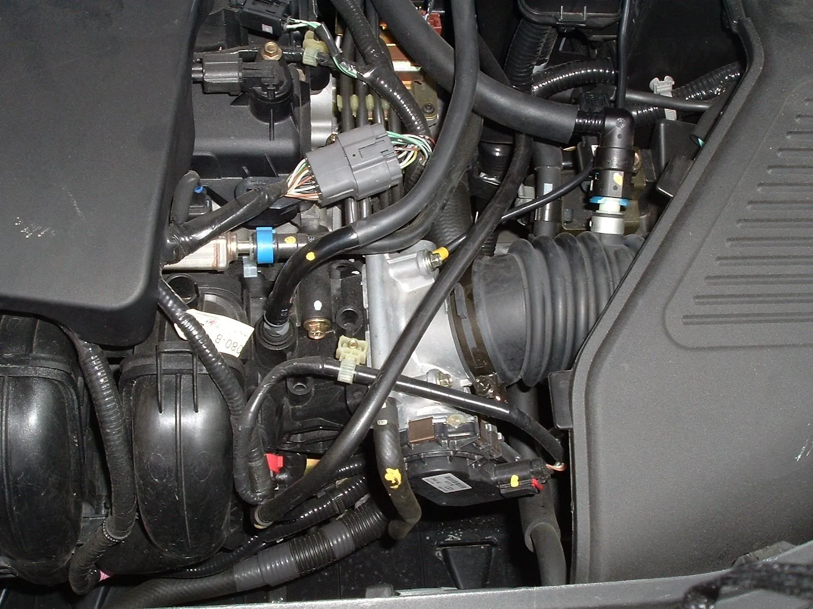

Here's a pic from my car... it's a 2.0l GS. Doesn't quite look like the pic you posted, but I could be wrong?

lol... now that I took a good look at your pic, I can see the cable. And it definately isn't on mine.
Ya yours is electronic. Thanks for the pic joe!

Crossbow: the picture you posted, is it of your car and if so where did you get it? That is for sure a TB cable.
Joe: where was your car bought? That is for sure a electronic TB
If they are infact both North Americian 2.0L and both on the 4dr base model... something is weird.

Bought it here in canada. It's a 2.0l 4-door sedan, GS trim.
