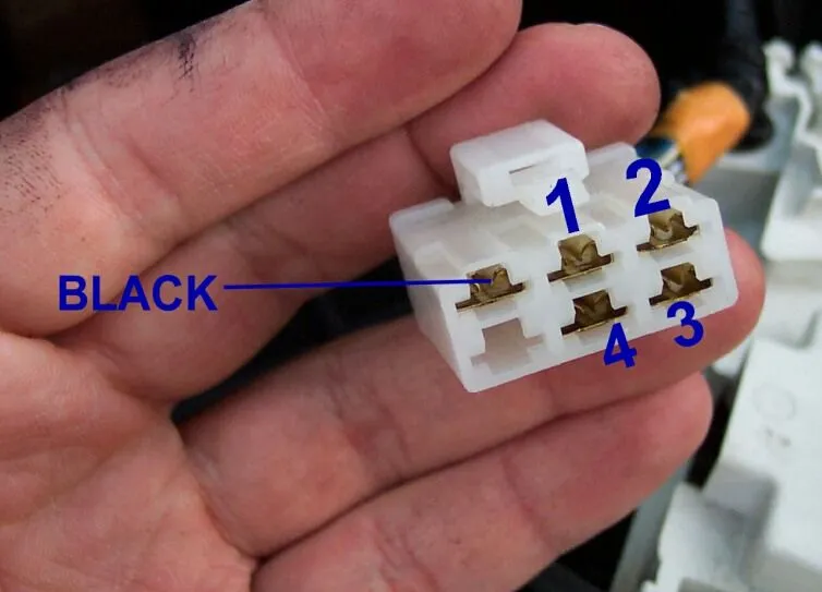

Thanks for the INTEL. I have to turn to 4 and then slowly turn to 3 and then wiggle/turn for 2. Only 1 and 4 are trouble-free.
Edit: I Just Added A Pic With The Pinout Showing Which Wire Controls Which Speed... This May Help You Isolate The Problem Wire...

Just a quick question:
am I removing wires from the white adapter and connecting them directly into the black part (not using the white adapter part at all) ?
anyone have the problem still after attempting this?
thanks
Sorry, they moved this to the how-to section and I didn't see it for a while.... To answer your question, YES, you'll still be using the white plastick block that holds the wires in place. Let us know how it goes, k?
thanks Weborific, i did what you said and also i open the rotated switch to clean it and put new greasse. That work very good!!!!!!
