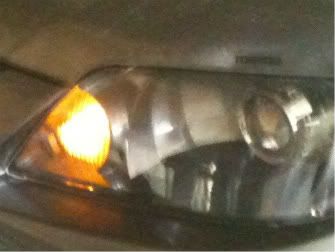

morimoto mini d2s with cut down gatling gun 2.0 shrouds, the rest painted titanium to match the car
Finally a good shot of my retrofit.
Morimoto Mini H1
Mini Gatling shrouds painted with black chrome paint
OEM Canadian black housings
Yellow high beams (for now - either going HIR or LED in the future)
