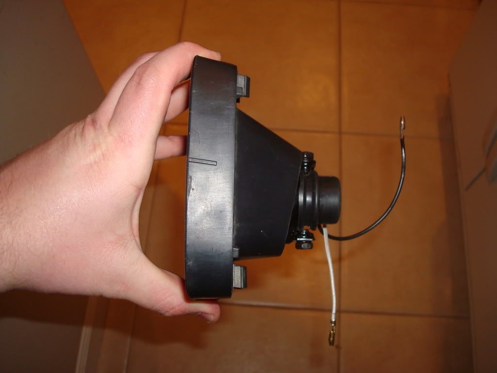

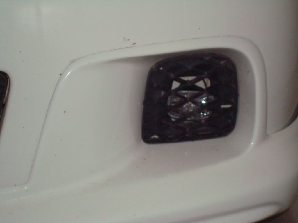

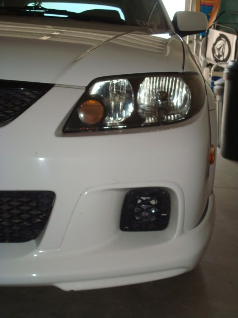

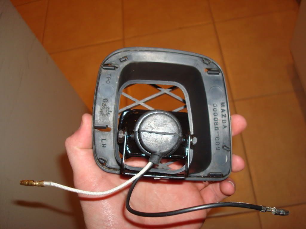

if you're just wanting some sort of light down there, i DID get the $18 walmart lights to fit
Never did wire them up though
edit: After looking at those pics again, i bet you could get those fog lights that TRS is selling for $20 a pair to fit nicely on the fog delete

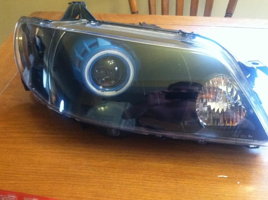

Someone please start a general projector thread! I'll take pics of my retro rebuild once my canadian headlights get here.
