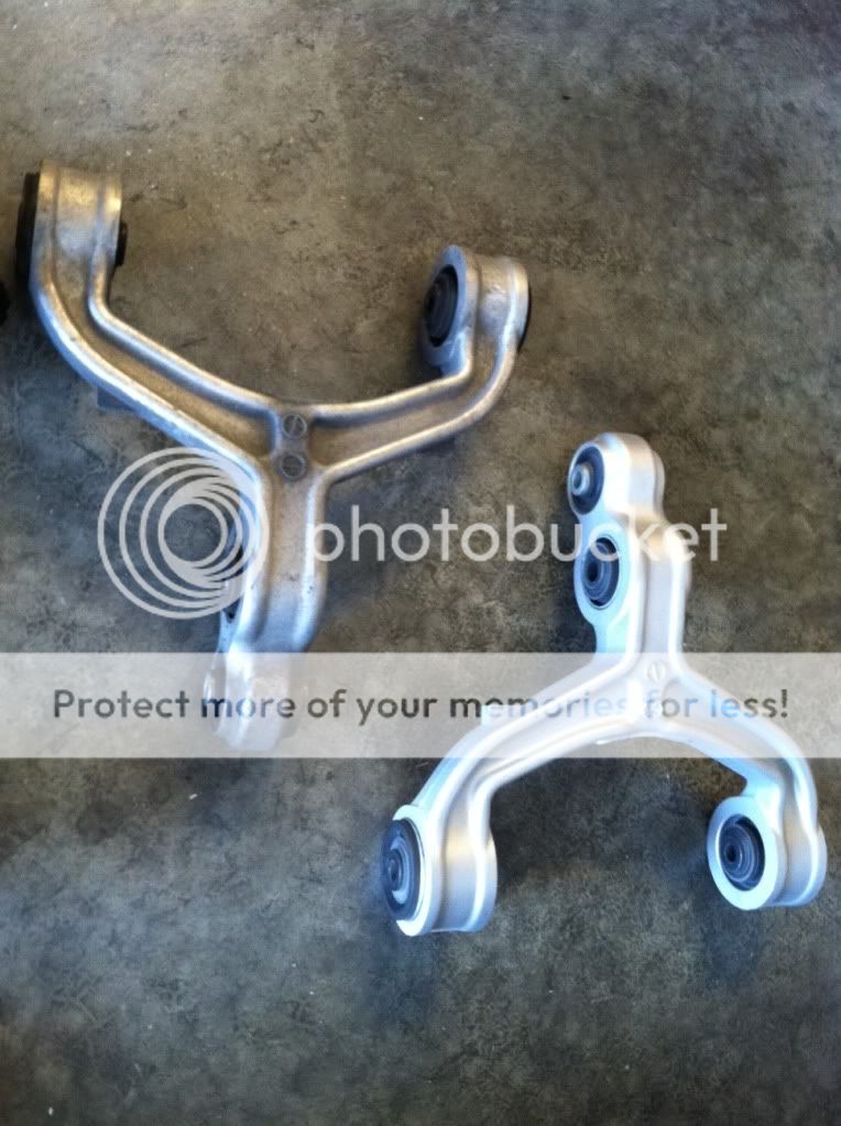

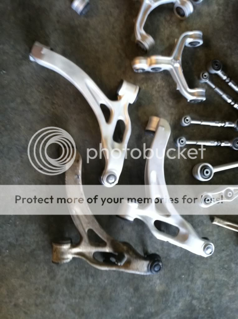

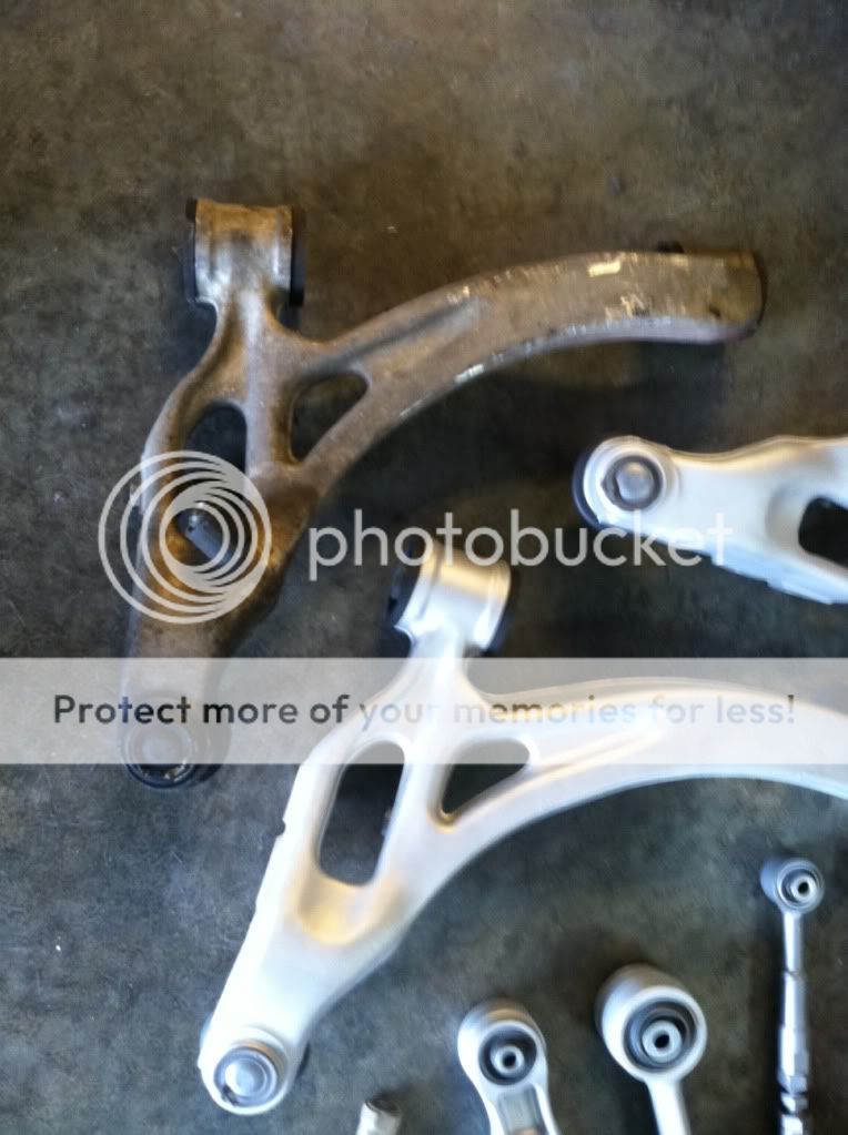

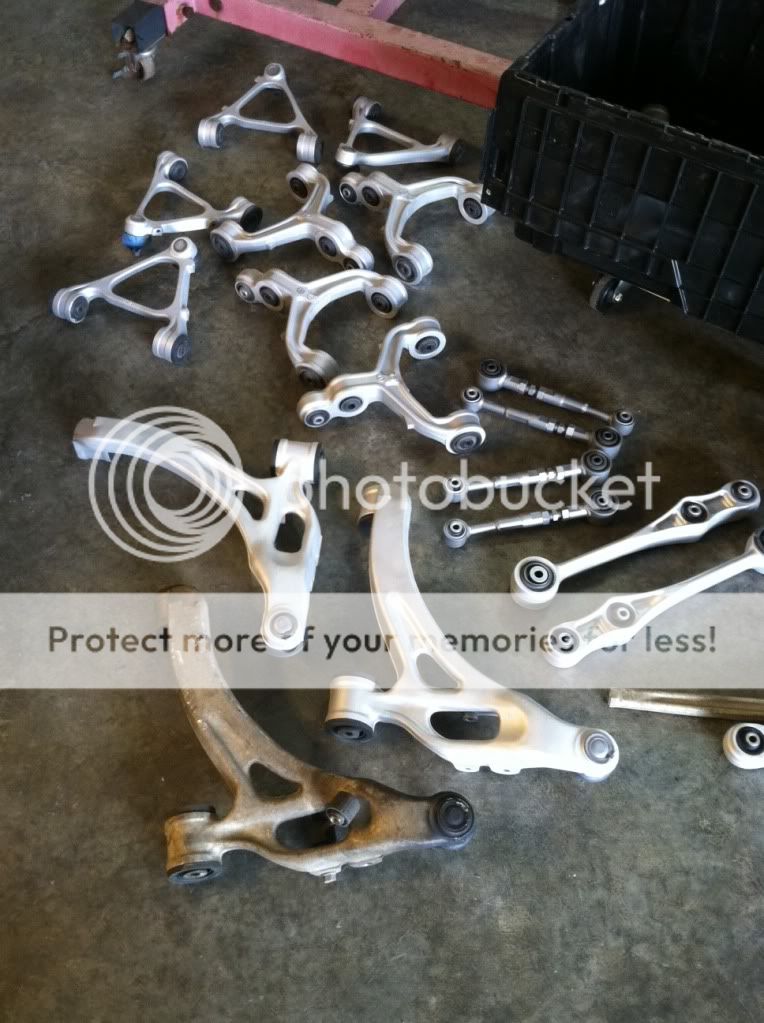

Friday, I went over to my long time friend, Bryan at www.BNRSupercars.com to use his sand blast to clean up some suspension parts.

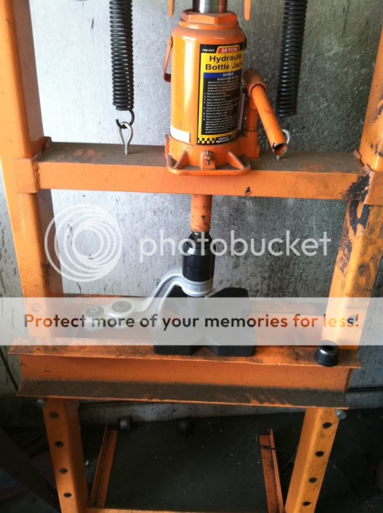

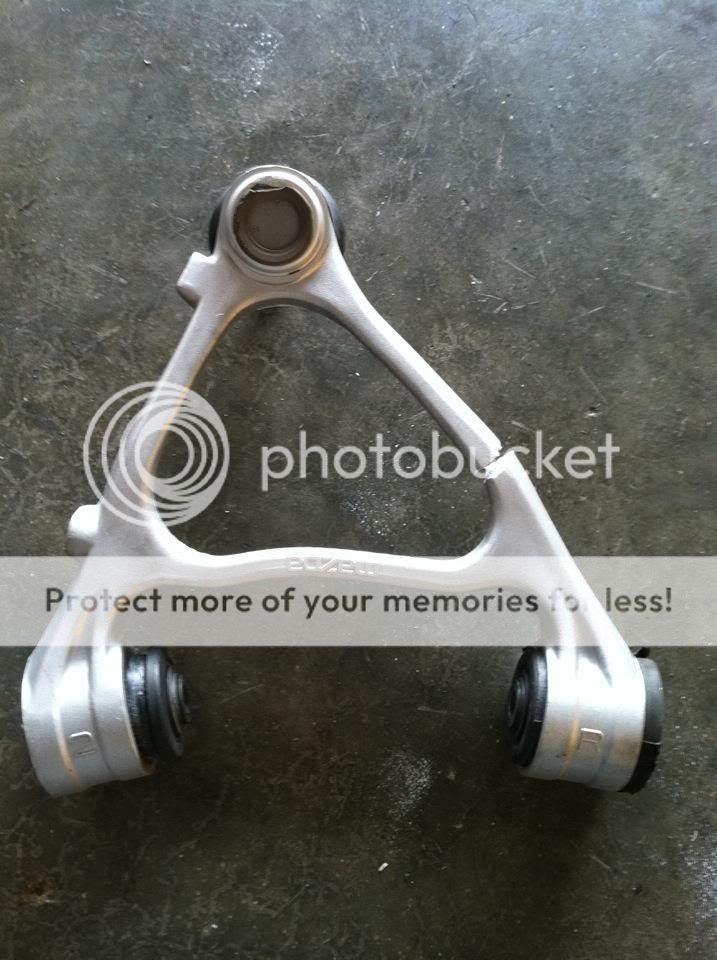

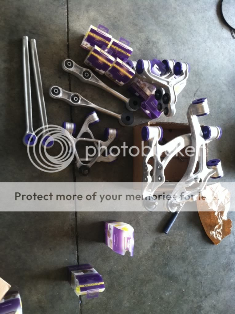

And yesterday, I was pressing on some Powerflex Bushings. I heard great stuff about them and once the old stuff were pushed out, install was a simple hand press in. I was amazed how easy it was since I've installed a set of Delrins in the past. Quality of Powerflex bushing were awesome!!
But I did break something... Lack of sleep and hurry to get the job done, I did this..
Luckily I had a spare :)

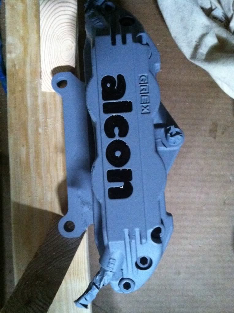

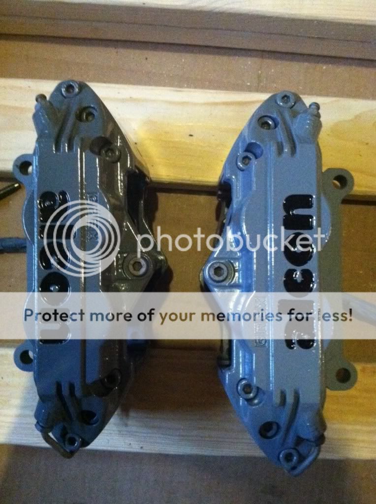

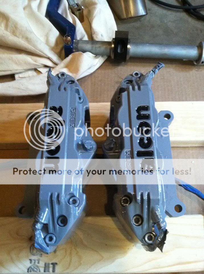

I also decided to refinish my Alcon calipers for this..
Did a pretty good job on one, but other one, I kind of messed up and have to re do it..
Anyhow, Tomorrow, I'm re blasting the one I messed up and re doing it.
Sept. 2nd, 2012 Well, I been busy trying to fabricate some stuff and re-doing my caliper that I messed up.
I had a chance to re-sand blast and re paint them.
now looks perfect :)

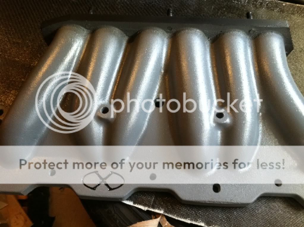

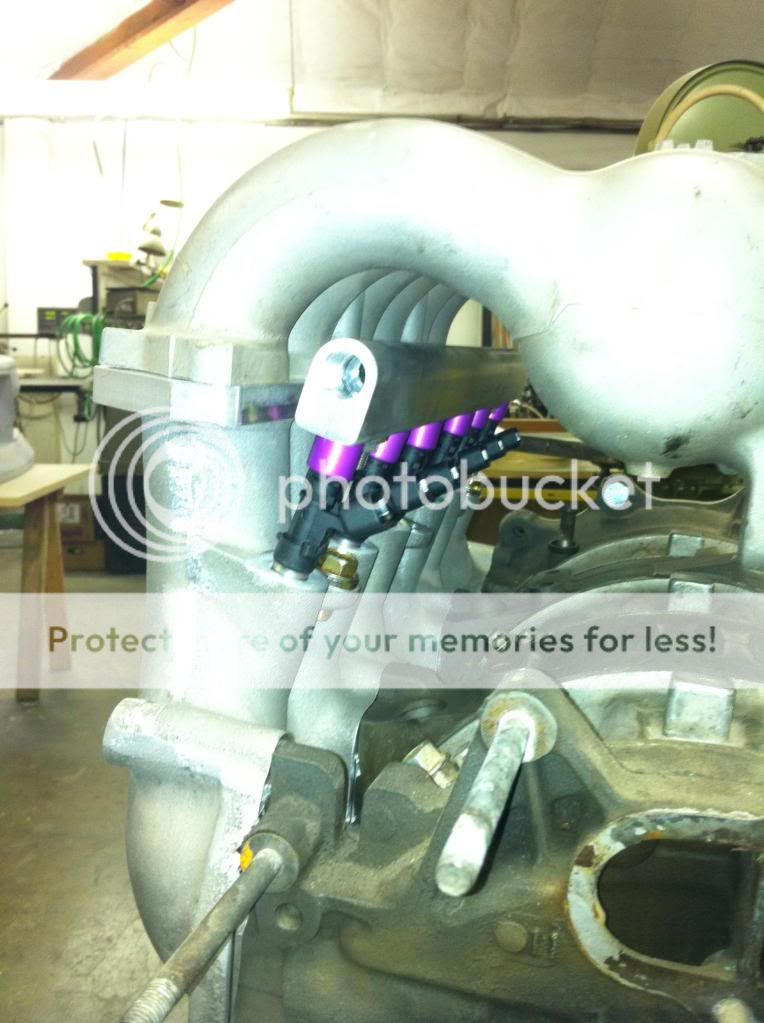

Also, an announcement of new LIM for 20B!!
I was lucky enough to hear about this LIM 6 months ago and now I can show it off to you guys.
This one isn't my photo.
More information about the LIM and more pics later...

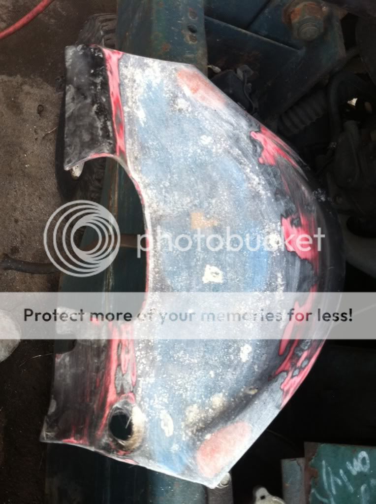

Cluster surround, fiberglassed and process of smoothing out.

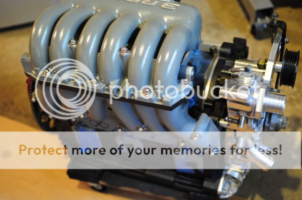

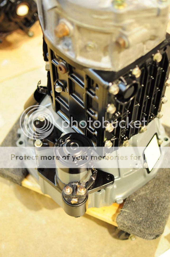

Studded everything and shorten bolts so I could put FD chrome nuts and bolts for the LIM.
This was from about 3-5 FD engines :)

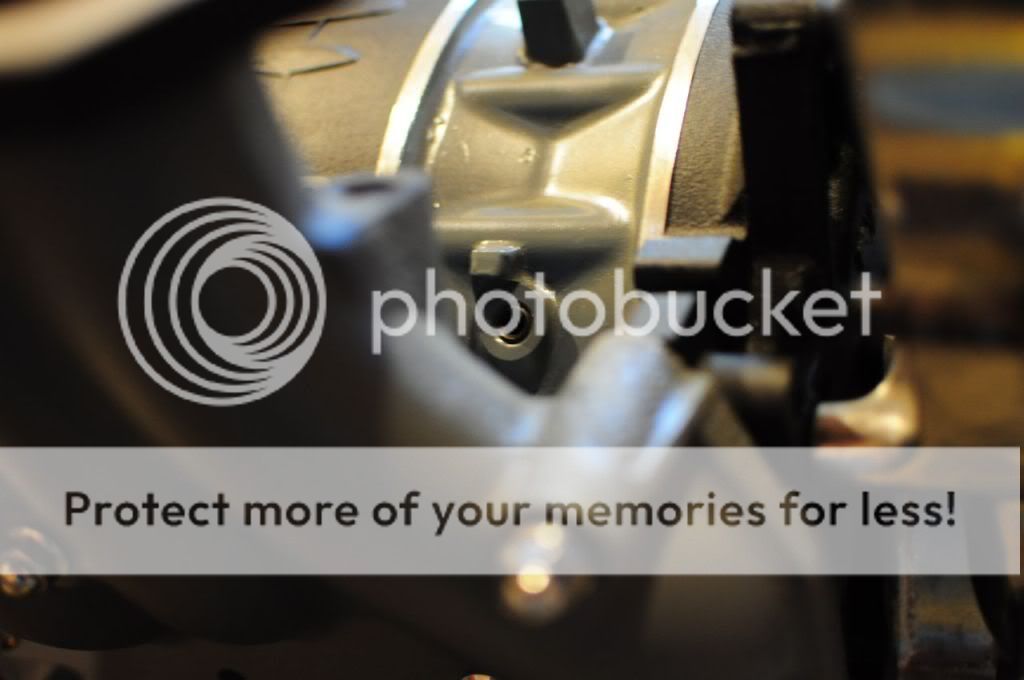

And starting to test fit everything and such..
Great to see a 20B assembled with such attention to detail and color coordination...Nice work, Phil! (2thumbs)
Is this Mig welded steel tubing? If so do you remember the wall thickness?
And again if it is steel how did it hold up? Seems like it would start to rust soon.
Looks like TIG'd stainless to me... maybe MIG'd, but the discoloration indicates stainless steel and the narrow welds indicate TIG.

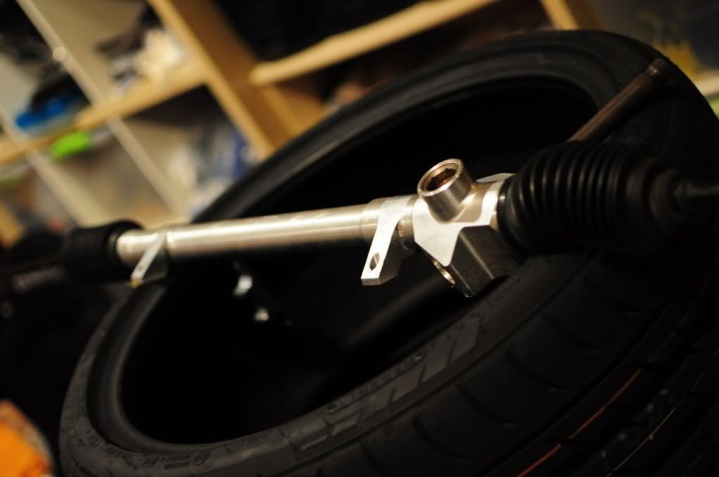

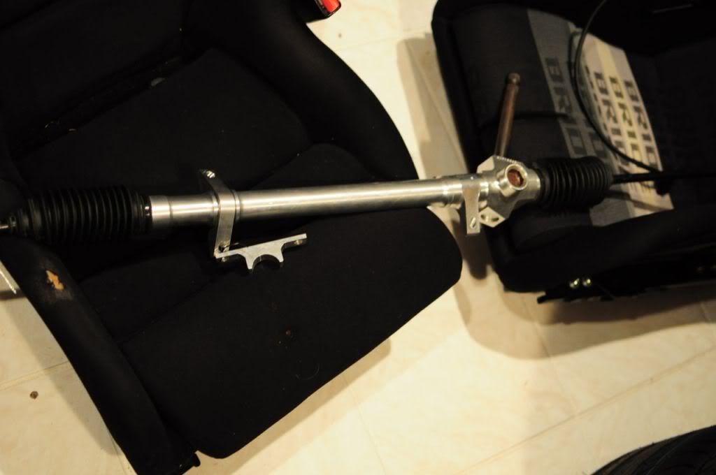

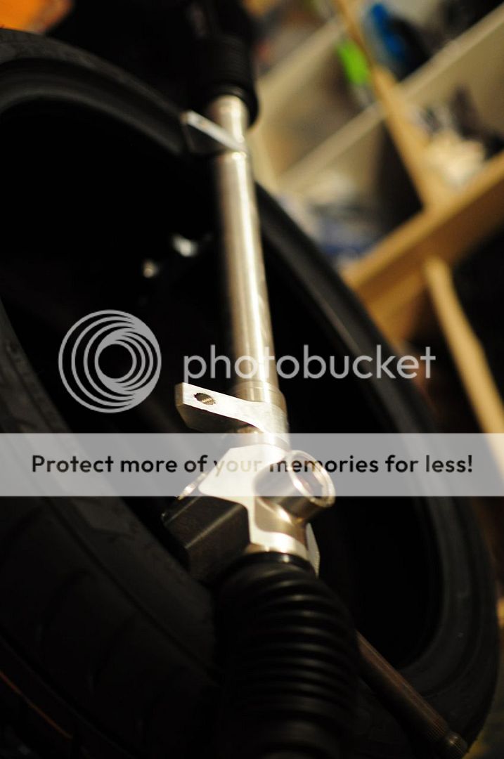

Aluminum rack..

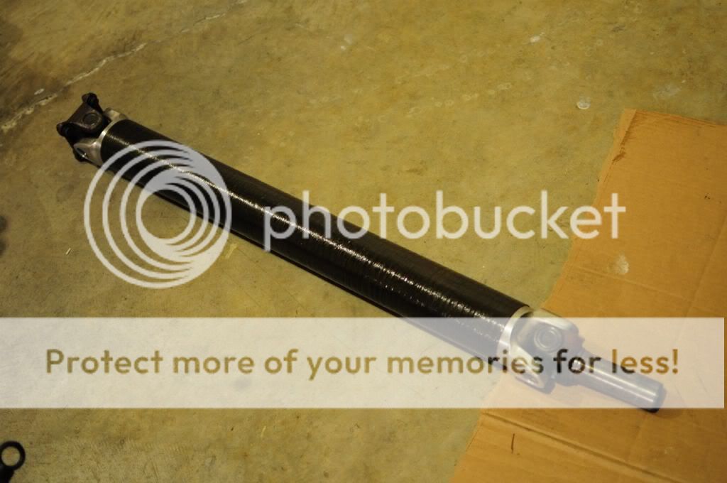

Carbon Shaft.

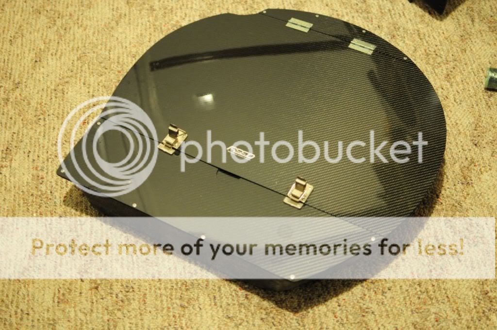

FEED trunk thingy in carbon :)

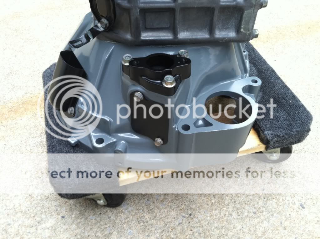

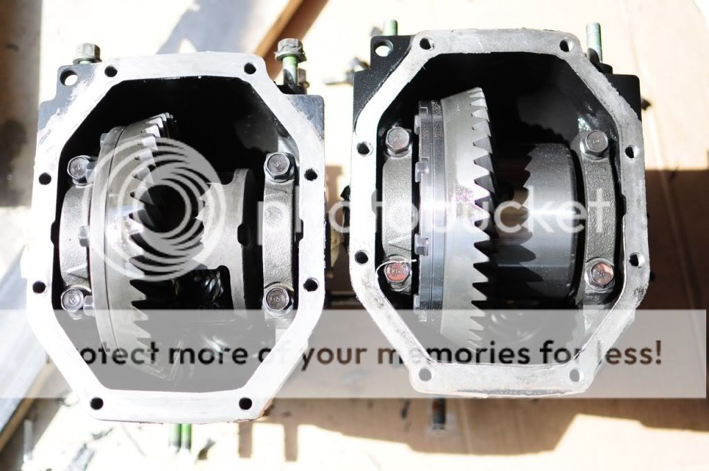

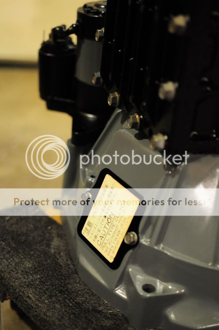

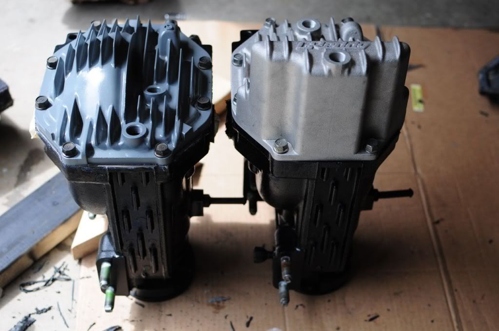

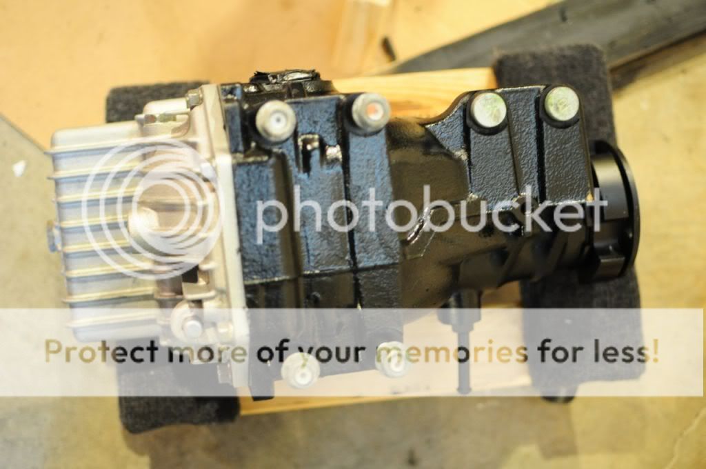

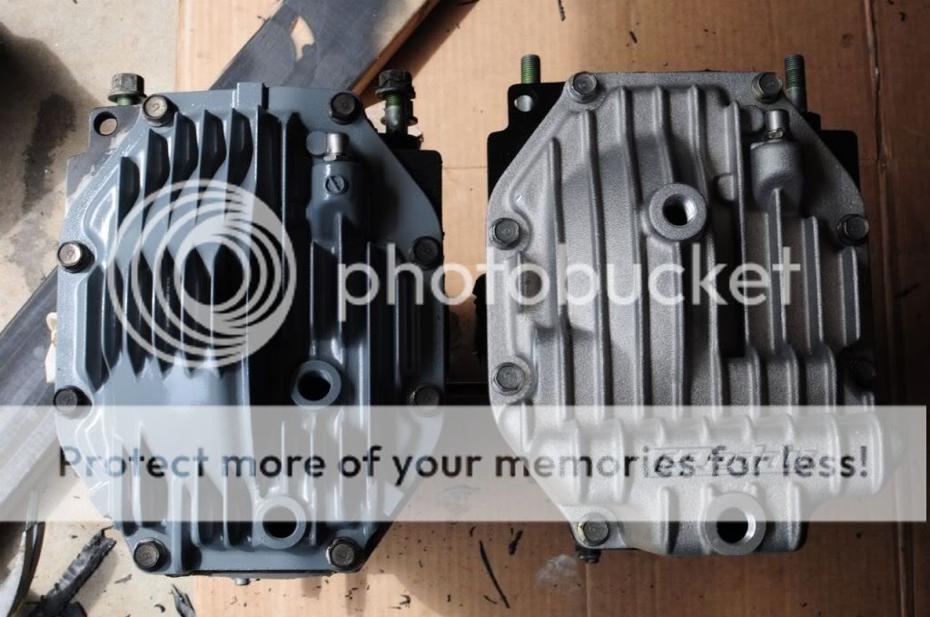

I finally took some time to work on the rear diffs of the FD RX-7s.
Here are some pics of the diffs.
Stock vs Kaaz
After cleaning the case, sanding it down, and re painting it with epoxy paint,.. I put the new covers on.
Stock vs. Greddy higher fluid capacity cover.
Thanks guys!! More update..

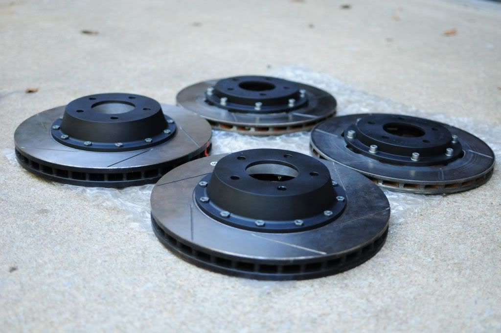

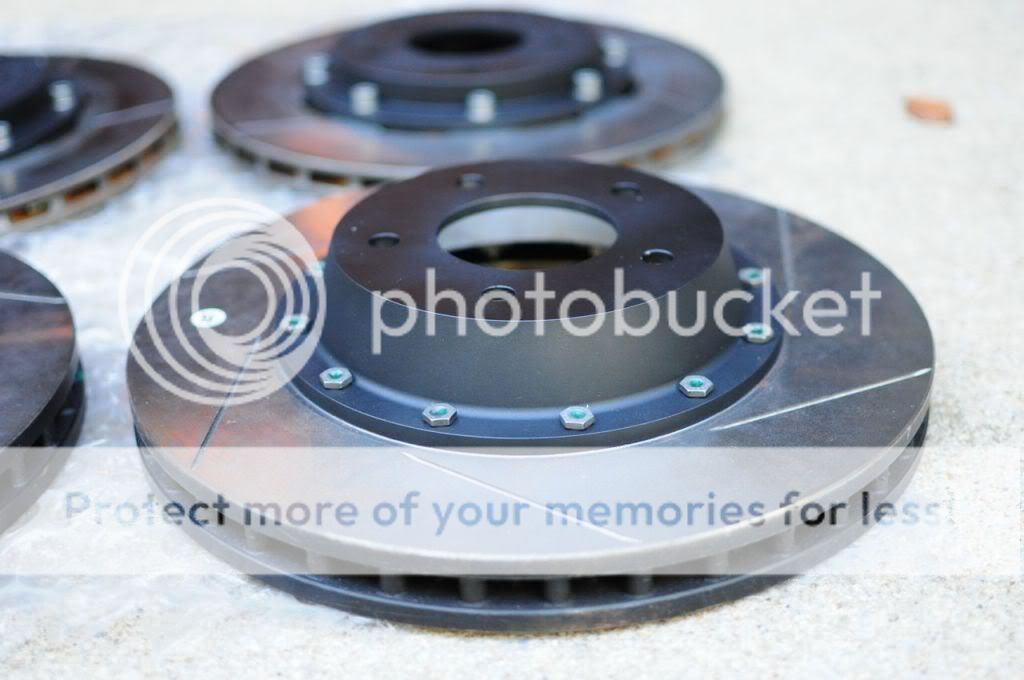

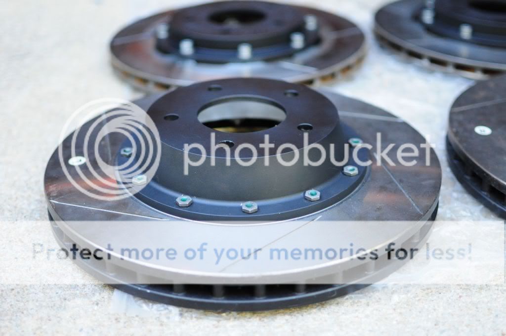

I had the rotor hats made for the Disc Brakes Australia rotors and got them refinished in similar black.

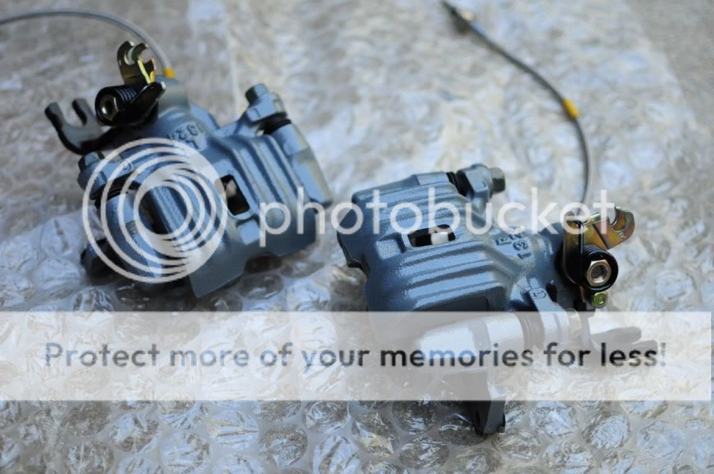

Cleaned up and repainted the RZ calipers.

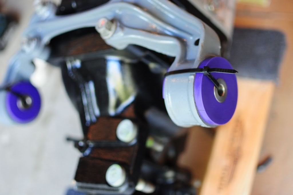

I also replaced the diff bushings with Powerflex bushings.
