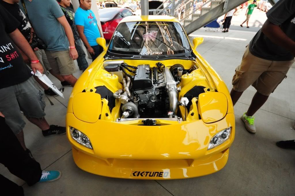

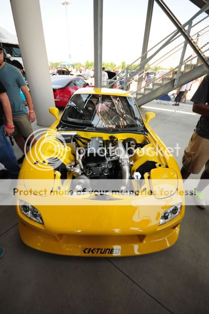

Well, On my way to pick up some goodies for this project and my MB, I stopped off last weekend at the Import Alliance in Charlotte, NC. There, I saw this yellow FD with K swap.
Up on closer inspection, the turbo set up seemed very similar to my 20B project. See if you can compare..
I did talked to the owner and they did a great job putting this car together in less than 3 months. Its definitely different... but not sure if this is something I consider a 'better' option to 13B or LSx. I was told it should make mid 400whp using GT35R. That's about what you would get from 13B. Also, unlike 13B, K seems to sit much higher. That's definitely not an advantage over 13B.

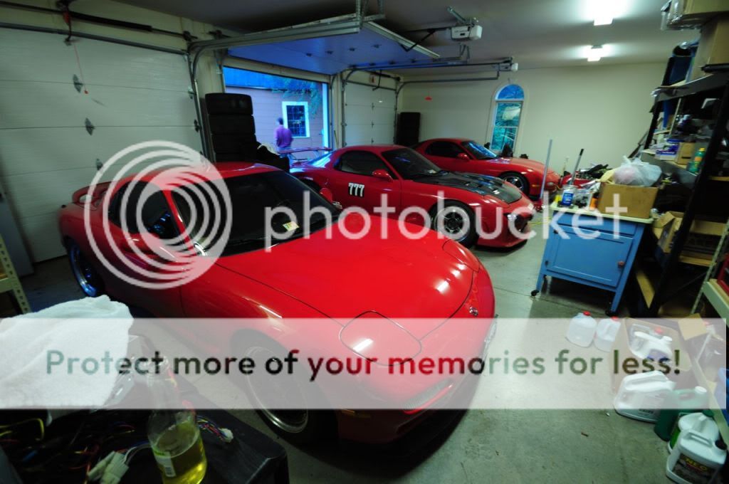

Picked up my goodies from one of FD fanatic, Fritz Flynn... here are his collection of VR FDs. I've also been to his 'warehouse' and I'm sure he has few more FD's sitting around there.

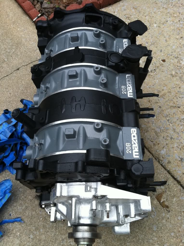

While the car is there, I've decided to freshen up the engine..
Then spent couple of hours taping up the engine..
And here is the finished engine :)

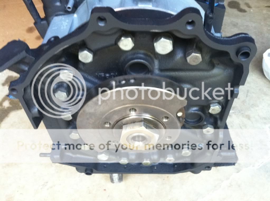

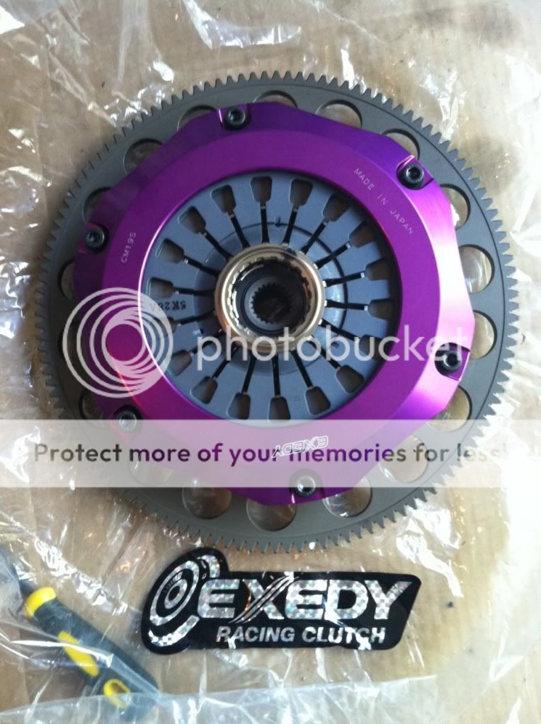

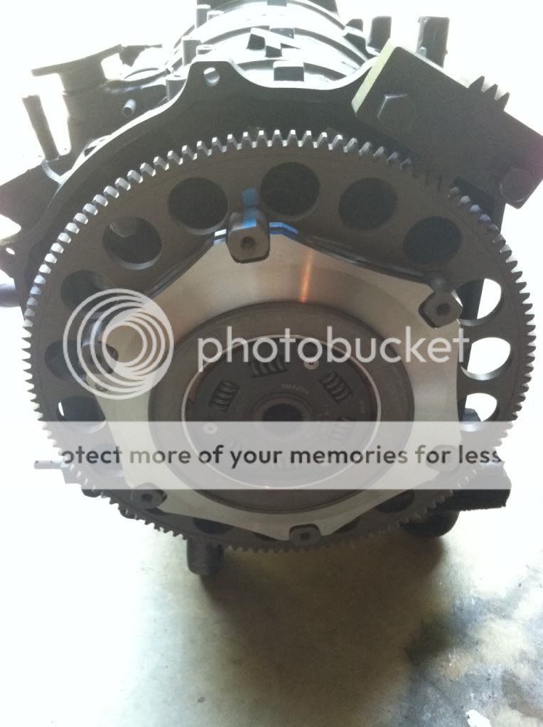

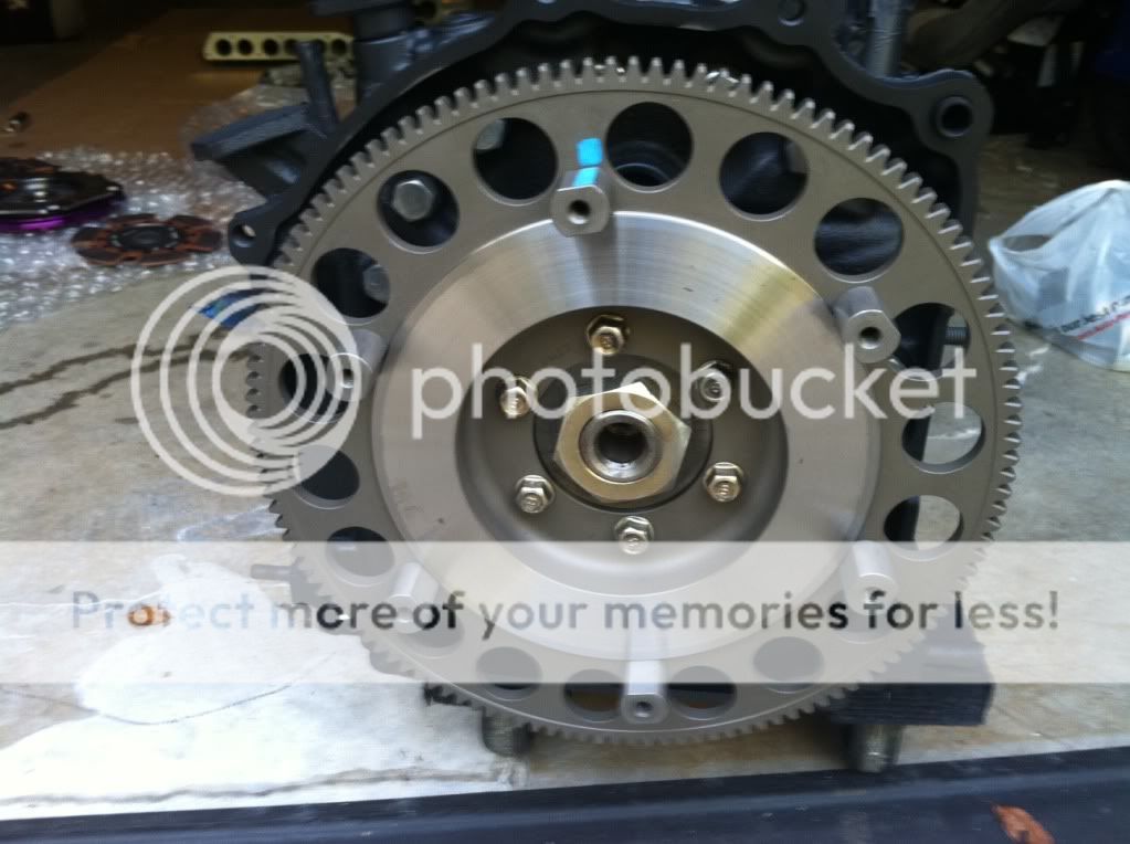

Aug 14th, 2012 - Today, I finished up the engine by touching up few spots, and decided to paint the UIM, LIM, and install the Exedy Clutch.
Lightened twin disc Exedy Clutch - Front side
Back side

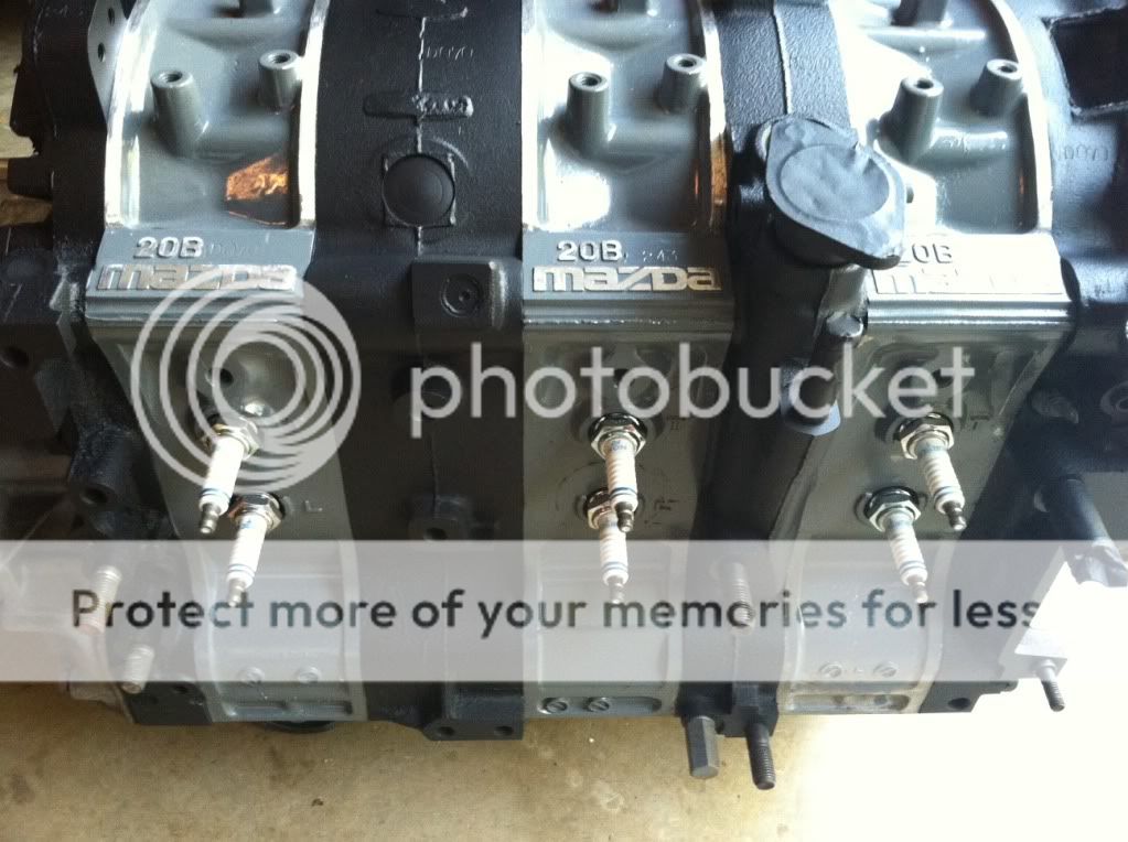

I also installed all new plugs
repainted the inside of the back.. and clean up counter weight.
flywheel torqued on.
Discs in..
And now, its on :)

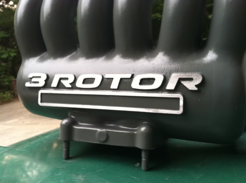

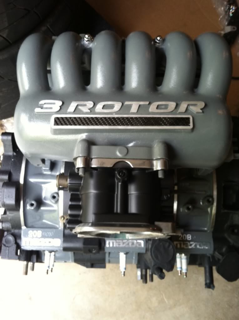

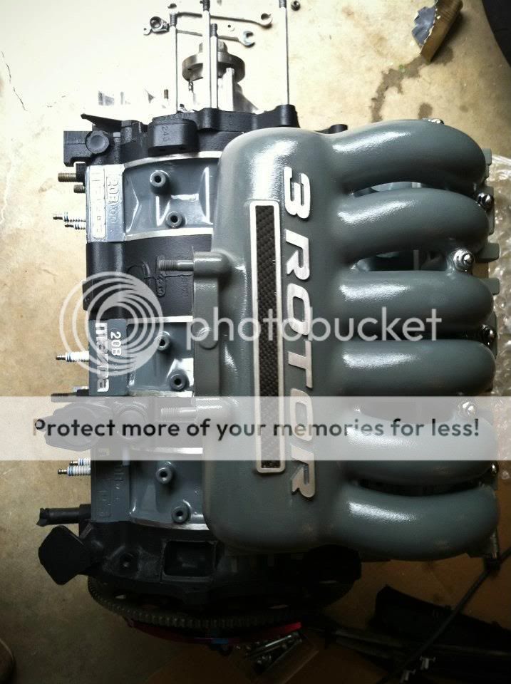

Aug. 5th, 2012 - This morning I decided to finish what I started yesterday... UIM and LIM.

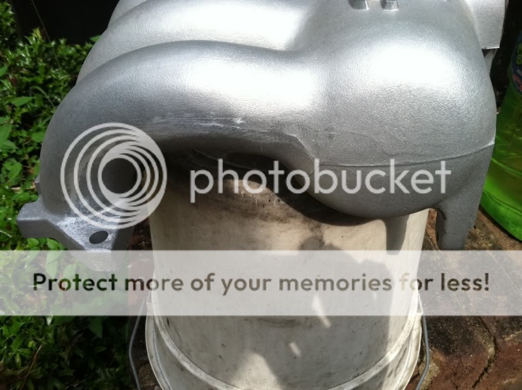

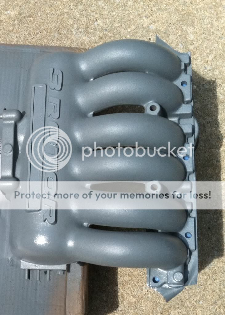

To start, I took some of the cast marking off by filing them off.

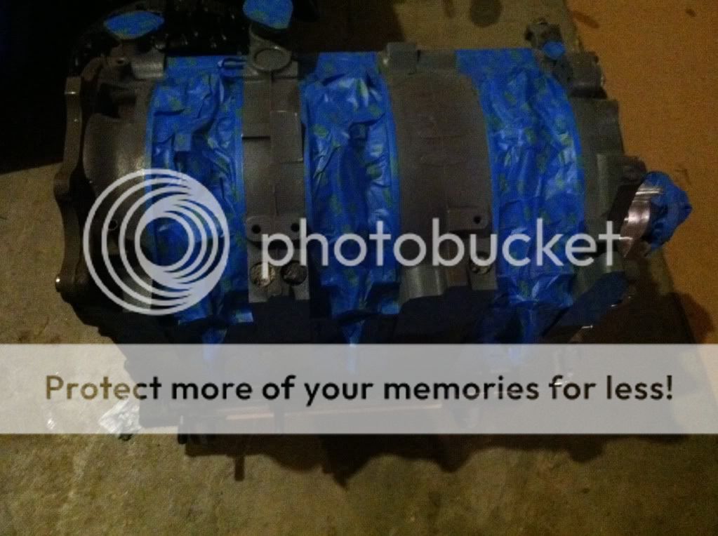

After about 1-2 hours of this, I taped it up and sprayed with the same gray I been using, with high temp clear. I initially thought about doing wrinkle red, but after painting the short block, I think it might be bit off.
I let it cure over night and using a file, I took the clear and paint for the machined look, "3 ROTOR".
And to tie in the exterior of the car, I took one of the carbon fiber panel I had and made an insert. This took bit of time as I didn't have the right tools and used some sand paper and file to make the rectangle.
Next is TB and some of the accessories to match everything.. So, more pics in next couple of days.

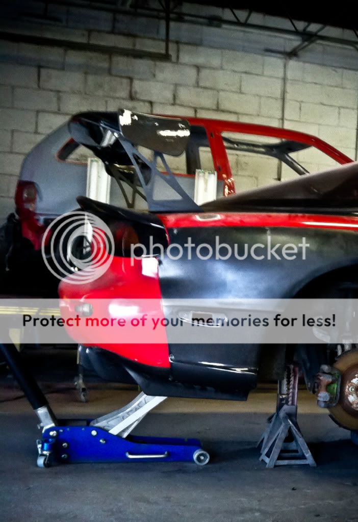

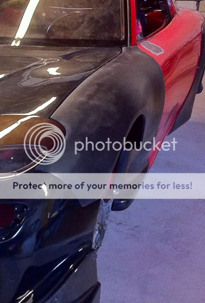

Aug. 17th, 2012 Update.... Some body related updates.

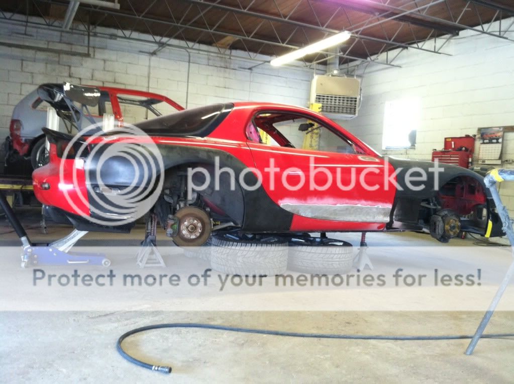

Goolsby Customs did quite an update since I brought the car to them about 2 weeks ago.. They have now install most of the panels and lining them up.
Here some pics..

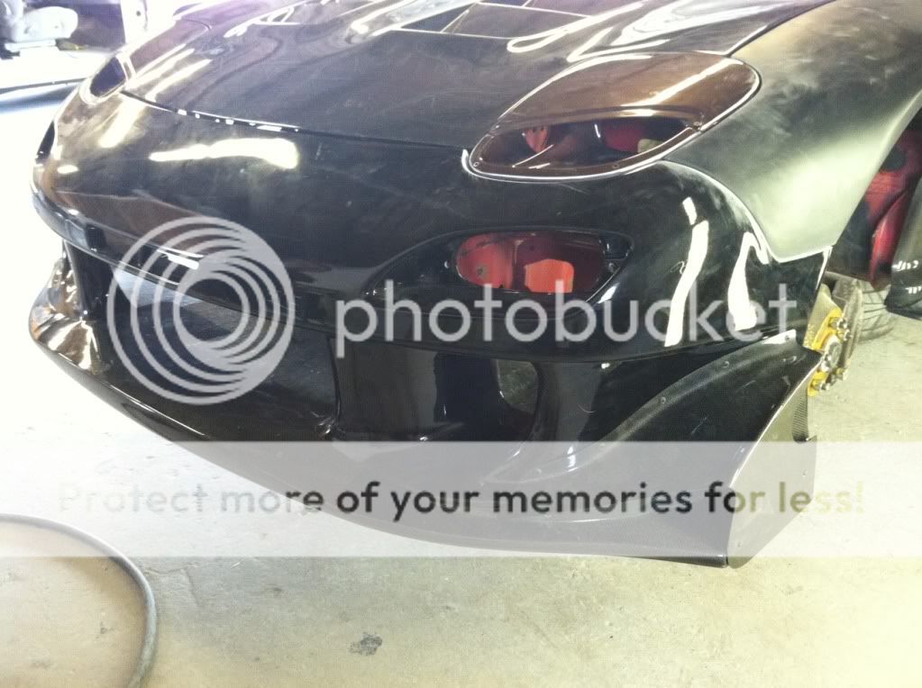

fender, lights, and bumper
Front bumper, lights, canards, and undersweep
FEED wing, lip spoiler, etc
Rear wheel well cut for the FEED fender flares..

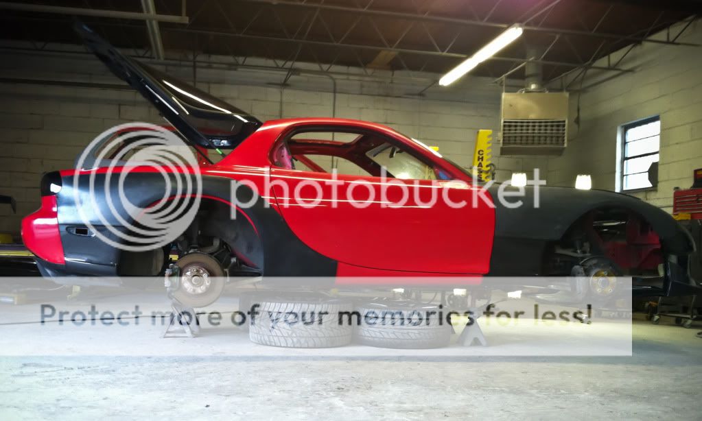

Aug. 20th, 2012 Some minor update but not much to show... anyhow, more pics :)
How the car is sitting now..
Test fit the UIM..
Aug. 23rd, 2012
Couple of things to update you guys..
Car's coming along with all the panels are on except for the fender mirrors.. I'm hoping to pick out the paint color tomorrow or early next week.

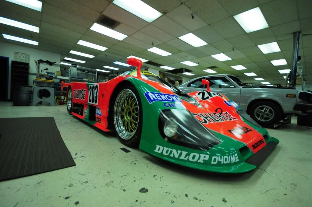

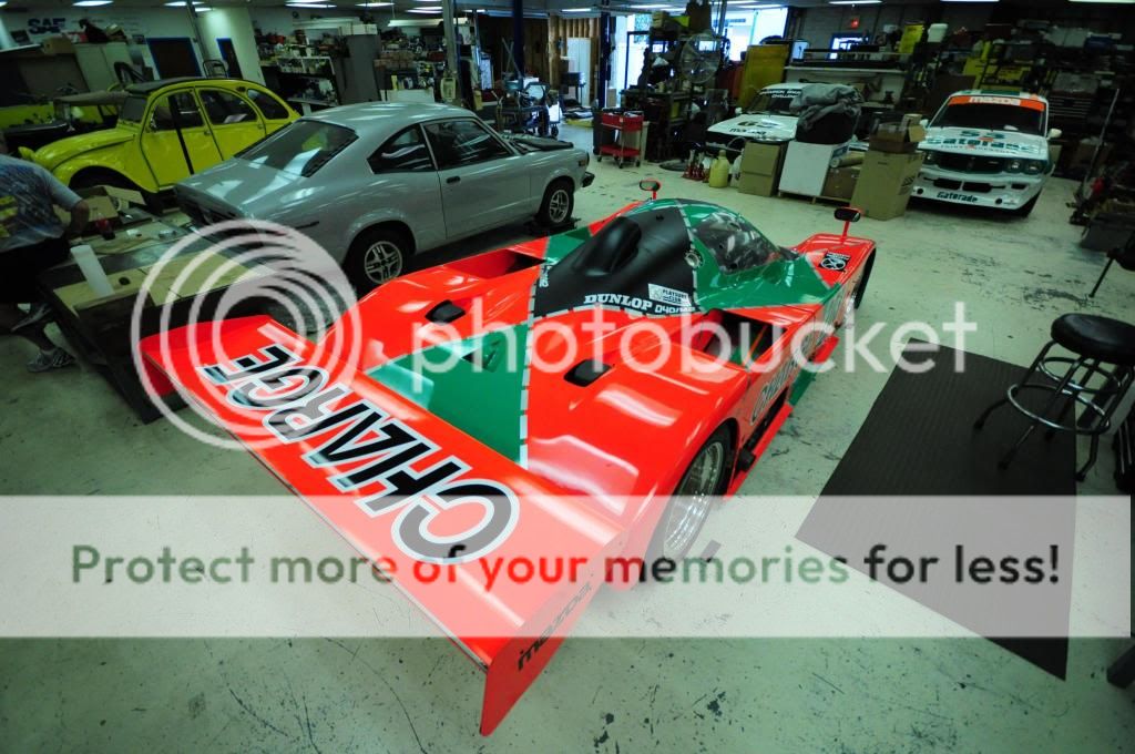

And finally, the writer of this article contacted me and told me about the rare 767 4 rotor race car (http://www.stanceworks.com/2012/08/...-my-date-with-the-mazda-767b-at-road-atlanta/).
It was being rebuilt at the famous Jim Downings in ATL (Also developer of Hans Device). I made call to a friend at Downings and found out that it was still in ATL, GA. I planned to head over there and couple of days before, a friend and manager of Mazmart, Paul Thomas, decided to organize an event for those interested in seeing. I than talked to Paul to find out when, rescheduled and went to see this rare 767..
And here are some pics from it.
And I got to see it before everyone got there and took few of these without the crowd.
i'll post a video of this in couple of days.
