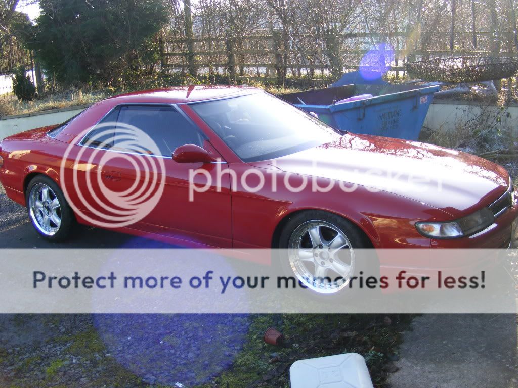

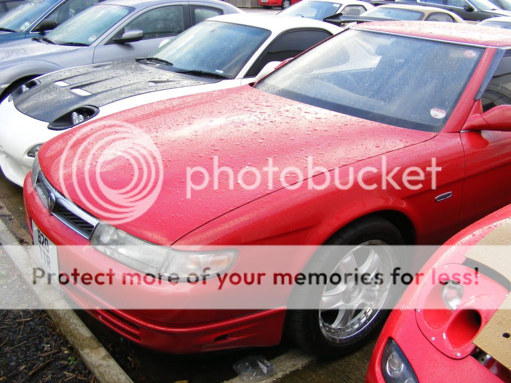

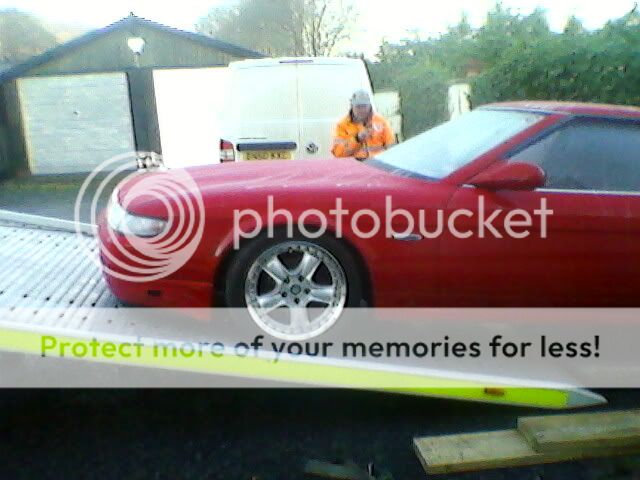

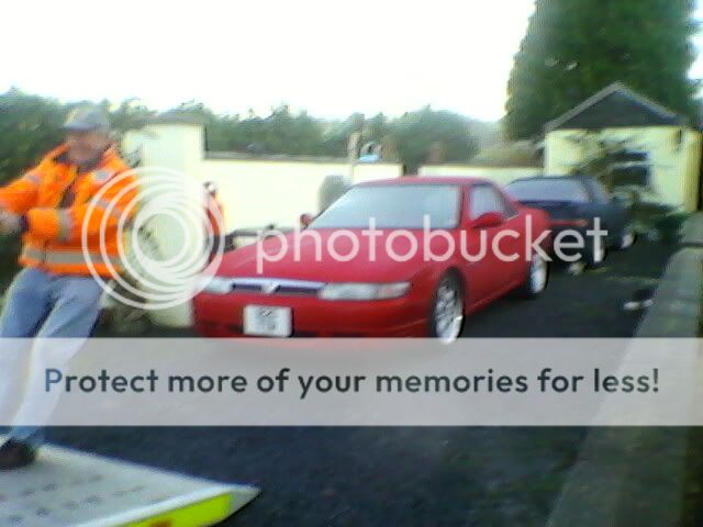

Just a few quick pictures of my baby going away to Doctor Pip to be fixed, typical it has been garaged since she went pop which was 9+ months ago, due to me going to work at a time of the day when clubbers are only going home I had to pull her out of the garage the night before,, and guess what it threw it down with rain all night,, well I suppose it washed the dust of her

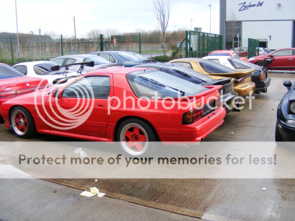

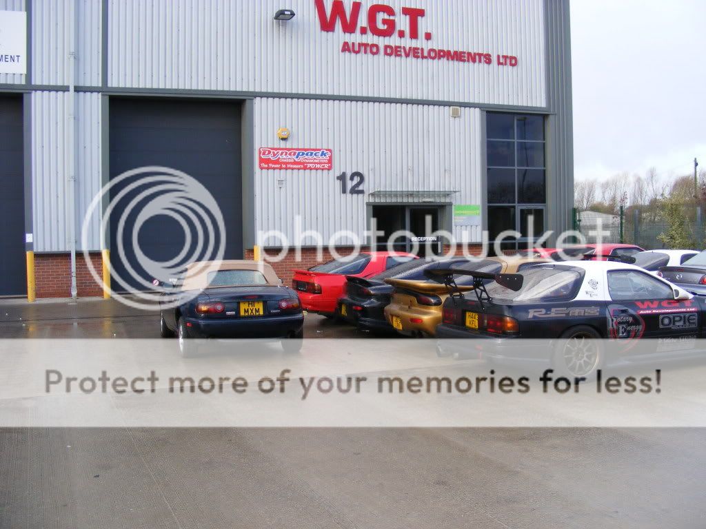

went over to see Pip at WGT, as you can see quite a few rotarys parked outside for various bits of work
Nice series1, not sure what plans are on the cards for this one, it has been here a while but looks in really good shape
My baby parked up, as you can see suspension looks a lot higher without the 20b lump sat under the hood

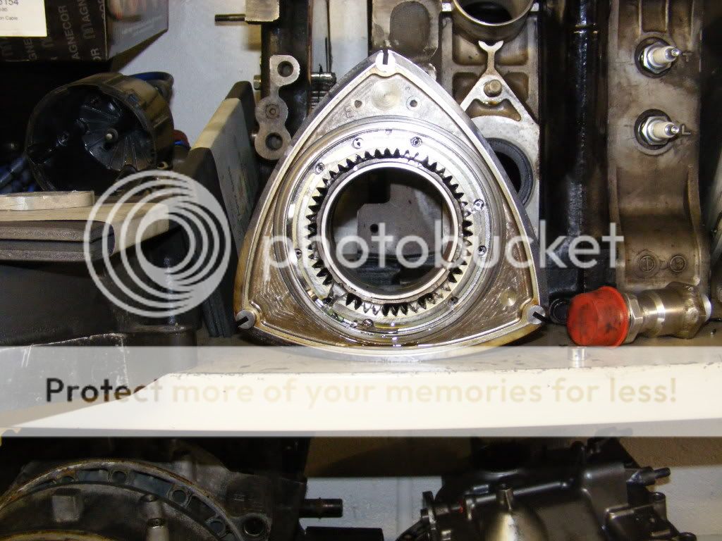

A mighty 20b motor sat around looks a bit serious this one, didnt get a chance to ask Pip about this and what it is destined for
I saw this sat on a shelf I could not resist a quick snap

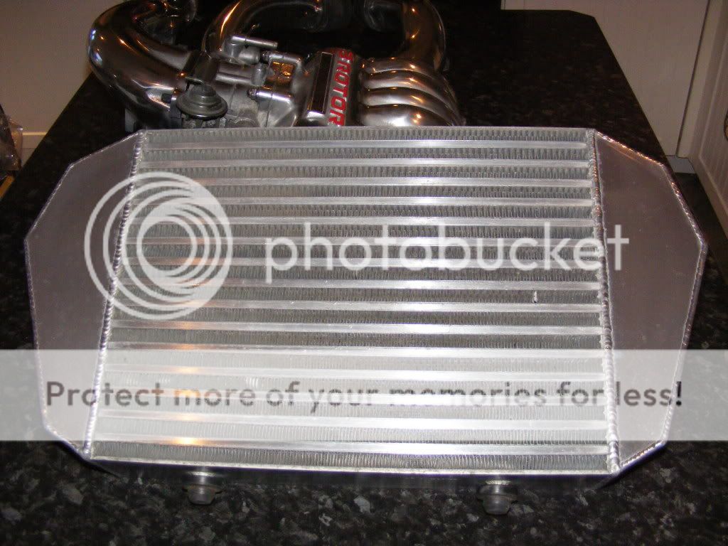

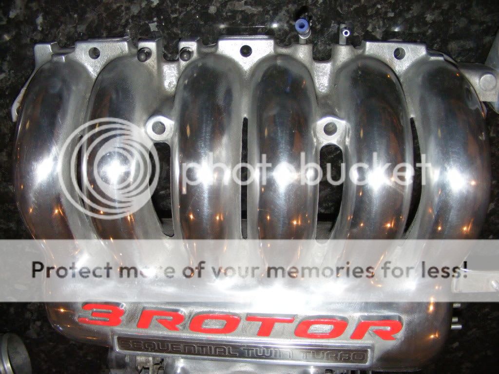

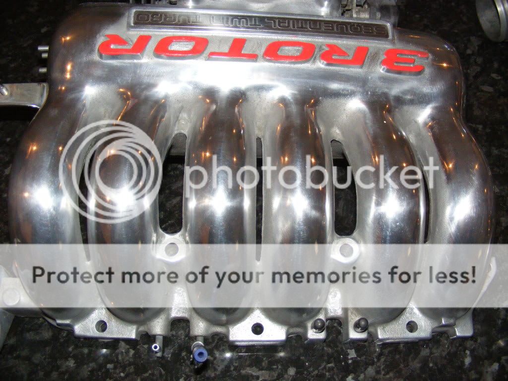

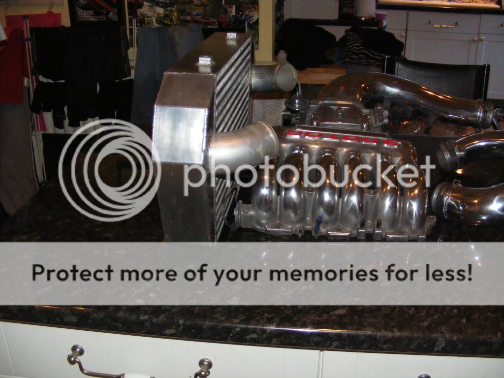

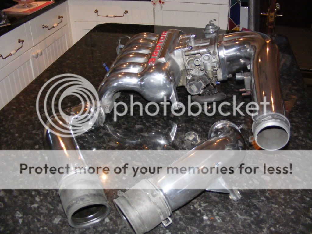

I have managed to get hold of a second hand DMRH intercooler pics to follow when it arrives, I have also sent the hard pipes and upper inlet manifold away to be polished and I am picking them up tomorrow so I will post some pictures of that as well. it will not be show quality but will tidy it up a lot in the engine compartment, I have also asked Pip to get the 20b motor painted as well before assembley so all in all it should tiday it up a lot.

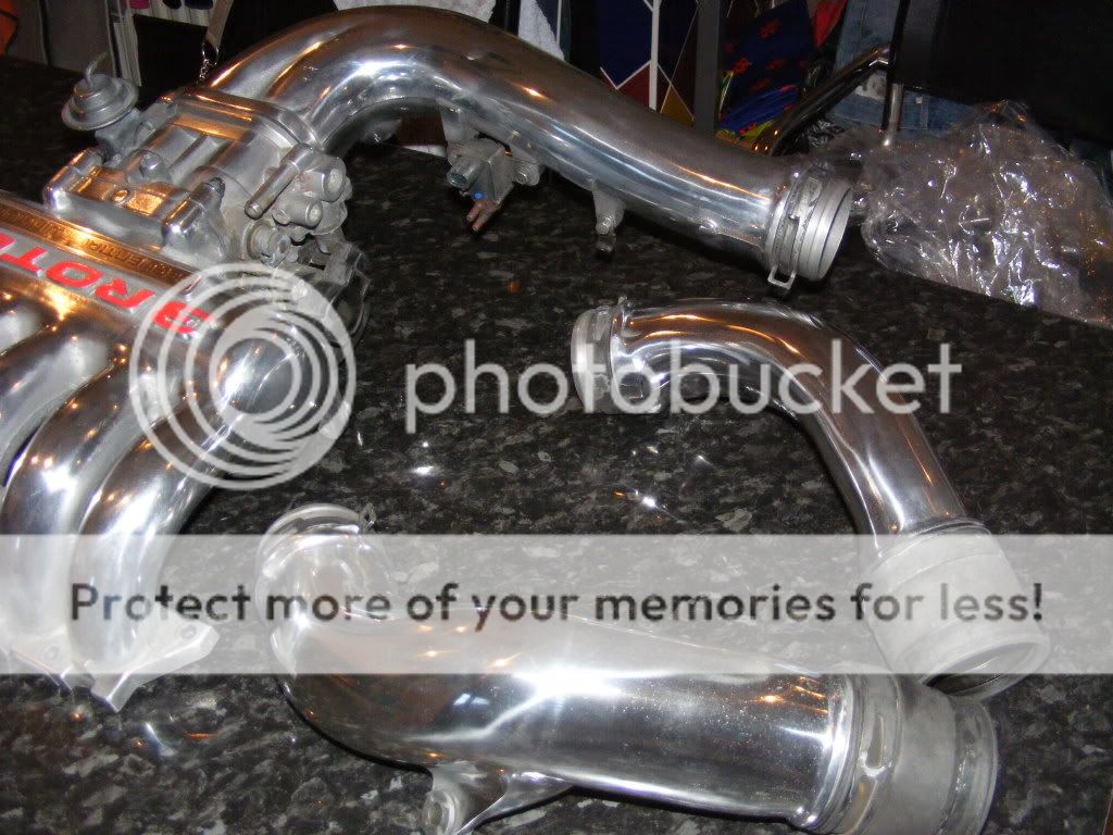

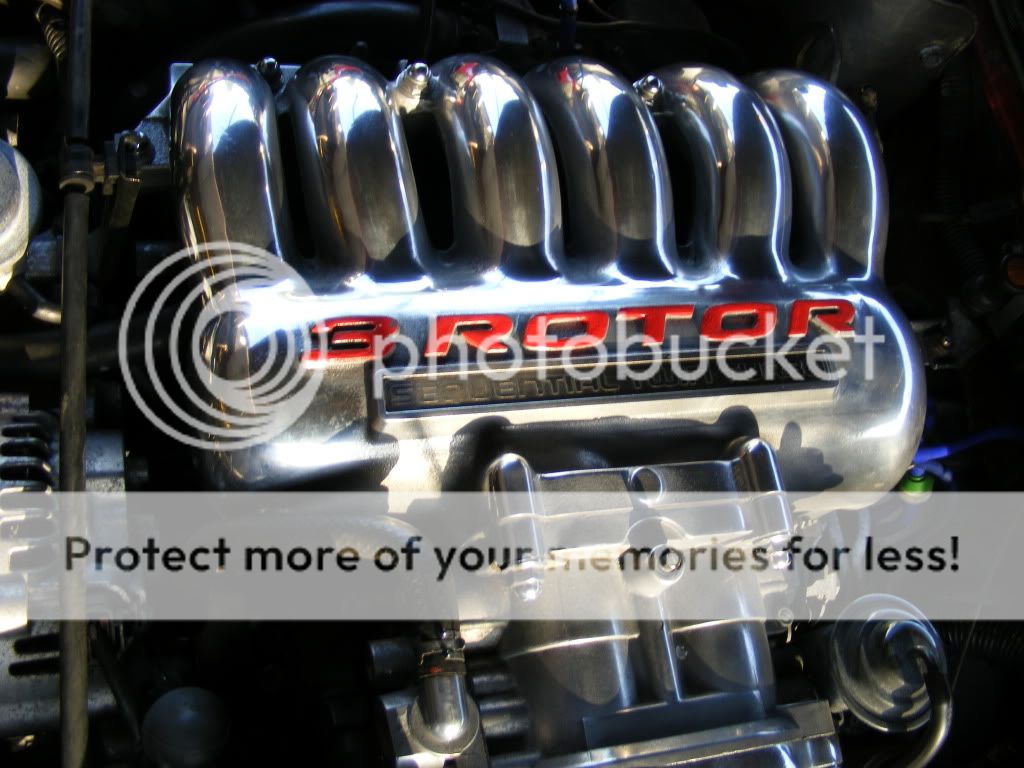

quick update on a few things, had the hard pipes and UIM polished, not show quality by any stretch of the imagination but I have to say they will clean the engine bay up a real treat, I painted in the 3 ROTOR lettering myself, how long it will last remains to be seen but looks ok for now.

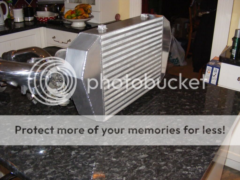

I managed to get hold of a DMRH hi-flow intercooler,,, for those that don't know Dave Morris got these custom made for the Cosmo by a firm in Australia, I do not have the hard pipes that come with the kit so I will have to get some pipework made up with bends to ensure they fit with the standard hard pipes I have just had polished,, well that's the plan anyway, but not for a while as I will be using this in conjuction with the planned engine mods ,, a big thanks to Kev for selling it to me at a bargain price,, I gave it a bit of a polish up but it is in fantastic condition

The Polished bits back where they should be, looks quite good under the hood now, a little more tidying up to do here and there but overall pretty good, I havea re-am strut brace to fit which I will be doing in the next week or so.

No I have not changed the intercooler yet I am going to leave that until after the gearbox has been done and do it at the same time as the ECU job, I am just gathering the bits as they come along as I am sure when I want them I wont find one cheap anywhere.
I got a cracking deal on the intercooler 50, about $100 NZD could not pass that up as it is in really good condition as well
That is a great deal. Would you mind posting the dimensions of the core as well as the overall including tanks. Is it still 2 1/2 inch piping. How is the running in going, have you had to fit a snow plough to the front of the car with that great winter you boys are having up there.
Darryl
Darryl
Hi Darryl,
I will do that for you, if you have a look on DMRH web site under my cosmo it does have a little more spec on it and a few pictures, it is the same size tubing and all the mounts and bracket mounts are based on the OEM so it is a straight bolt in swap.

dimensions of the intercooler are as follows
CORE
40cm wide
30cm high
8cm deep
TANKS
5-8cm wide (tapered)
30cm high
8cm deep
hope that helps
Frank
