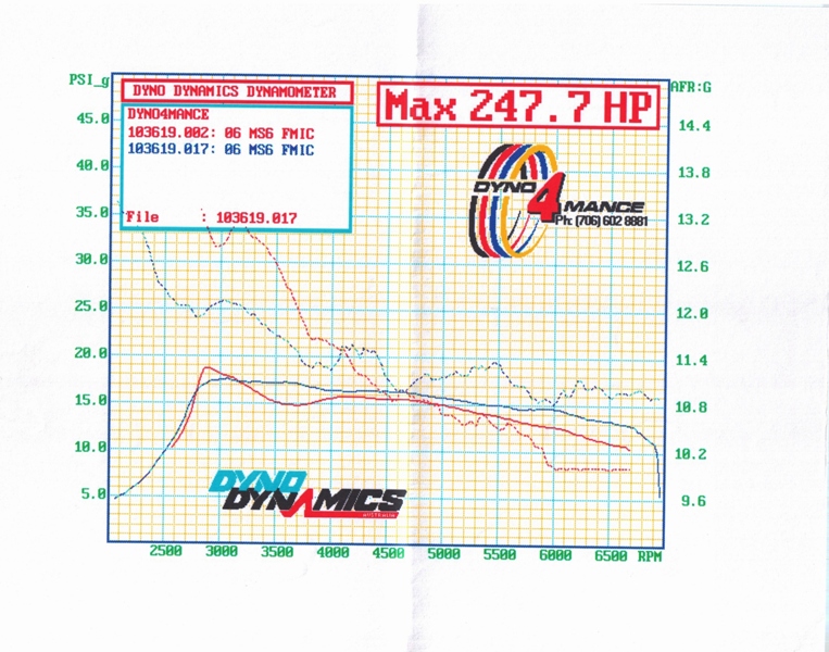

PROcede is a topnotch product I was very impressed with the way my car was tuned and the way it felt when I drove it. My order is in and I'm SOLD! My car never felt better. Held boost all the way to 7k, Pulled harder, Ran smoother, Very impressed and the knowledge that Dyno4mance brought to the table was AWESOME!!.

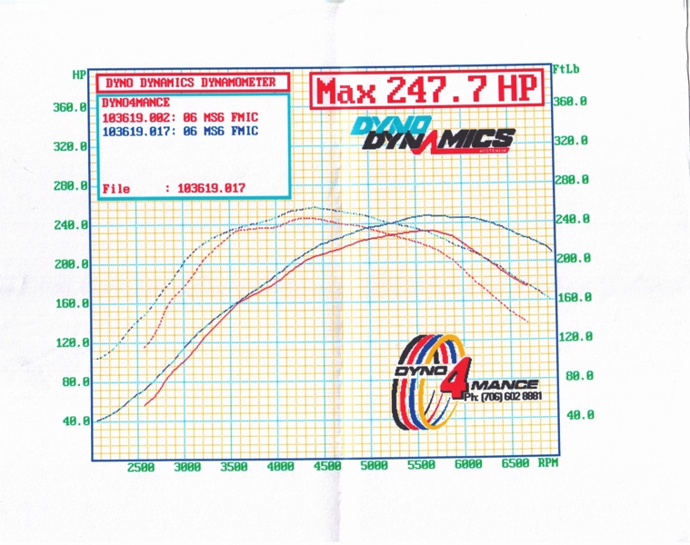

Dyno is kind of low at a glance but their dyno reads about 12% lower then a DynoJet. I have no boost cut, my car WAS pulling 18 to 19 PSI before the tune and they showed me that I was actually loosing power that way. They brought it back down to 16 and I actually made more power. I guess around 19 PSI it's blowing hotter air.

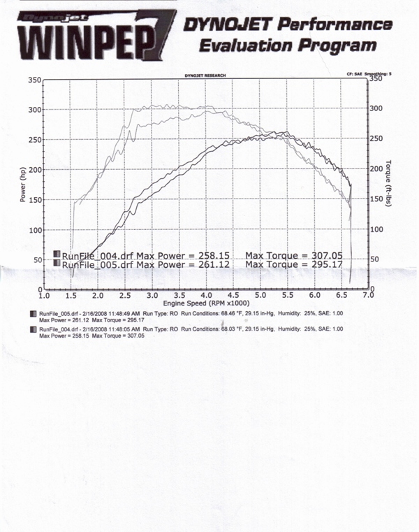

I will include the DYnojet dyno from a few weekends ago on the dyno jet untuned and include the Dynomatics dyno for you to see.
AGAIN VERY IMPRESSED I'm sold and the fact that I will be able to run meth with a failback map that would switch back to the gas map say that something happend like a leak or the meth bottle went empty and it will do it on the fly. AWESOME!!!
If you take the number on the dyno and multiply it by 1.12 that will give you an Idea on what the Dyno Jet Number would be around.

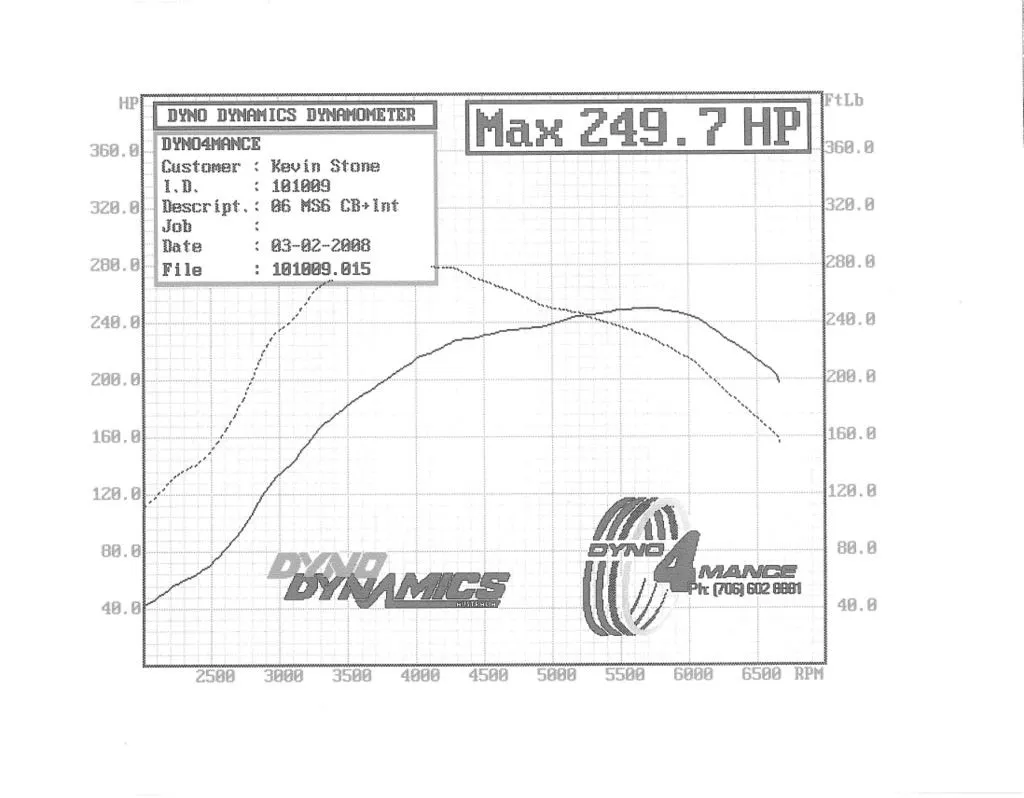

My friend Kevin was also there all he had was a CAI and the Magna FLow CB
His base line was 231 Hp The results with the PROcede were 249.7 and 280 Ftlb. Not to bad.

On their Dyno 247 when it was done.
After doing the math that would be around 276 on a dynoJet. It was a conservative tune at 15 psi. I'm going back to get retuned and then again whenIget my turbo.
