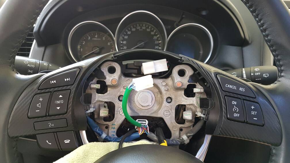

My clock spring has all 14 pins on the electric side beacuse i have Bluetooth and cruise control. What i meant was that usdm cx5 have 2 airbags connectors for whatever reason they think is needed, but jdm cx5 only have 1.
I already tested the wiring from inside the steering wheel to the big white connector of the start/stop unit and they have connectivity. Im trying to get a hold a pin layout of my actual car to see if there's a difference on the wiring of the unit. I had this problem before with the mirror autofolding kit i brought from germany. The pin layout was different at 1 point and i had to figure it out.

Im gonna try to change the ground to see if this would help. Ill let you know.
Sent from my SM-G935F using Tapatalk
Sucess!!! Its working as it should now. Culprit was a faulty ground on the paddles shift connector inside the steering wheel. Took me quite a while to figure it out but its all sorted now and it works perfect!!!
