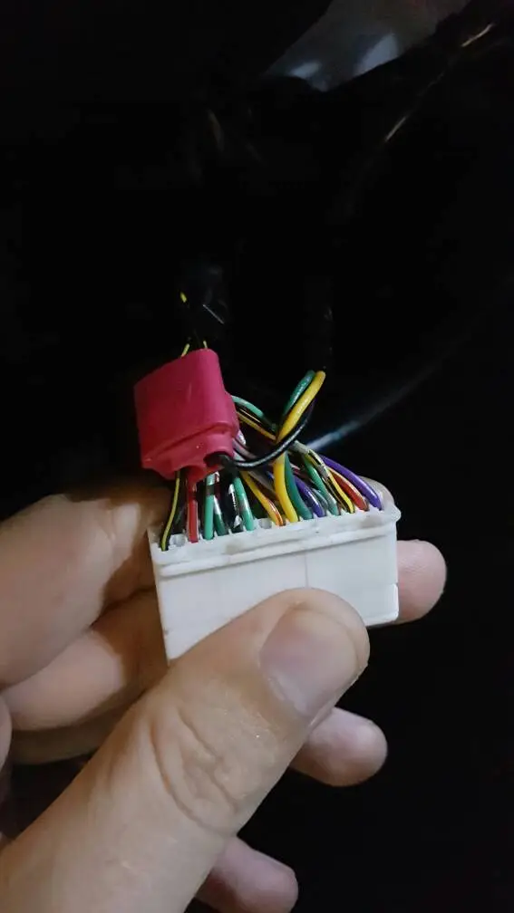

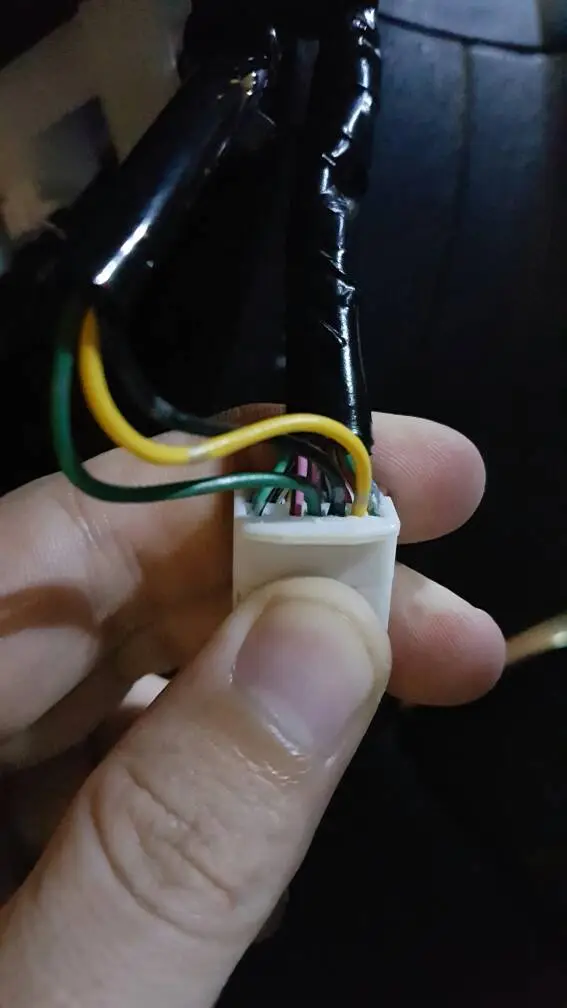

I got the kit from japanparts installed everything as srad600 guide (i have a 2016 as well) but i get nothing from the shifters. All cables are secured properly, everything is connected as stated and all previous functions still work as expected. i have seen that previous install had this issue but never seen the fix for it.... any ideas???
Edit: on the video above this post the guy when it first start the car has the same issue i have... but it does not say what was wrong. See minute 28:07 onwards.
Just a thought, which wire harness did you use, the one with long pins or short pins? Maybe is not the right one and it's still not "connected" electrically.
I used the long ones. I checked the length of the connectors before use. I'm thinking on doing a continuity test on all wires to check if something is not connected. Not sure if this will mess something on the car though...
Just check with one lead, at one end of the connector and with the other lead, the other end of the connector and you should be fine.
Check your ground also. IF all the other connections were made properly, this is the only one that doesn't lock into a connector.
Just check them. Ground has full contact. uploadfromtaptalk1460165228854.jpg uploadfromtaptalk1460165235063.jpg
Edit: i just tested all 3 cables from inside the steering wheel to the start/stop conector. Every one checks out. So all my contacts are good.
Only thing left are the pods themselves...

On the big connector, did you open the locking tab to inserting the wire, after that did you lock it?
When you say that you have checked the connections, do you mean with a meter right?
Yes. I opened like in the picture of the OP an inserted the wires an then closed back. I check the wires with a multimeter to make sure i did not missed and wire seating.
My car is japan made so im not sure if this will change something on the wiring...
