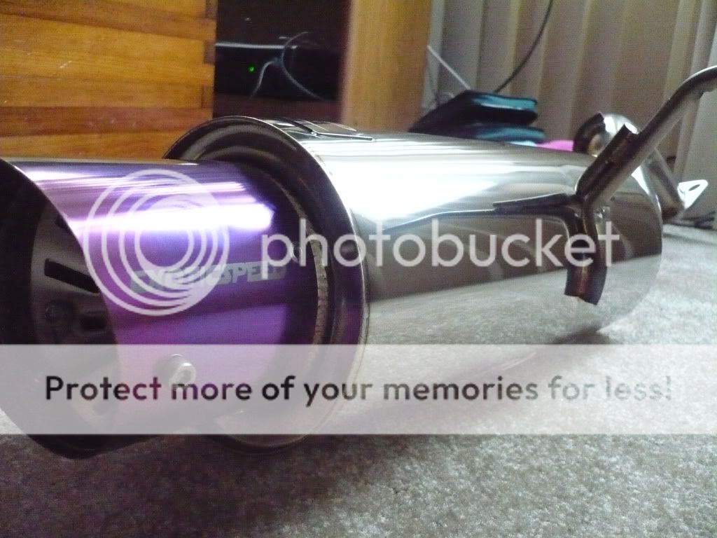

I think they discontinued it. its not on their site, but i do have it on my car. Sounds sexy with a ractive header. heres a pic before i put it on.
*it is a catback, only axleback shown in picture**Bought from a forum member*

Small world...this is same catback I bought back in middle of 2004. It became donor piping for the Magnaflow muffler. Also had Magnaflow hi flow catted flex fitted midpipe made to go with catback. Still runnin that exhaust today. Has held up beautifully. Have only replaced donut gaskets on it once so far and they coulda used it but weren't even leaking or anything like that.
