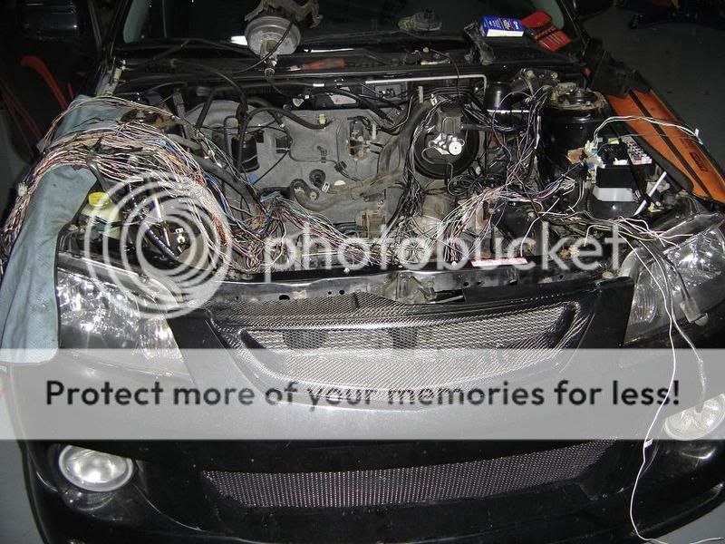

lol! left lane is passing. but I do pass on the right too. I jus don't like to because its deemed "aggressive". but what are all those wires????

Ah, doesn't that look sweet?
Though wires are the harness pulled apart to make the old harness work.
Here is my conversation regarding the swap:
Quote:
Originally Posted by Magus
OK here is the deal. I have a Protege5 02 with an auto. I would need the KL-ZE and manual tranny from a MX-6 (around 96?). So is what I am hearing that you mix and match an OBD II and OBD I wiring harness so the dash works right, or are you using the MX-6 dash?
Normally I would not care about OBD II, but I need them to be able to plug up and say it's good for emissions.
Also since your already droping in the engine and redoing the harness is it that much harder to drop in a manual in as well?
I Figure find a MX-6 front clip
Also do you guys have a website or address? I live in the US, but damn if this is not a cool idea!
ADDITION: If the TwoFast Racing is the right address your only a 8 hr 42 min trip north! How much would a conversion like this cost? And since I would be coming a pretty far distance, would it be easier to have your guys get the parts and would that be included in the cost of the conversion?
Magus
Domspun
A 98-02 626 V6 manual front clip would be the best in your case and it's about 3 to 4000 plus the KL-ZE, plus labor, so it would go up between 6 and 7k! A little bit pricey, but you'l have an OBDII KL-ZE, also you'll have bigger front discs from the 626(same size as the Mazdaspeed).
You can e-mail me at info@twofast.ca
An auto to manual conversion would be a little more work, but while we're at it, why not!!
