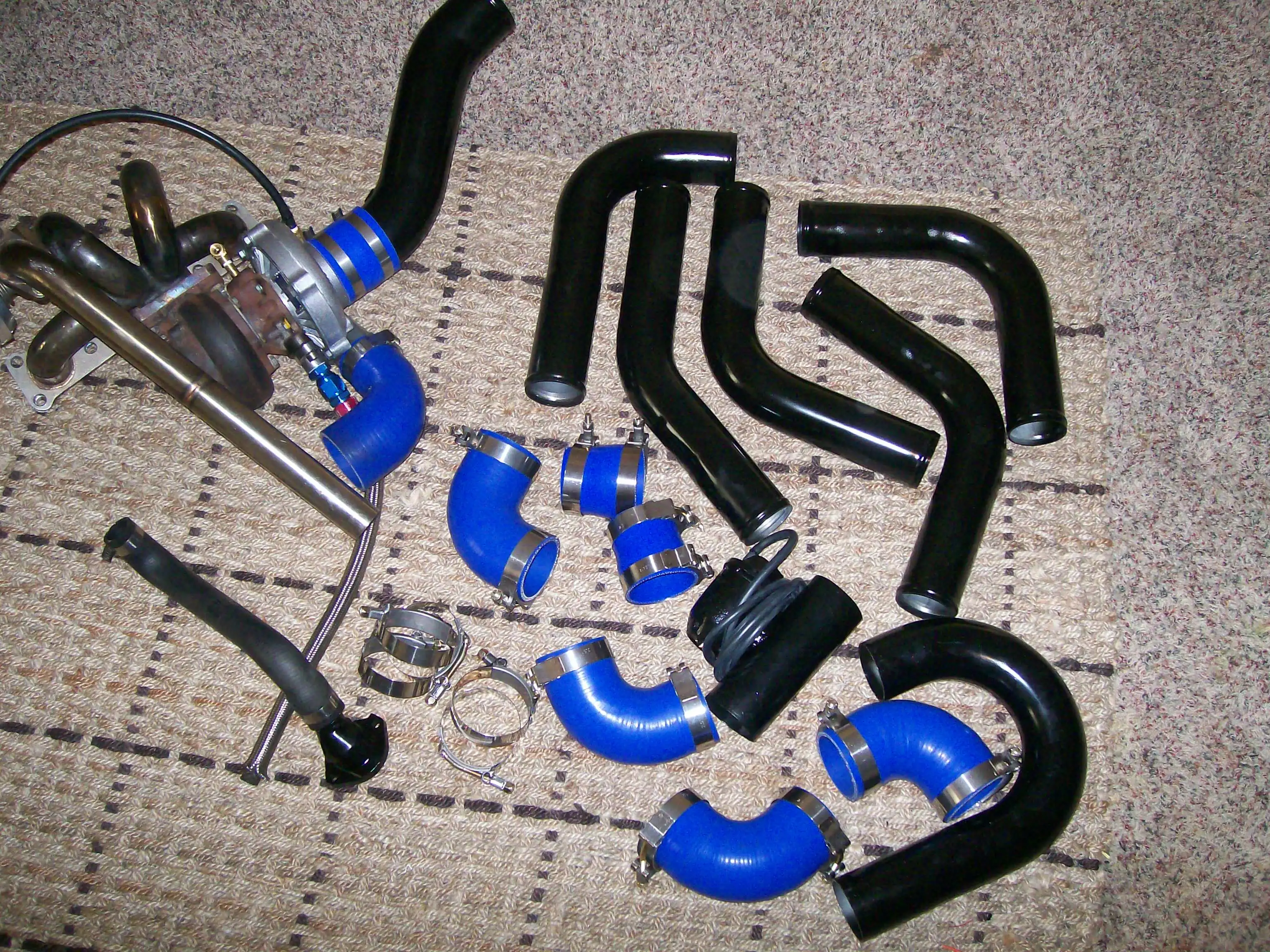

well i've finally bought all the pieces i need for a complete turbo kit.

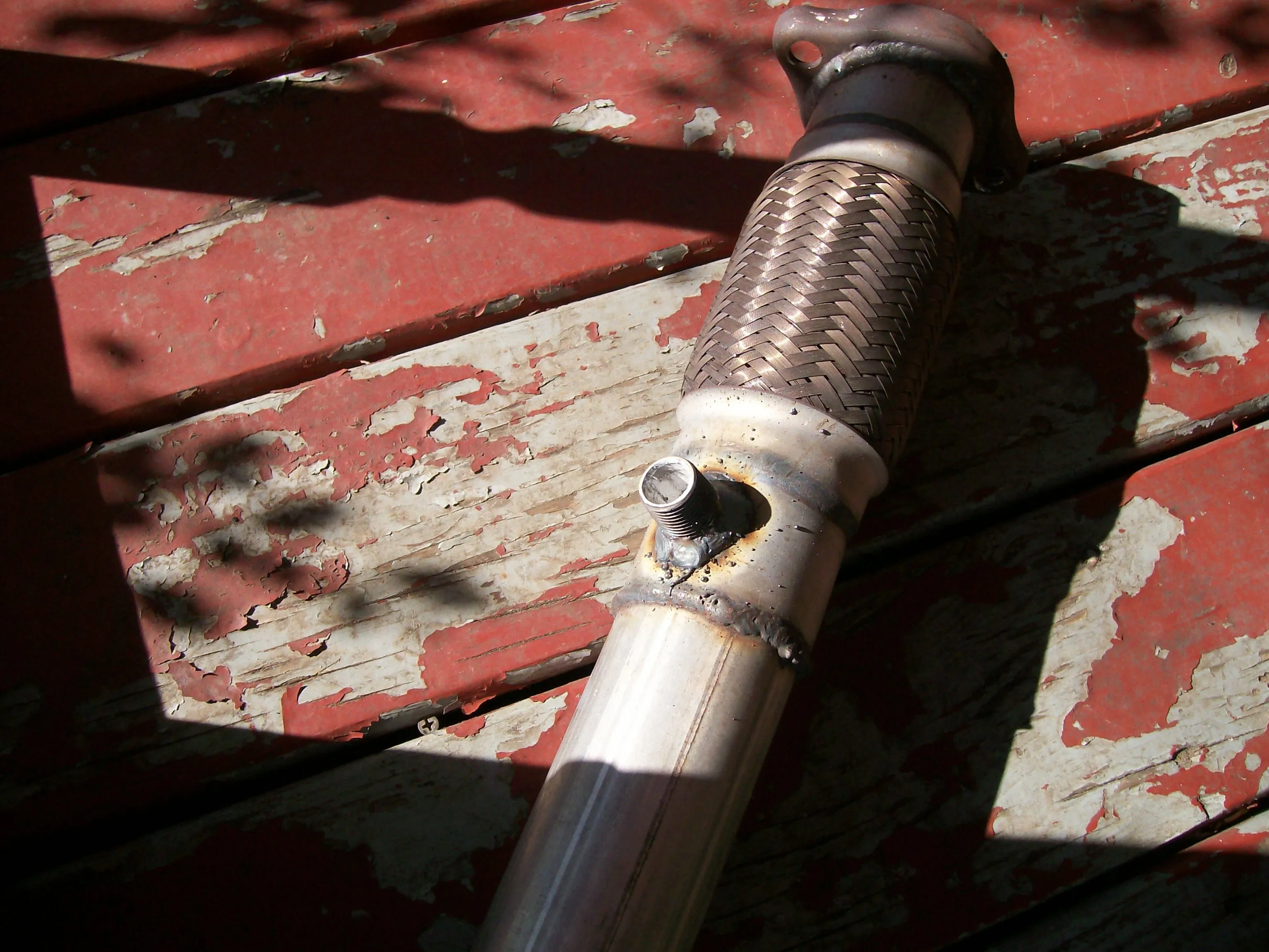

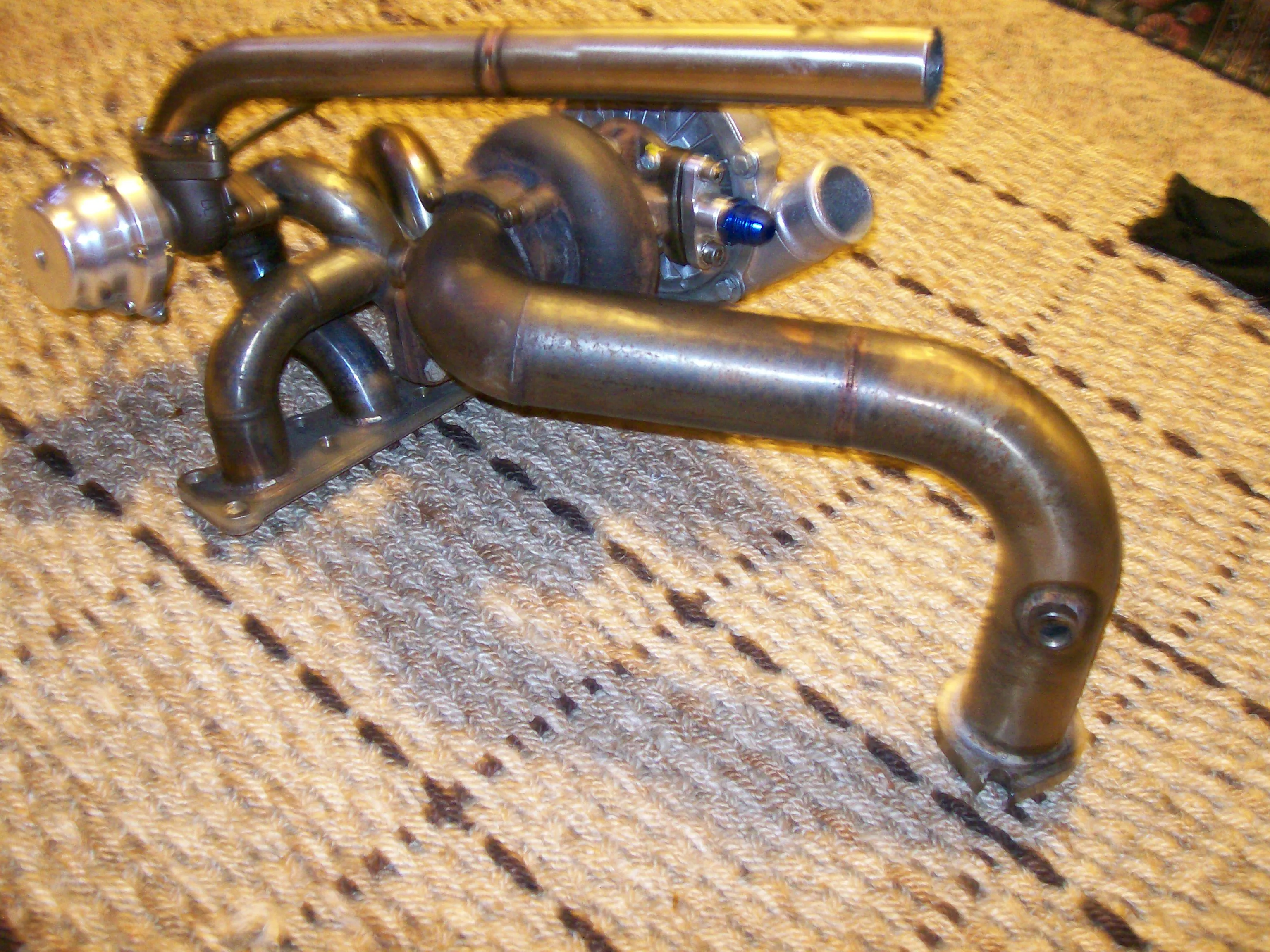

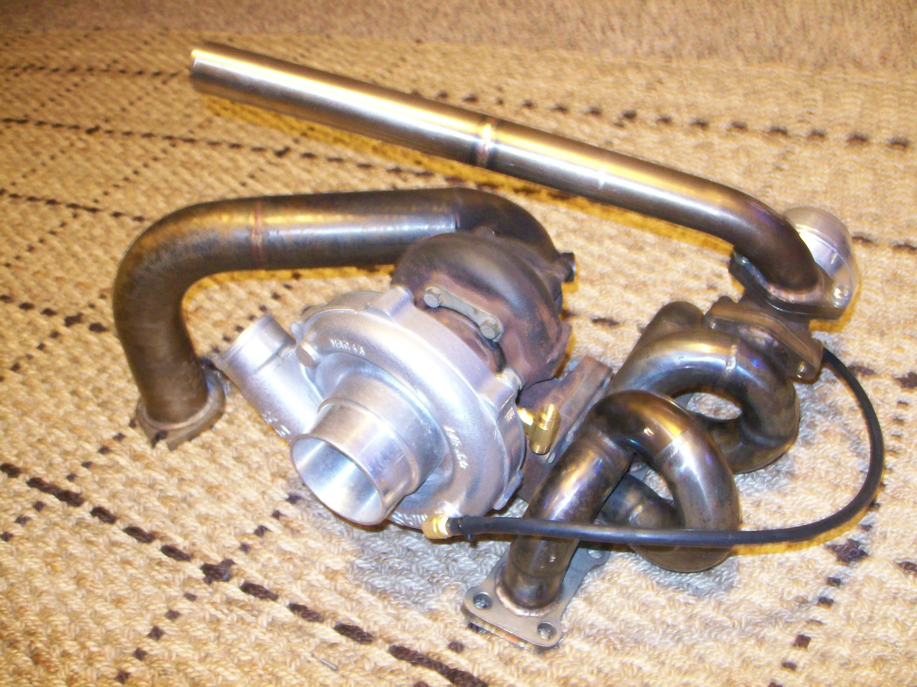

Exhaust Section:
Obx T3 manifold
Tial 38m Wastegate with 5.8 psi spring
Custom open dump tube
Master Power .50 trim
Custom 2.5 inch downpipe
2.5 inch Catless SLS midpipe
2.4 inch Corksport Axleback
Corrugated egr line ran off of the midpipe

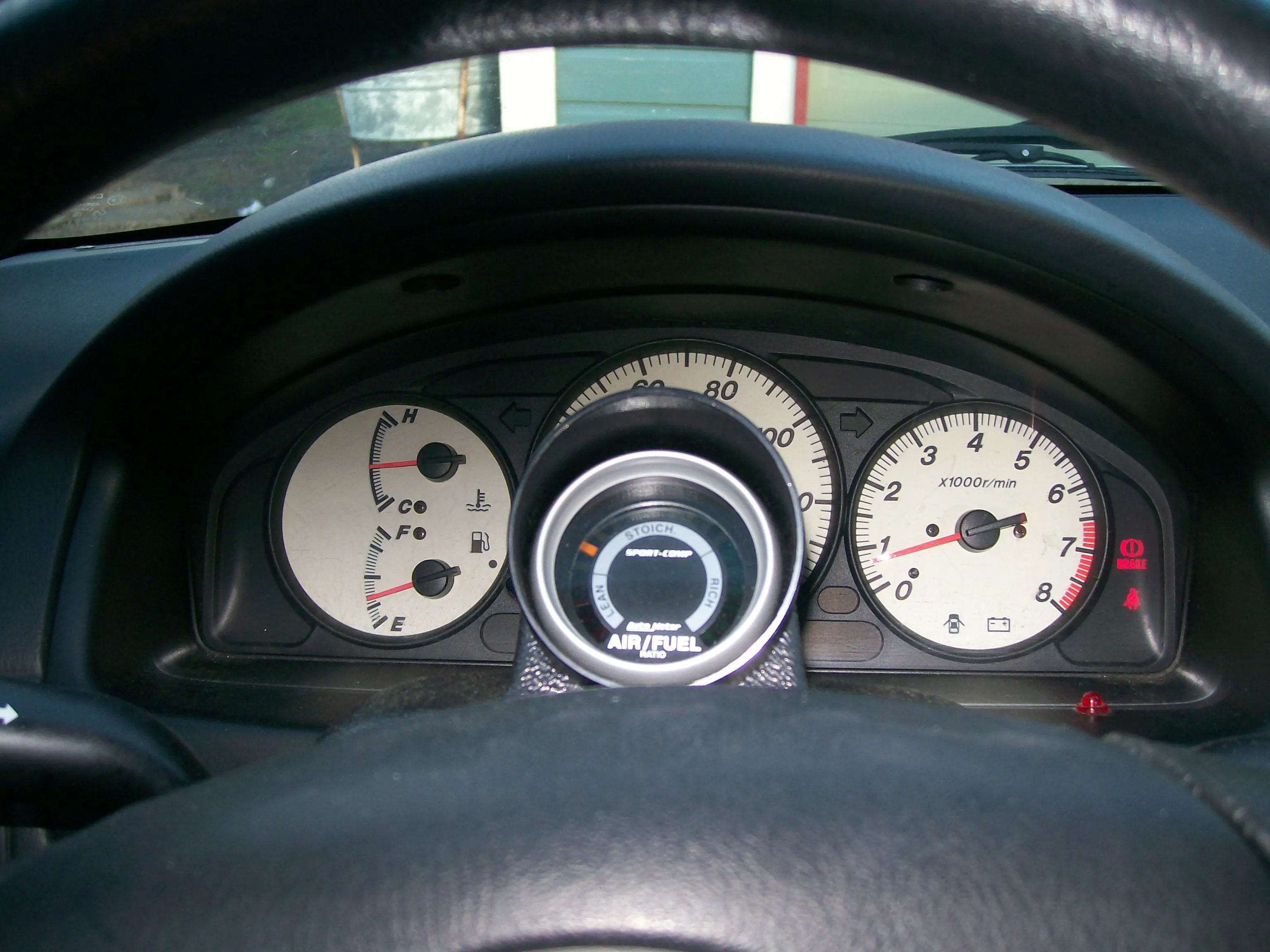

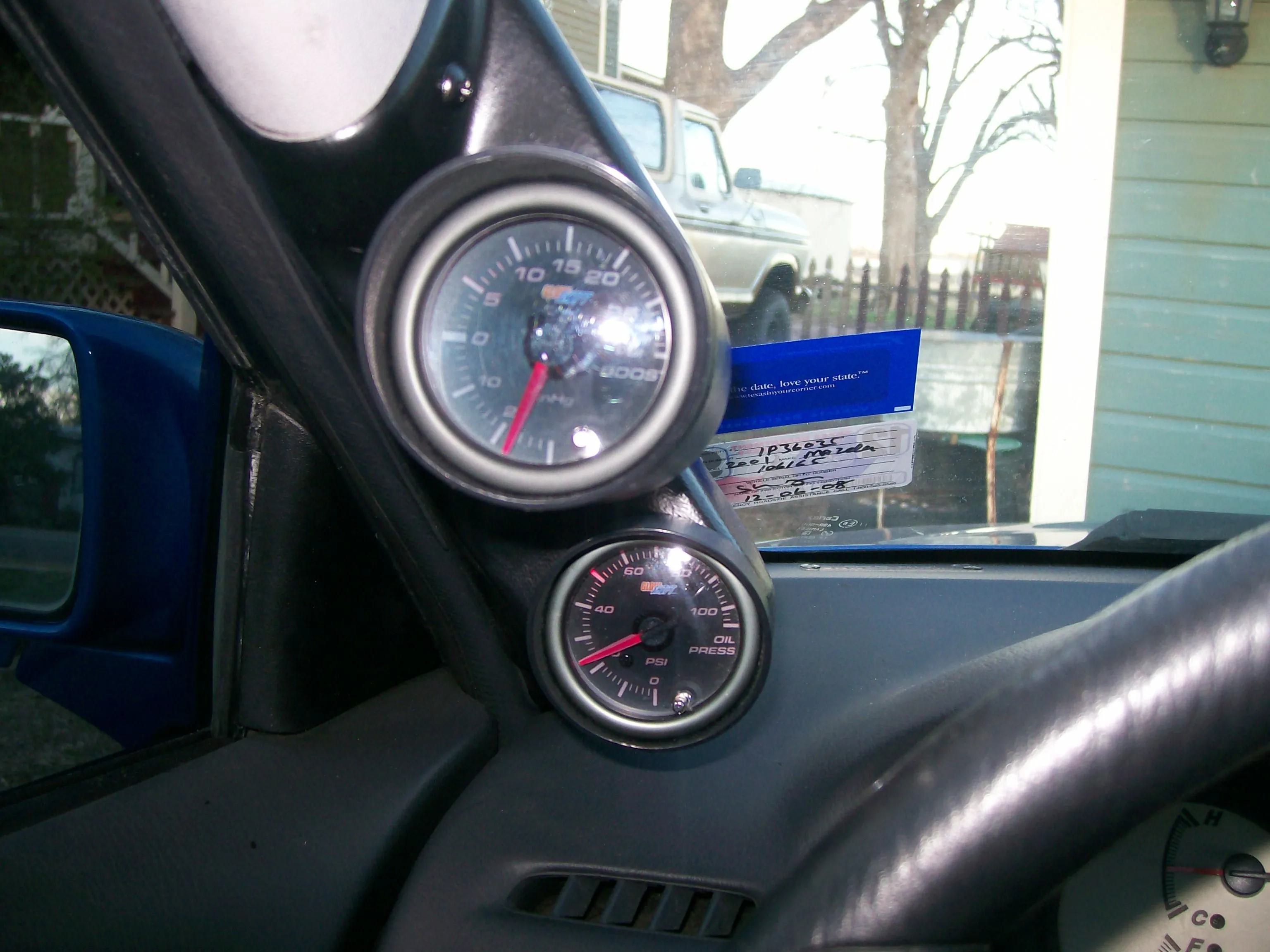

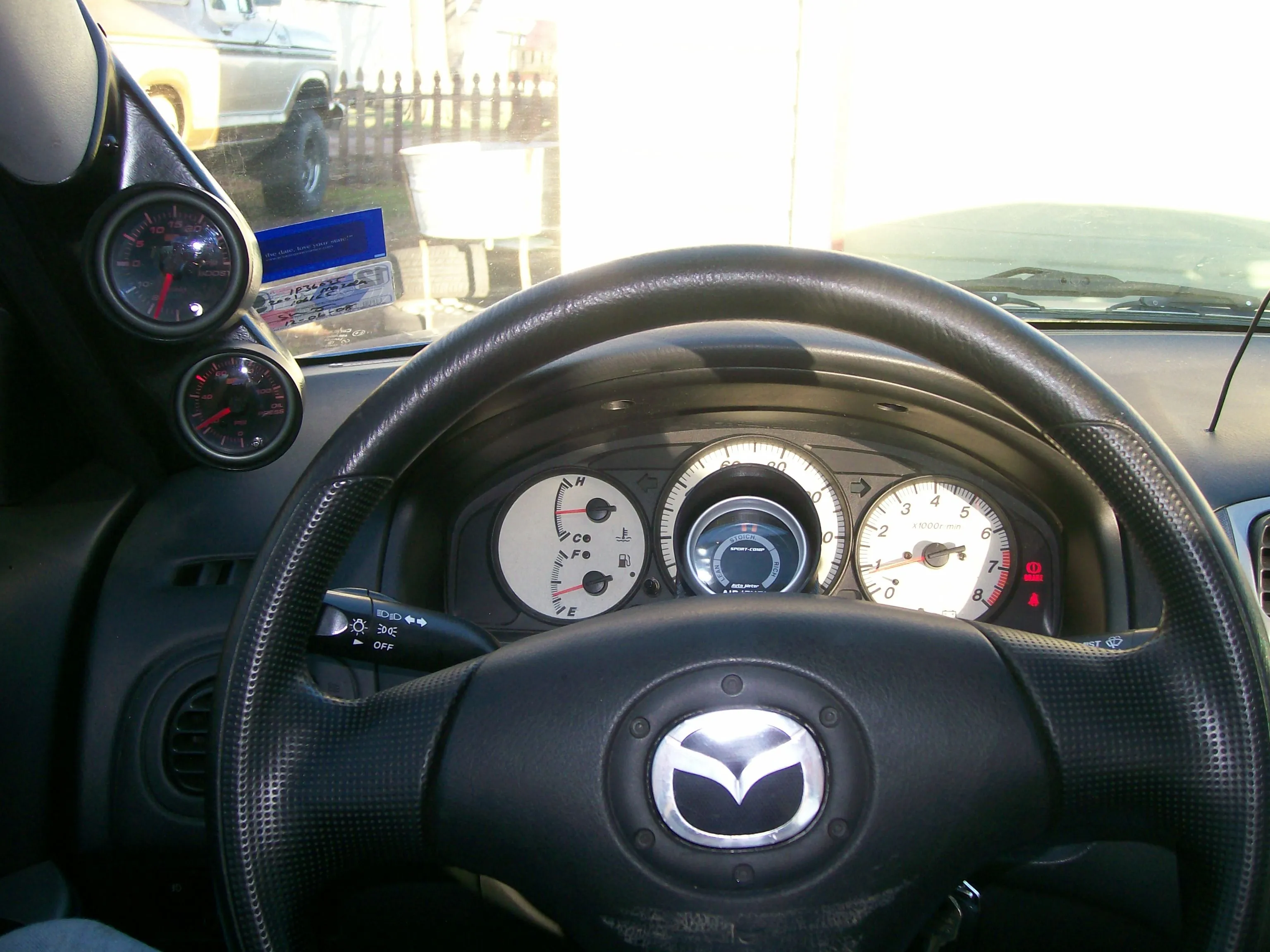

Gauges/Other:
Glowshift Electronic Oil pressure Gauge
Glowshift Manual Boost/Vacuum Gauge
Autometer Narrowband AFR Gauge
Dual A pillar Pod
FF Steering Wheel Pod

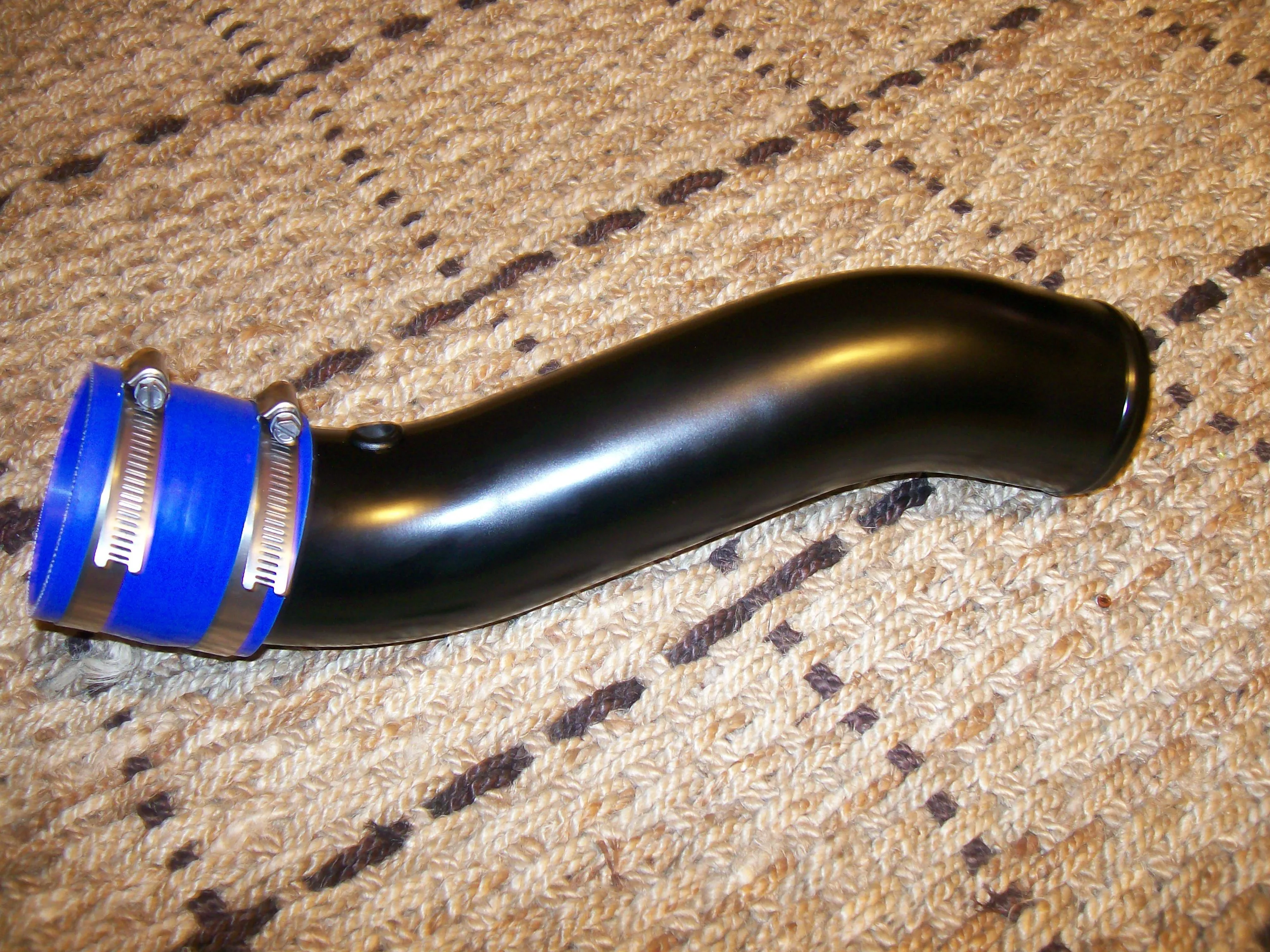

Intake/Cooling:

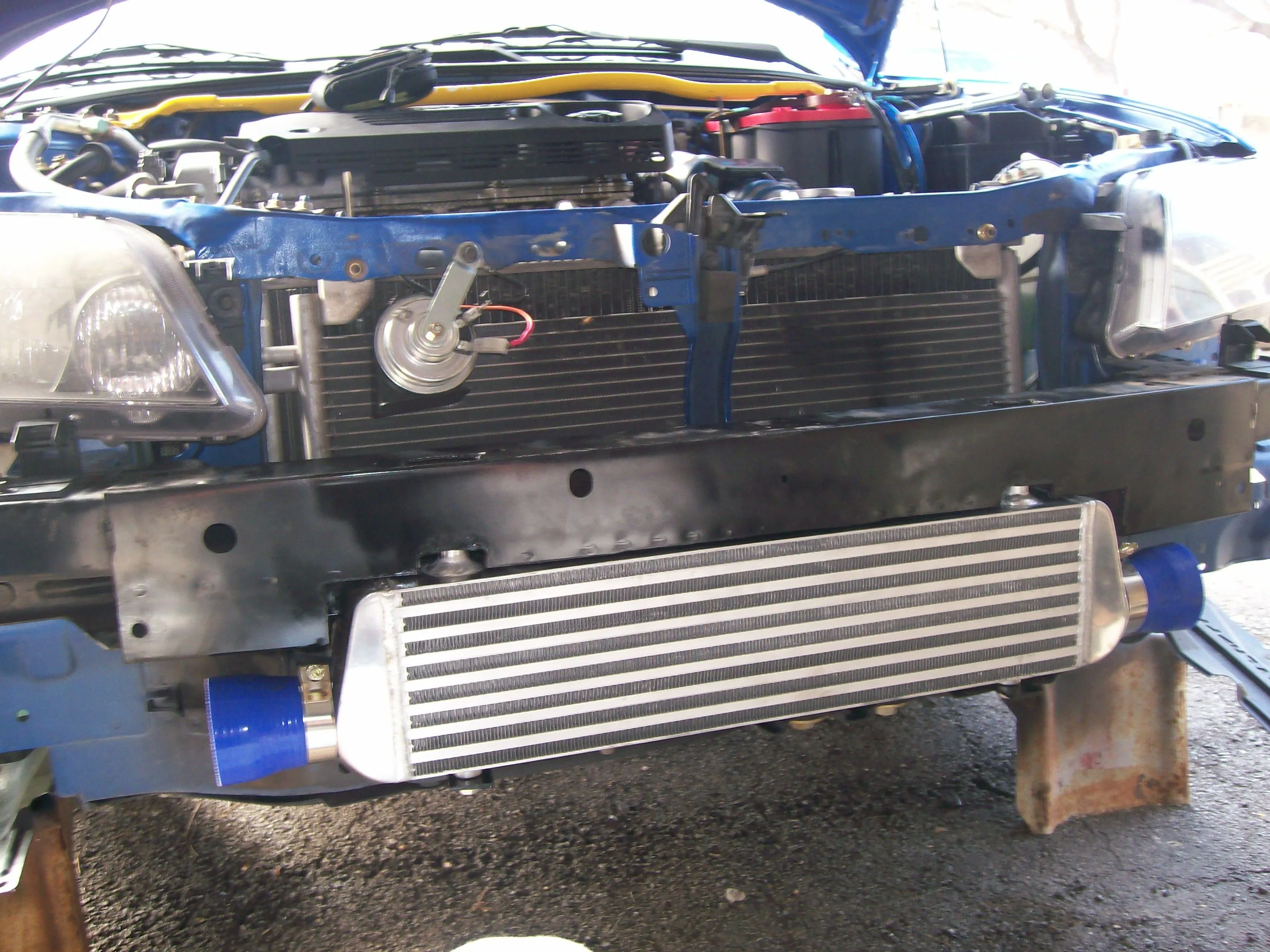

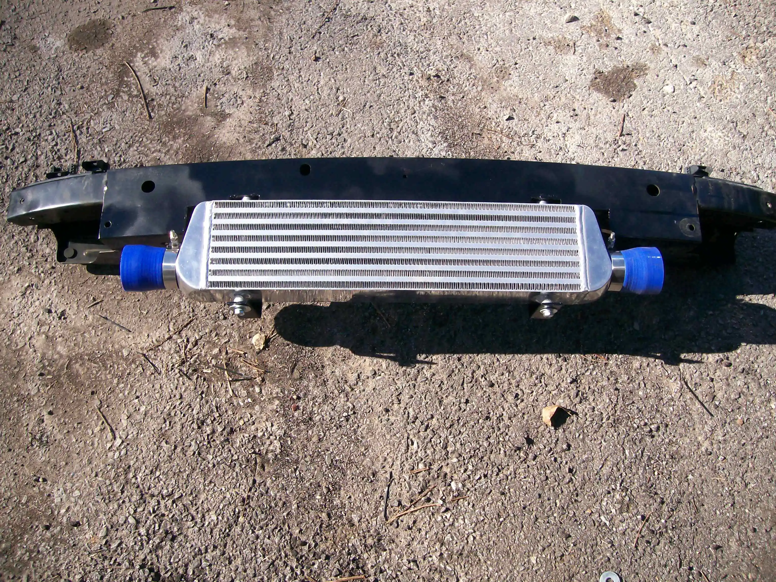

Altered Customs FMIC Kit
626 manifold, gasket matched and ported
nsn thermal spacer
Black piping w/ blue couplers
Custom SRI
HKS SSQV BOV

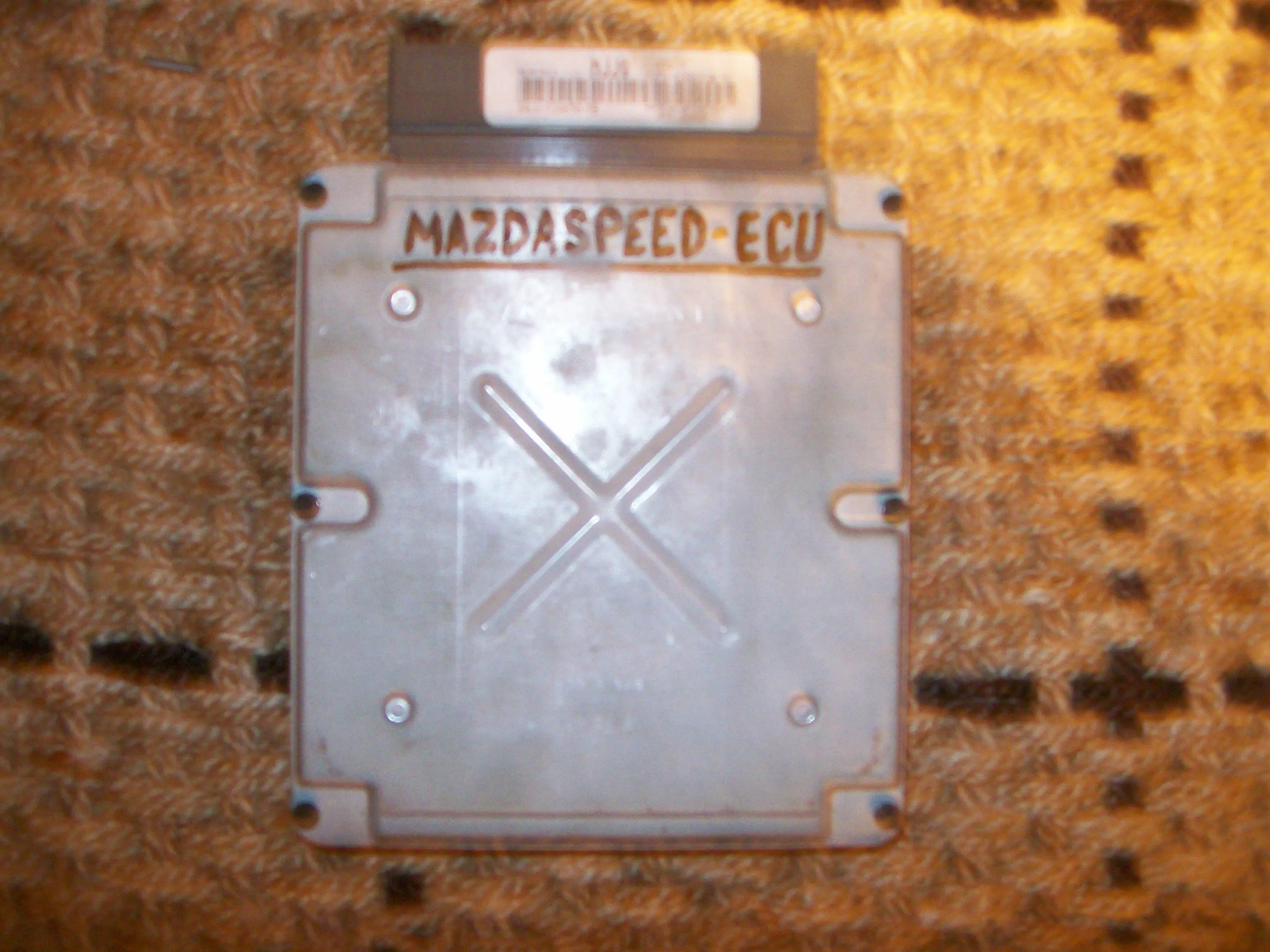

Electronics:
MSP ECU
Split Second AFC V.2
VTCS CEL fix
The guages are already installed, as is the tapped oil pan, feed line, midpipe, axleback, and CEL fix. The fmic comes in tuesday.

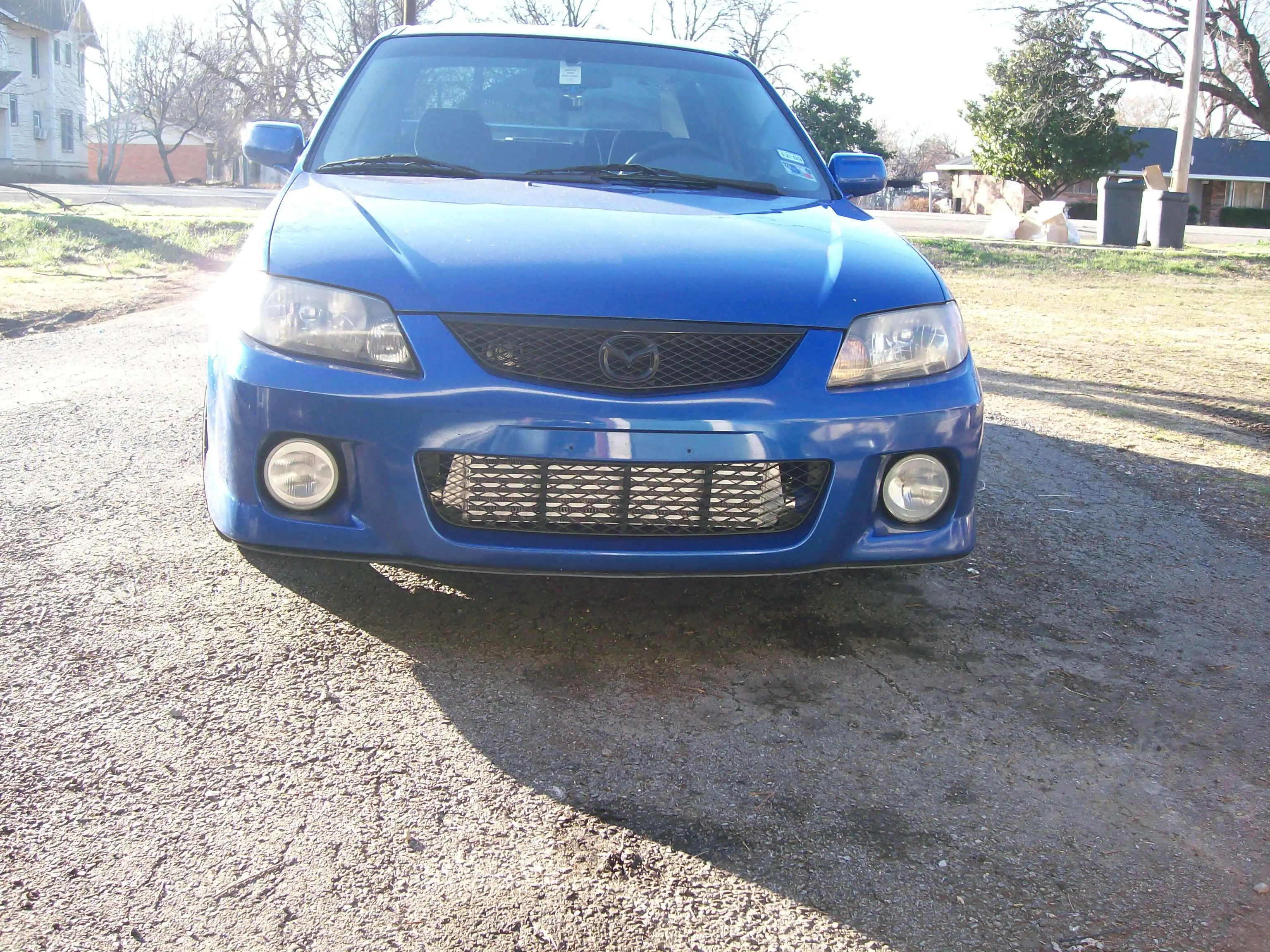

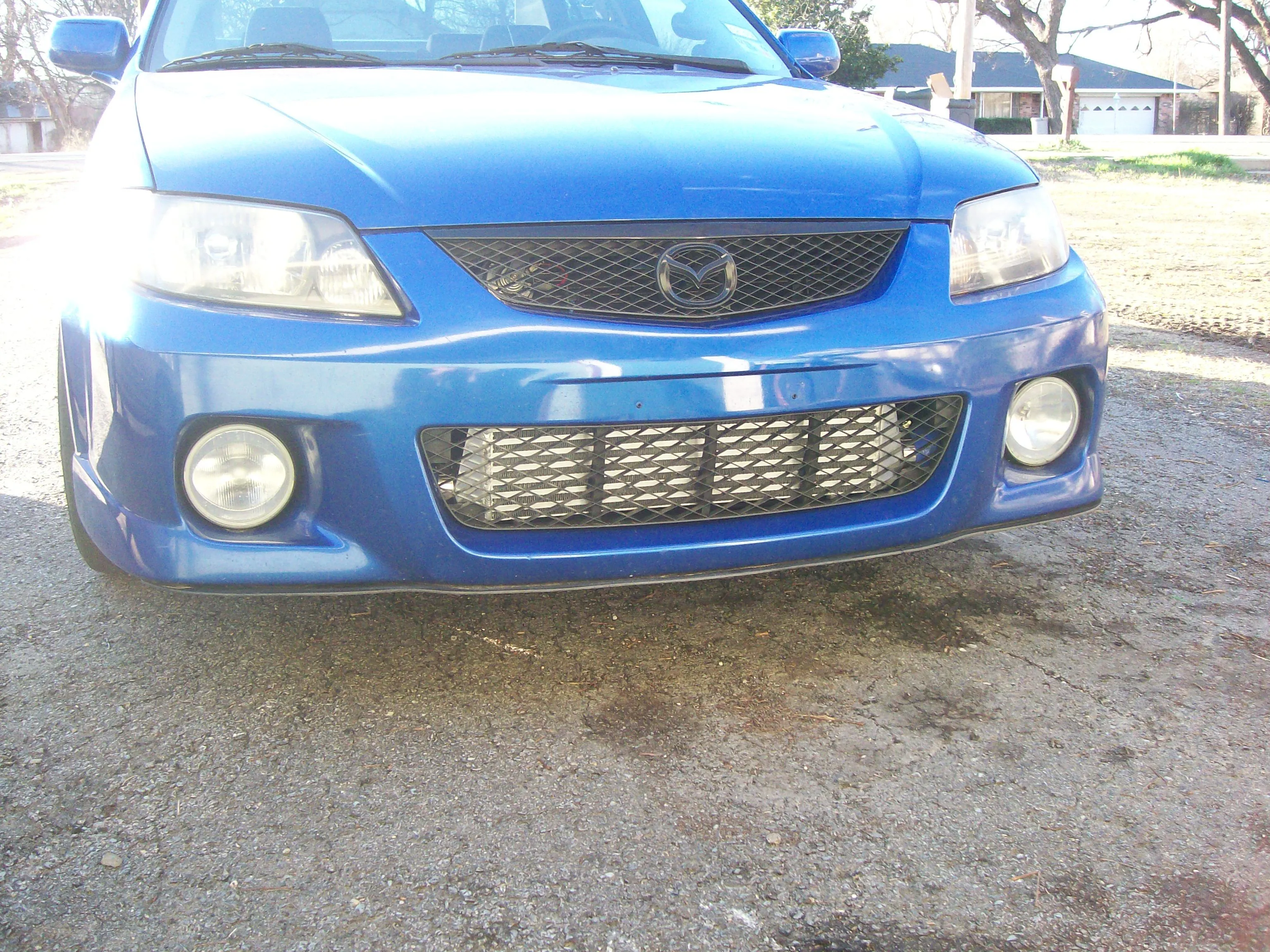

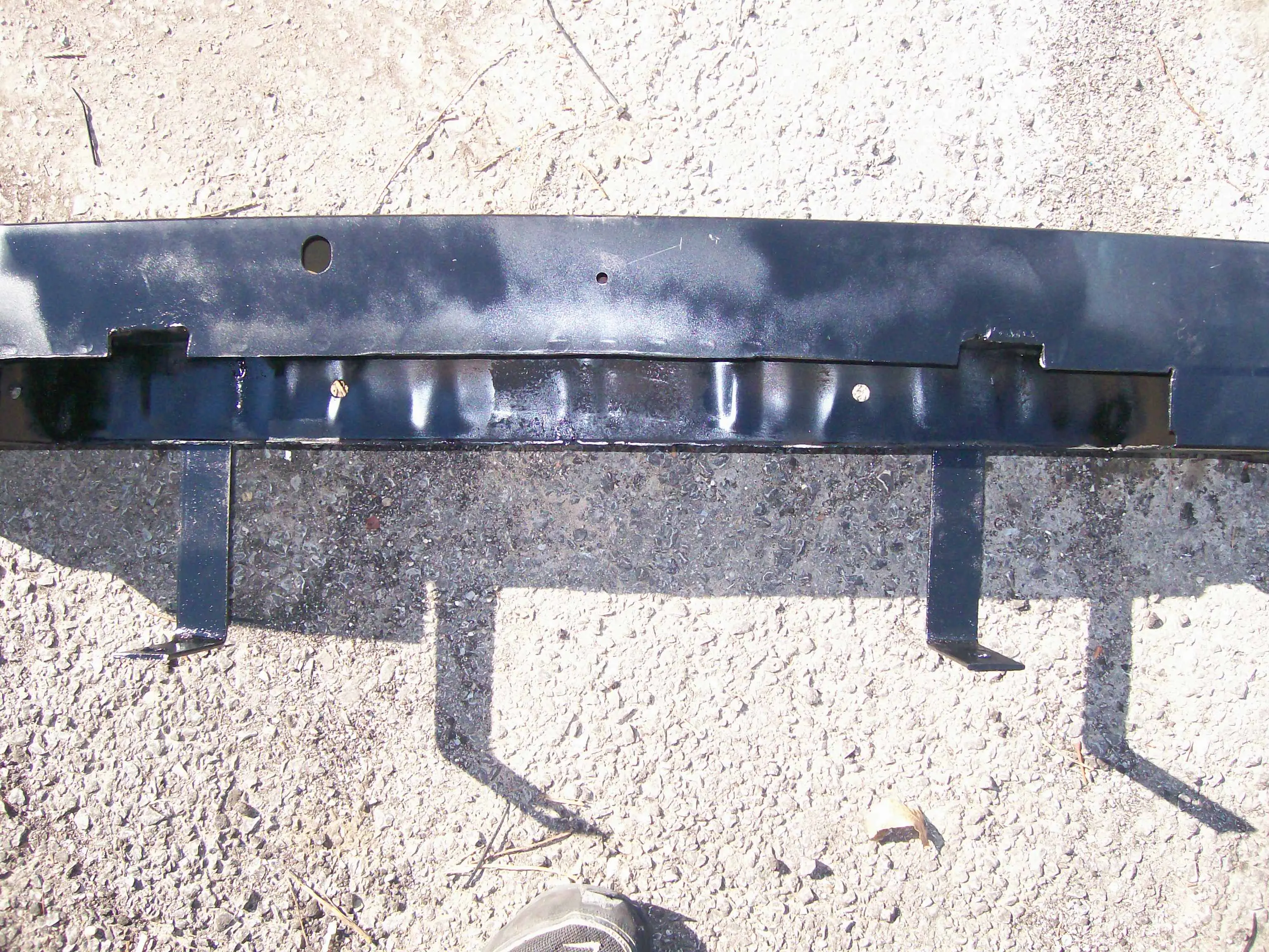

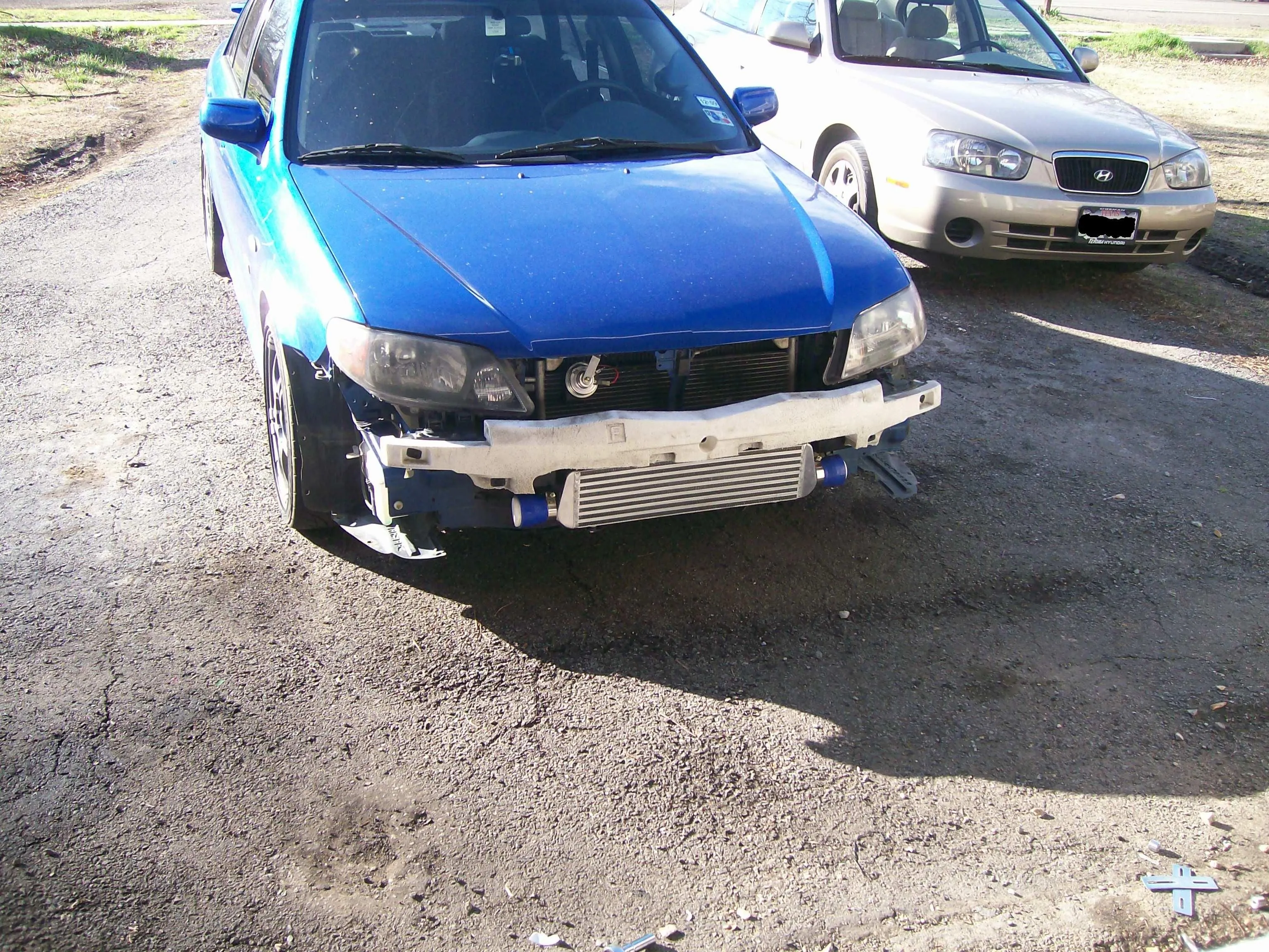

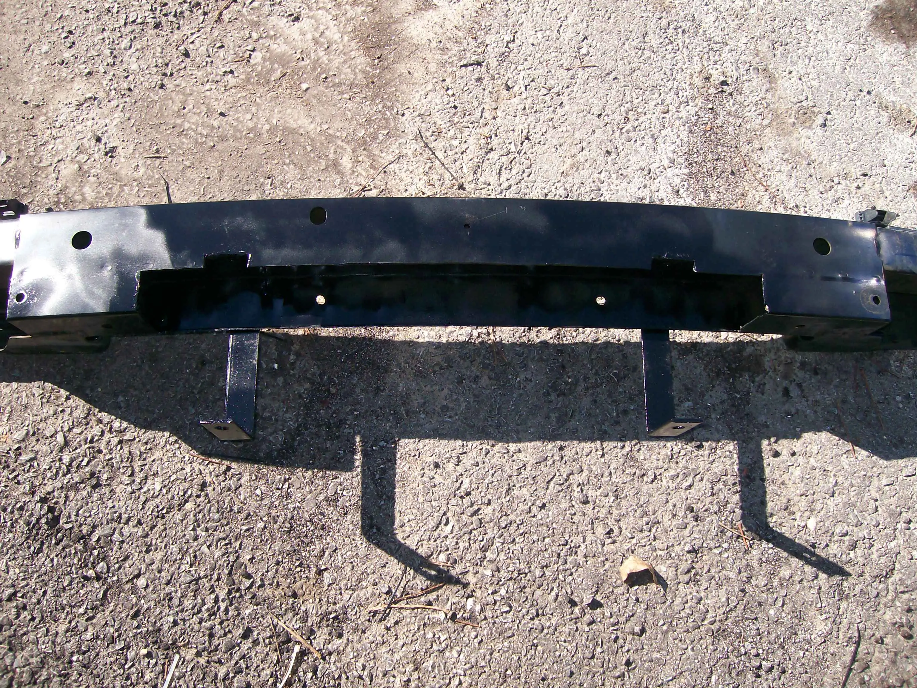

got the FMIC in the mail, the front bumper and midpipe are off and the bumper beam will be cut and fitted for the FMIC tomorrow, and the nipple for the egr will be welded onto the midpipe...

Damn..... Lookin nice! Thinkn about tearin mine back down and cutting my bumper brace after all........ Nice Job man!! (cool)
