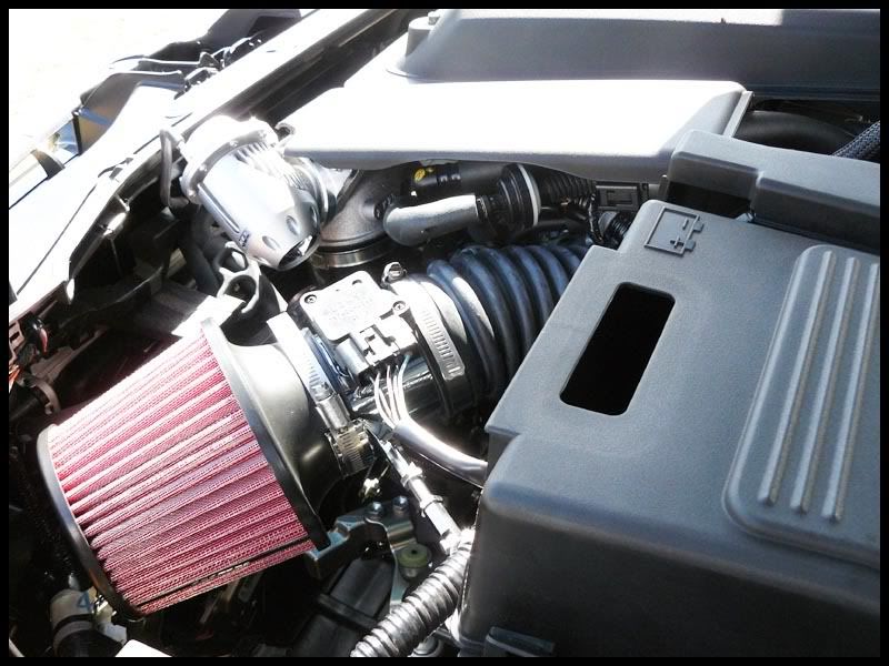

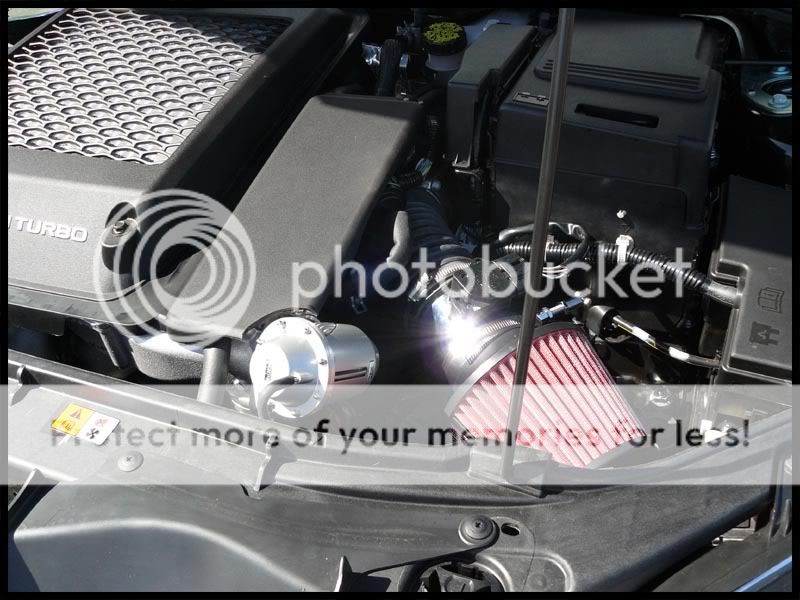

Thanks redspeed. Here's my short-ram set up:
^^It's working out great. I'll be replacing the rubber hose with alum piping some time this week. Thanks man.
^^It actually feels a lot better than stock (seems to pull harder). I love the sound. After i replace the rubber hose with the alum piping, it'll hang down much further, not as far as standard CAI's (deathly afraid of hydrolocking) but farther from the heat.
Edited the original post. Made some changes to the cai to move the filter up for some protection against hydrolock. Still trying to get some dyno numbers. Apparently the shop closed or moved.
Inspired by Red, I decided to make my own custom SRI for fun (I can't stop playing with this car, it's great). I realize there may be next to no gains with it, but it was fun to install and only cost me $40. Pictures to come soon.

It's still around $90. I didn't bought additional parts, just switched around the 6in. pipe the run down from the maf, and put it on the filter. The 4in. pipe that was on the filter, was put in place of the 6in. pipe. The result was that the filter moved up about 4 in.
