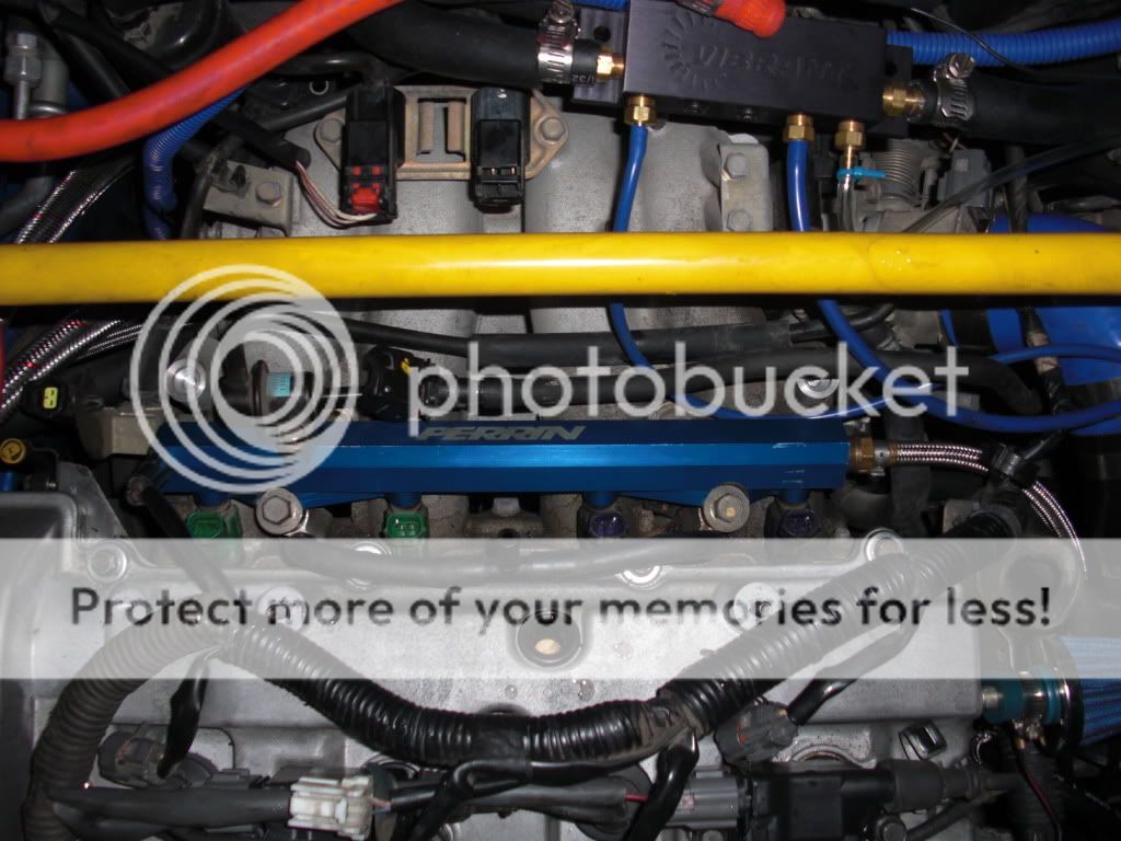

New treat on the car...Love putting things on that are easy

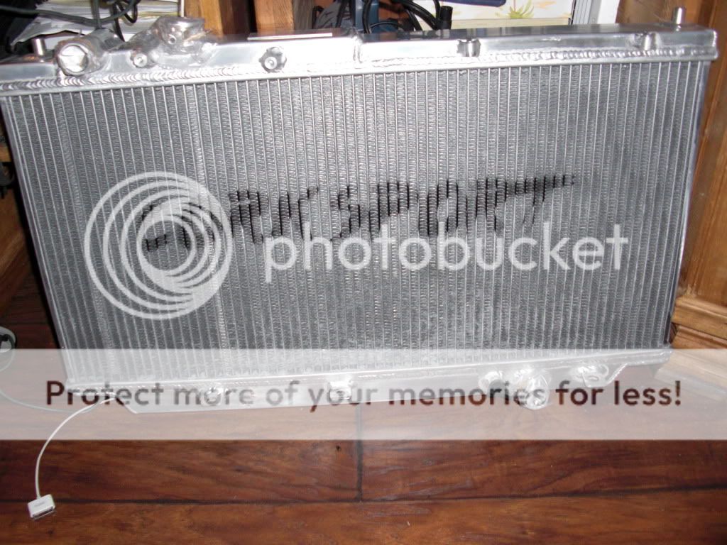

Fixed the idle problem and no boiling coolant(cabpatch)

where'd you score the Perrin fuel rail? they don't make them anymore right?
Nope not anymore, I snaged it off of blkonblkMSP from here on the forum

Edit: The boiling coolant also stopped after changing the water pump and the timing was pretty bad when I opened it all up so that was probably one of the causes I'm guessing. Capping all the vac leaks helped out too

+1, i picked one of those up because my coolant was bubbling too. cured it and it looks super clean. thats interesting doing the timing stuff fixed your idle problem.. i have the same issues with my idle that you were having.
car is coming along great, fuel rail looks awesome.
