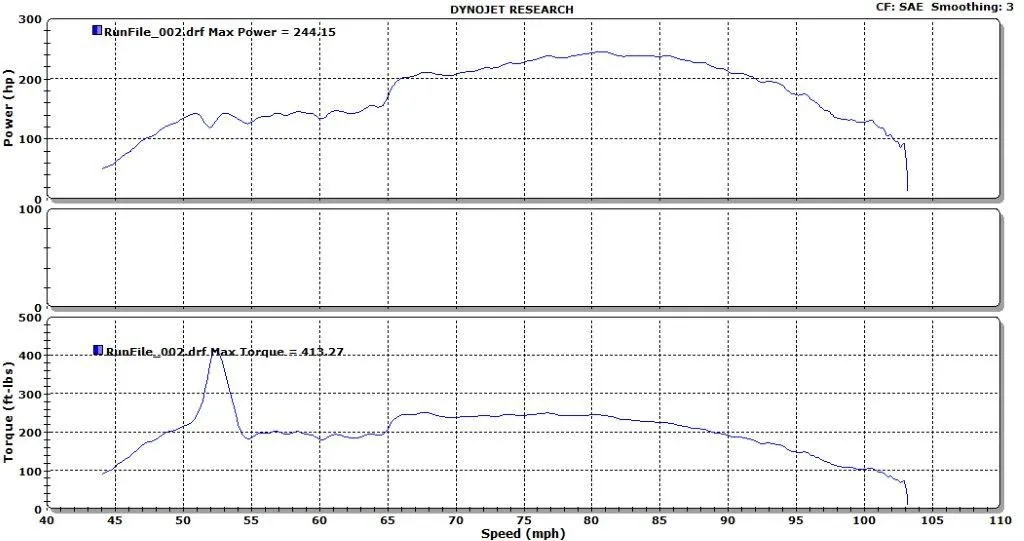

413 ft-lbs of Torque! Most for just bolt-ons!
Pretty awesome, hunh?

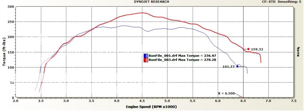

Alright, that's just a fluke that I noticed when I accidently left the bottom axis on Speed instead of engine Speed. The second graph shows a more legitimate result with the red lines being a stock baseline I had done awhile ago and the blue lines being a dyno I had done the other day with the Nano and a mid-pipe. I am not happy with the way the AFRs tanked on these dynoes and don't know if they are truly representative.

And Now the Stock Dyno!!
HORSEPOWER GRAPH:
RPM-----Stock Power-----Tuned Power-----Gains
4.0k--------178.6------------199.5---------20.9
4.5k--------194.7------------238.4---------43.7
5.0k--------214.7------------246.9---------32.2
5.5k--------235.8------------253-----------17.2
6.0k--------186.1------------240.5---------54.4
6.5k--------125.9------------197.1---------67.2
TORQUE GRAPH:
RPM-----Stock Torque-----Tuned Torque-----Gains
4.0k--------231.9-------------261.7----------29.8
4.5k--------227.3-------------278.2----------50.9
5.0k--------225.6-------------259.3----------33.7
5.5k--------225.2-------------241.6----------16.4
6.0k--------162.9-------------210.5----------47.6
6.5k--------101.7-------------159.3----------57.6

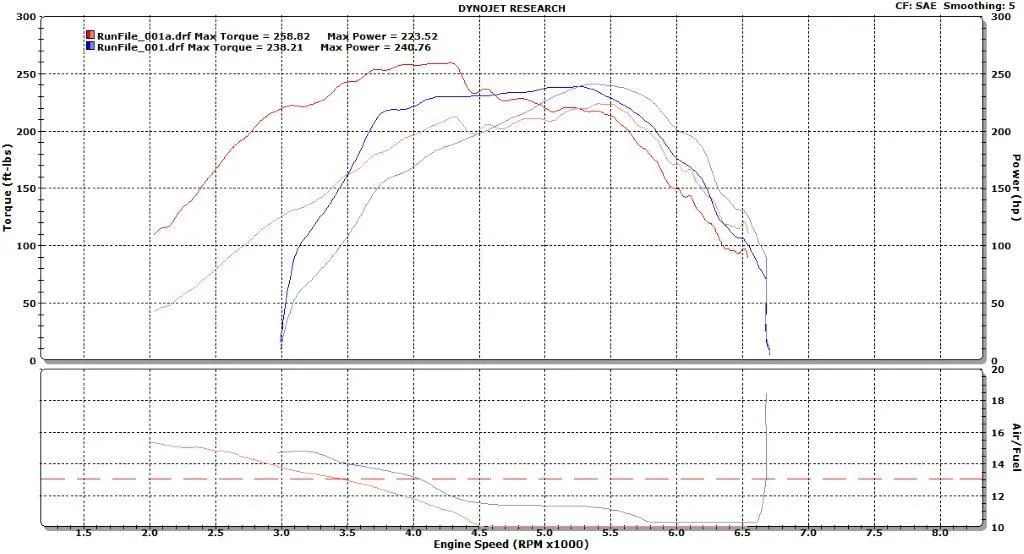

I just got my Dyno done yesterday. 1st Pull was stock except with COBB SF Intake, 2nd pull was with new parts installed : Desno ITV22 plugs, TXS RB & DP combo, COBB TIP, and AP Stage 1+SF 91. Is it odd that i reach peak HP near 4500 RPM and stays there till about 6500? I have large noticeable gains across the mid band but peak is only about 5hp gain. Also, does the torque curve look normal, i have huge gains across the mid band but tapers off pretty early? For stock (relatively) on the first dyno I had allot more power than I thought i did. Thanks guys for all input and feedback!
