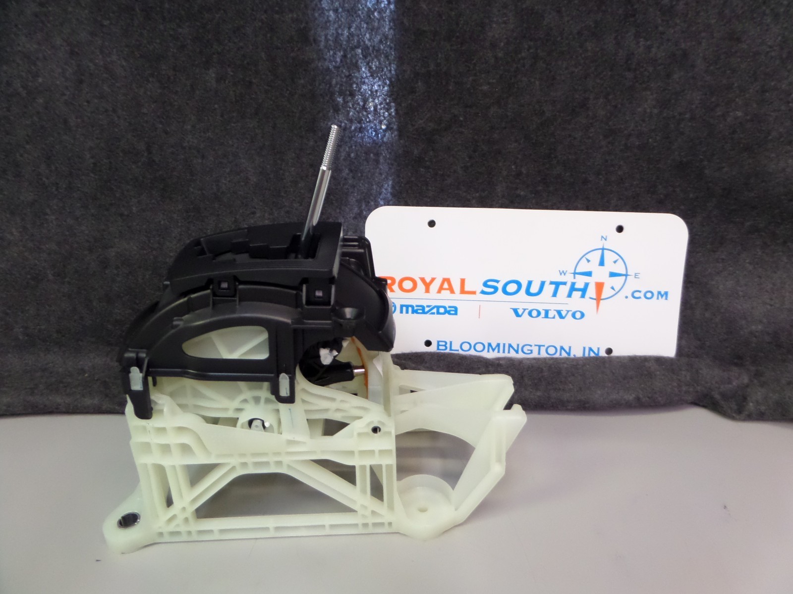

Looking through some old threads this shifter change may have occurred on the late '14s. The schematic above may have an old reference picture but actually be the new part.
Just speculation but there might a chance that replacing just parts 3/4/5 might be possible. Not sure on the new version if moving is just restricted by the plastics. The manual area of gates looks the same. Notice the gated piece just snaps off the top.
Hi Thank-you so much, if I only have to change 3/4/5 that will be awesome, $20 for parts and now i have to find guy who can do this thing for me, i will ask Mazda Dealer about that
No problem..remember... just speculation so try to confirm with someone in parts before ordering.

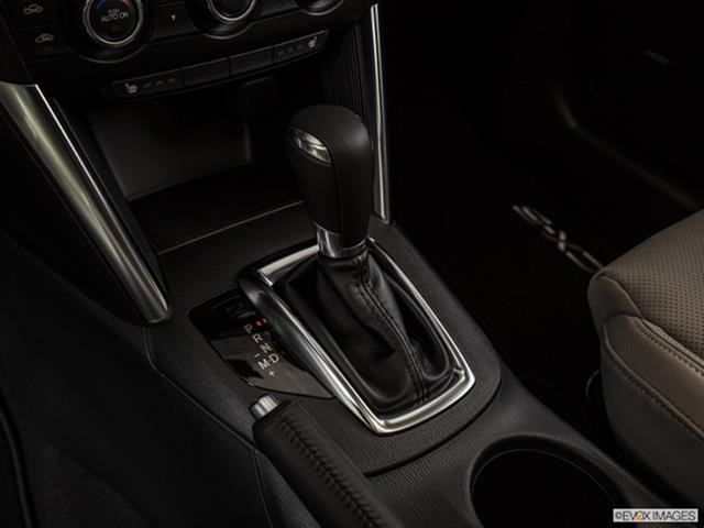

I had a 2013 CX5, and now a 2015. I can't even remember what the shifter was like on the '13, so apparently it didn't bother me. Maybe a posted picture of a '13 would remind me.
