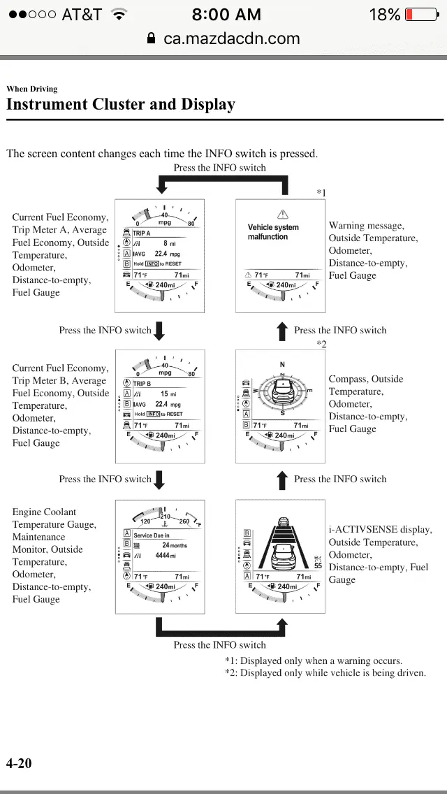

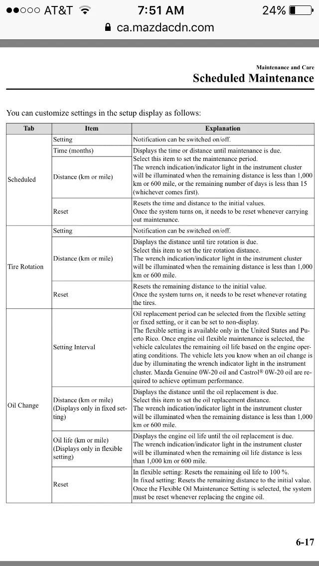

Make sure to turn on your oil life monitor by setting up your "Oil Change" maintenance schedule to "Flexible"
YRW - I've changed it to Flexible but the gauge still says 'service interval' (or something similar) at 6k miles. Is it supposed to say 'oil life remaining' on this gauge?
For 2017 CX-5 the instrument cluster display and Maintenance Monitor are different from my 2016's. Your Maintenance Monitor view in instrument cluster is displaying the "Scheduled" setting from Maintenance Monitor, not the "Oil Change" setting.

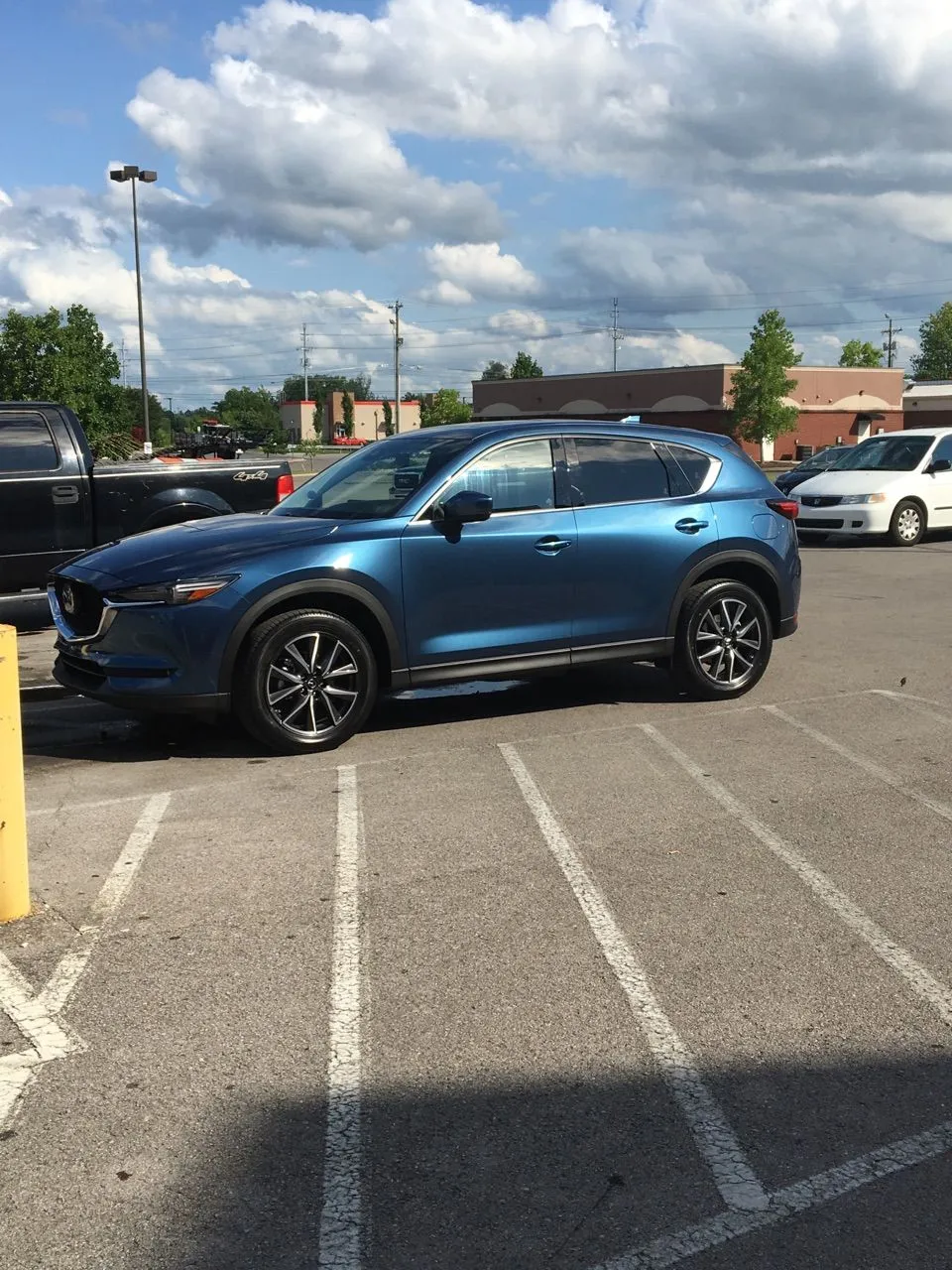

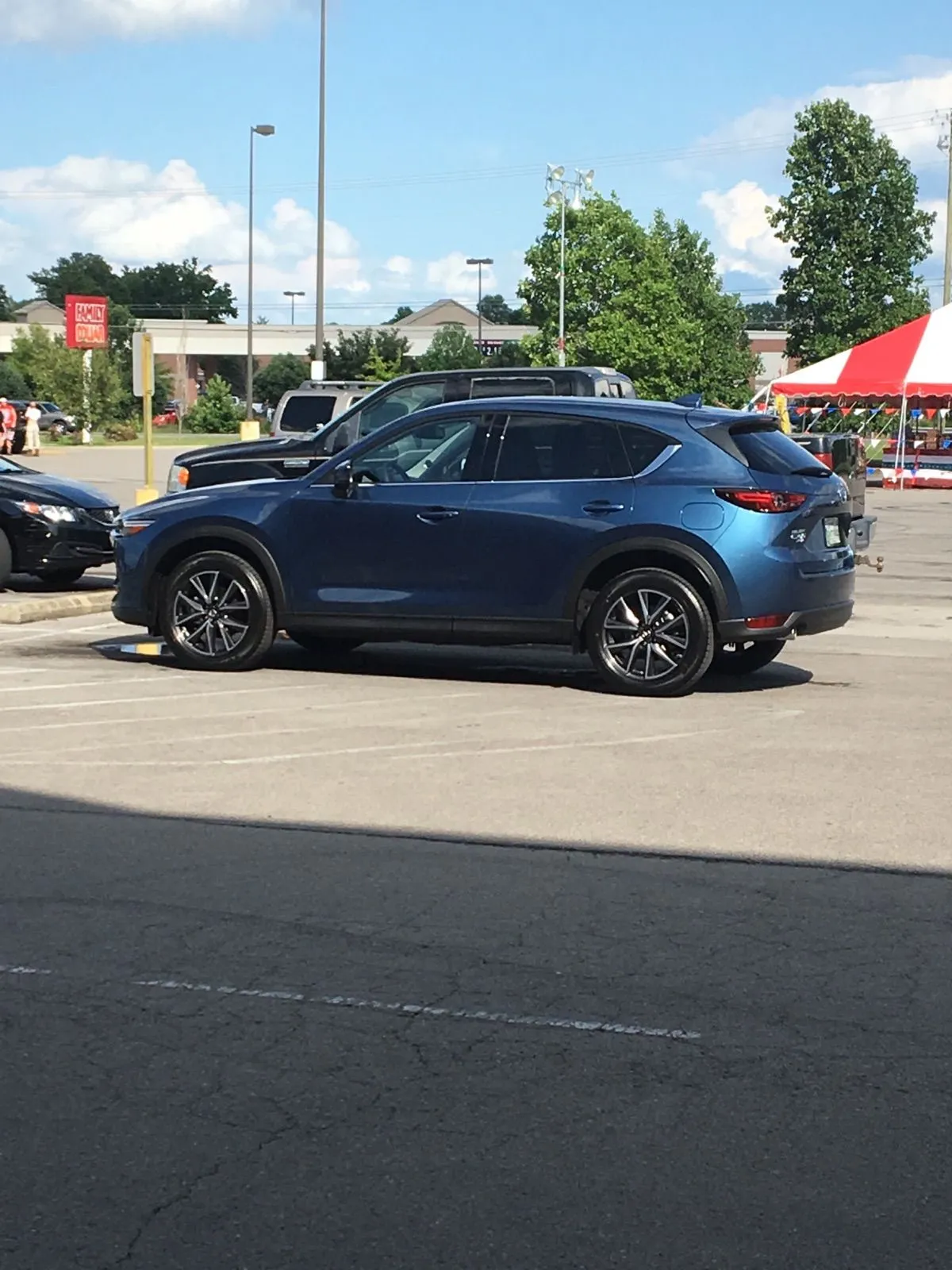

Picked it up Friday. Traded in my '14 V6 6MT Accord Coupe.
Love the car and the color - it looks so much better in person than in color guide. Dealer threw in illuminated door sills, all weather floor mats, chrome bumper protector, and fancy valve stem caps. We had planned on waiting until y/e but he gave a such great price on my trade that I basically got what I would have sold it for privately which was effectively retail with the tax effect. He also gave 20% off on the rubber cargo mat and retractable cargo cover. We thought we wanted the roof rails since our friends just installed them on their new Silver CX5 and they looked great. The dealer set them on top of our car so my wife could see what it looked like but it seemed a bit too blingy with the Eternal Blue so we didn't get it.
We like everything about the car - looks, fit and finish, quietness, and ride quality. It rides smoother than my Honda which had 18" wheels. The power is fine except when you hit a steep hill it struggles slightly but it's more than adequate.
I checked the oil level today and it was down maybe 1/8th on dipstick so I topped off with M1 0W-20. It had 62 miles when we bought it and has 282 now. Am hoping the factory just didn't top it off as I'm not aware of oil consumption on these engines? Will keep an eye on it though.
This is our 8th Mazda and all them have been trouble free so we are hoping this will keep up the tradition!
Will post pics soon..
Here they are:
View attachment 217028View attachment 217029

Nice! It seems you didn't get front license plate bracket installed on your new CX-5? It looks much cleaner without front license plate I guess it's not required in Tennessee. Don't know what would the next owner do without the bracket if he's from the state requires front plate?
I was curious about this as well when I checked after yrwei52's suggestion -- mine was already on Flexible and says 7000. I do have fewer miles than you (maybe 80ish?). Maybe the number typically goes down after driving it a bit.
The display for Flexible Oil Change Interval from Maintenance Monitor on 2016(.5) CX-5 is showing how much the "%" of the oil life left, but for 2017 it's showing how much the mileage of the oil life left. Flexible OCI is up to the maximum of 12 months / 7,500 miles whichever comes first for 2017 (12 months / 10,000 miles for 2016(.5)), so each time you reset the Flexible OCI, it'll go back to 7,500 miles. Since you've been driving your new CX-5 for about 80 miles, the oil life goes down from 7,500 miles to 7,000 miles left. The mileage of oil life is not only related to how many actual miles you've been driven but also added other factors such as short drives or stop-and-go traffic to further reduce the oil life on mileage. If you have a 2016 CX-5, driving 80 miles won't change anything and it'd still show 100%. They definitely have different way of calculation between the two.
If it is like the previous CX-5, it gets screwed right to the front bumper. There are already dimples to guide the bumper piercer...
Correct, and they've included the front plate holder as well.
So Mazda does give you the front plate bracket / holder just in case someone else needs it. At least your dealer didn't drill holes to install the plate bracket / holder like dealers here in Texas.
