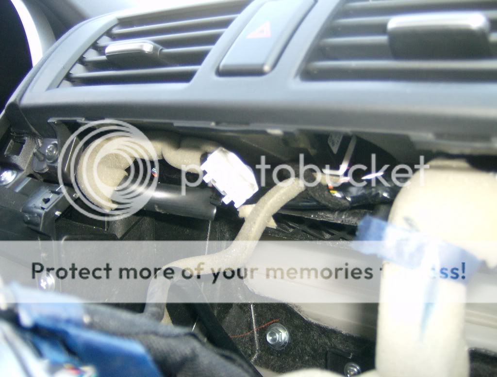

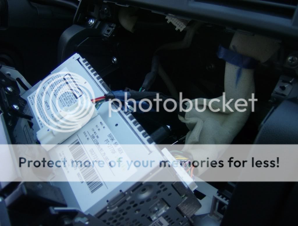

^^ on that last pic, the place you have circled is where my Sirius was plugged in. My cd changer, I believe, branched off from the main harness and plugged into a clip directly behind the lcd screen...
I think this is the six cd-changer bracket

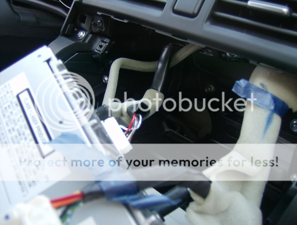

This is the Aux clip that the Sirius was plugged into,
My Aux cable was stuck up on top of the HU, ziptied to itself and a larger bundle of wires,

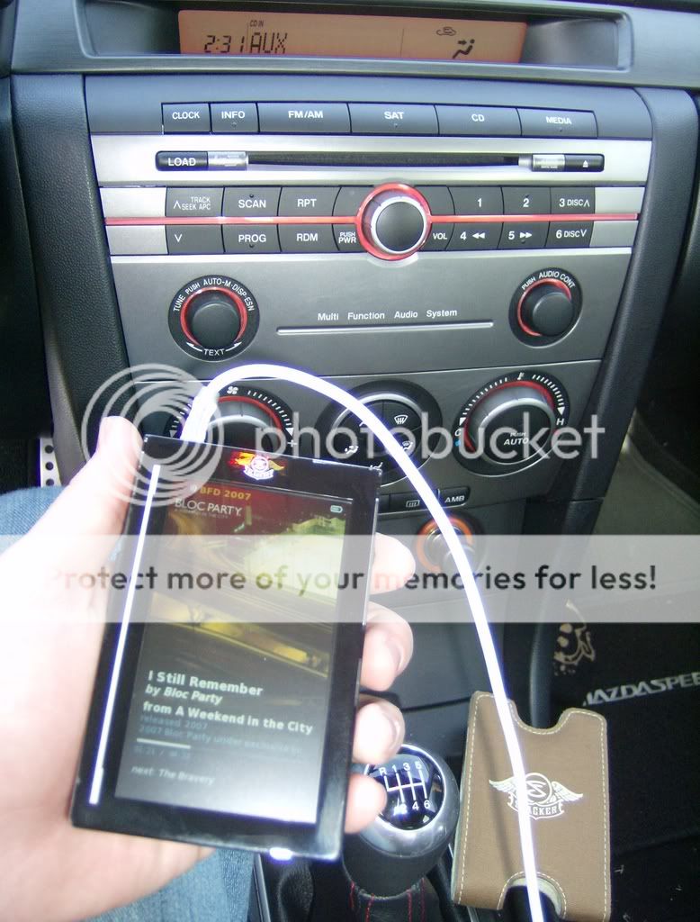

Success!
The swapping of cables was much easier than I thought it was going to be. The longest part of the change was unhooking the Sirius clip from the harness and taking pictures. All in all it was 15 minutes from the time I began by rolling the windows down until I turned her back on to test the slacker player.
