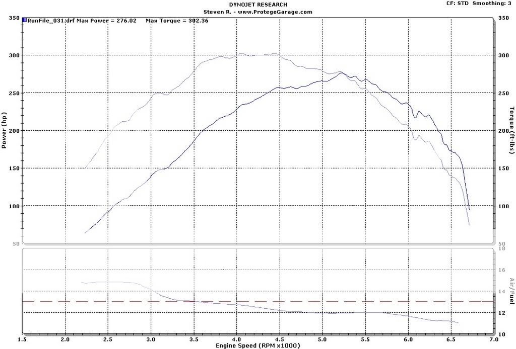

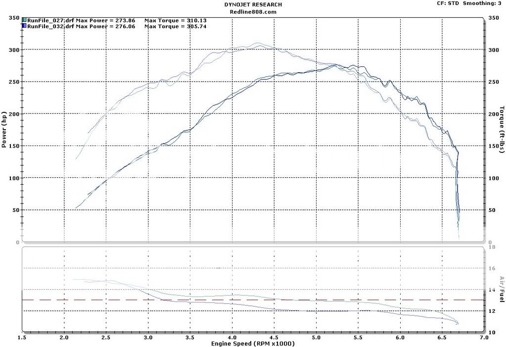

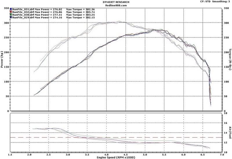

Here.. just for you.
Dynos
Videos

I dont have a short ram
XEDE + ProtegeGarage TMIC upgrade.
Did you happen to have a base run without the XEDE?
Also, are these recent graphs or are they from when you first added the XEDE? Thanks!
all graphs were with just the XEDE and TMIC.
My baseline run dyno was done incorrectly (Started sampling too late)
It was the average for ms3's. 240~hp and 260tq.
Xede
