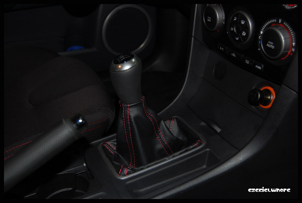

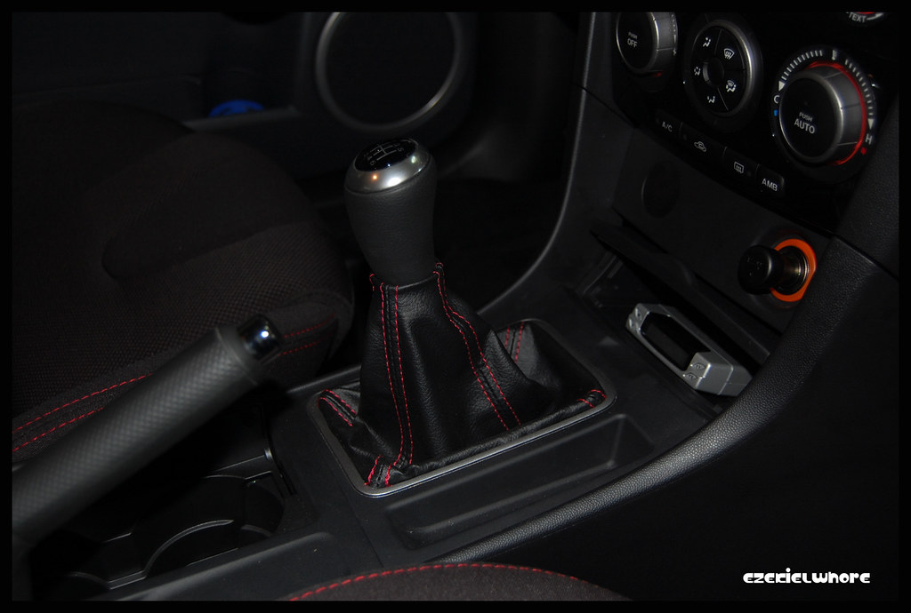

heres a picture of my finished product.
and got it to clear the door :)
