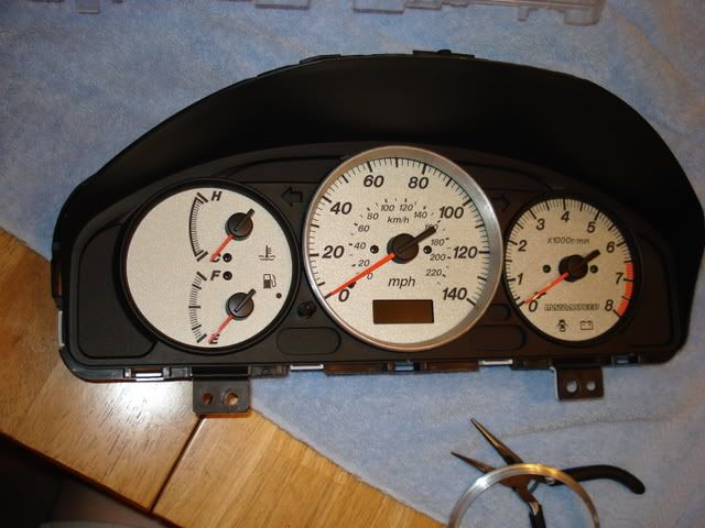

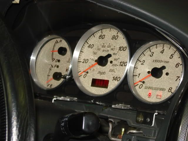

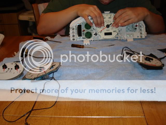

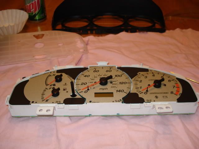

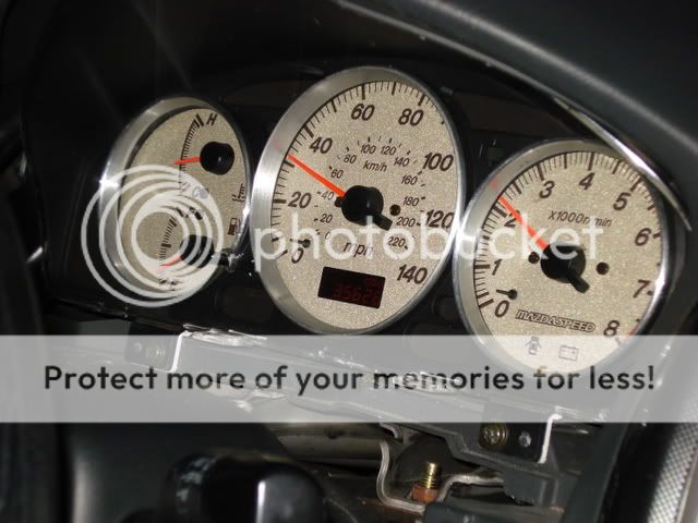

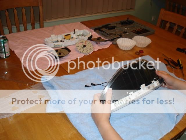

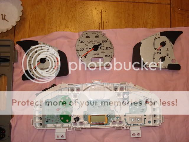

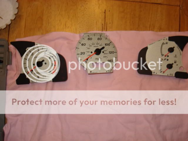

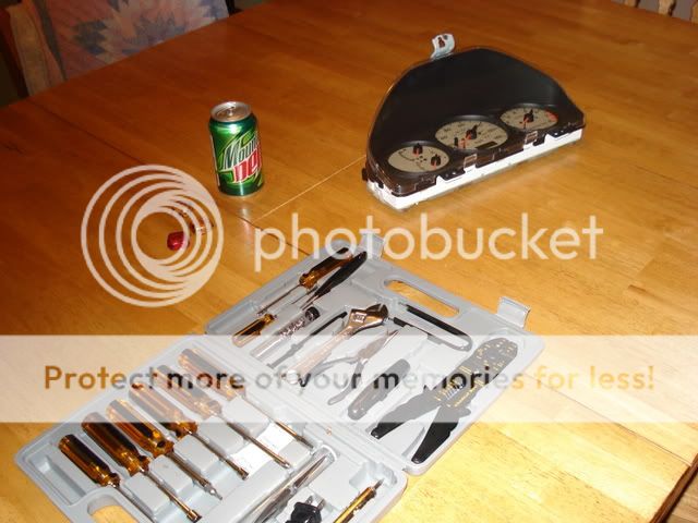

OK let me just start by saying how much this thread helped me . I have had my indiglo gauges in my car for like 2 yrs and havent had temp or gas . Only way i would know if my gas was low was wait for the light to come on . (flame2) So i got lucky and bought the Msp gauges from Twisted Msp whos motor blew this past week and i try out this how to . bc i didnt want to lose my mileage . his was 75k and mine was almost 40k so if i drove into the dealer they would be like your warranty is up sorry . so here are the pix that i took . I did one set of gauges while my g/f did the other set . TEAM WORK , Let me just say i was so nervous about doing this and having something else go wrong but everything went great . swap the faces on to my cluster and ecu and now i have Everything Gas , Temp , Tach ,with the Mazdaspeed logo . Hot s*** sorry but here are all the pix i took . that came out .
Sorry if i mixed up the order a little bit but you get the picture. Such a easy mod .. Great write up / How to !
