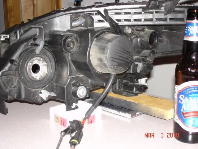

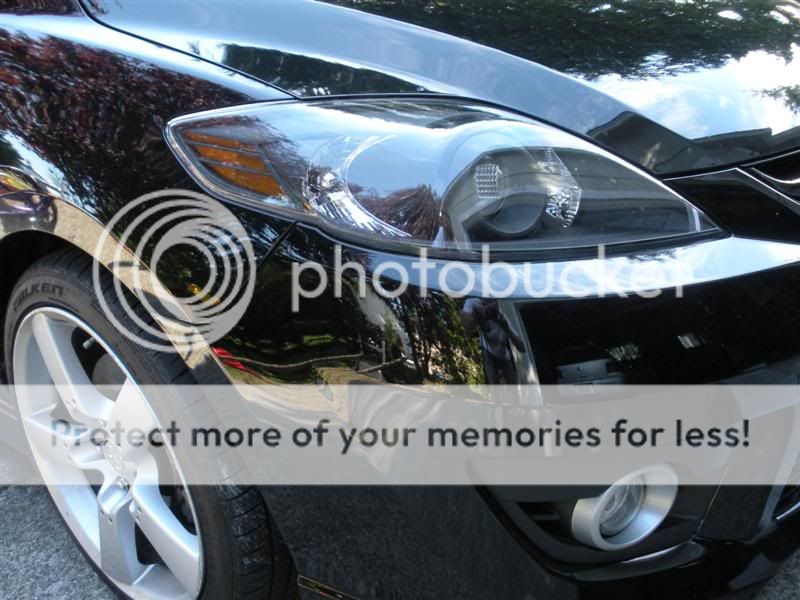

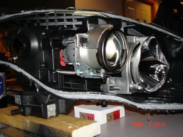

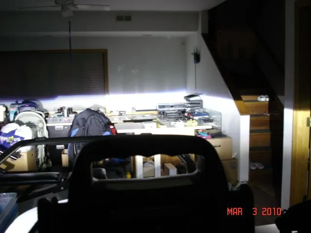

Here is couple pics for my TSX retrofit on my 08 touring. Those with color mod and painted shield.

... and i am using 6000K D2S bulbs with aftermarket ballasts. I am planning to get a pair of OEM ballasts, so i can mount them at the bottom of the headlight housing.

These look and work great so far! I think I might just upgrade the high beams to HID as well since I'm moving into the country a little bit.
I need to take some after pics of the lighting since the ones I took didn't do the kit justice.

I'm confused....Why did you need to take the lens off the light to put on HID's and were the ones from that website a direct fit? or do you need to take the headlight apart?(boom02)
If you take apart the headlights - you should also black out the surrounds. Both my VW & Mazda5 now.
