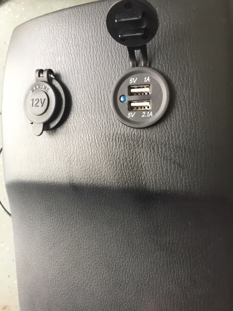

Adding 12v sockets for the rear seats

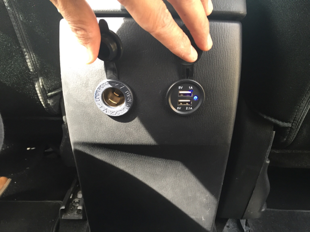

Is that the back seat view of the center console?

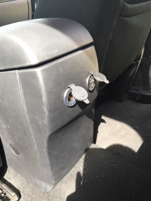

Yeah... but big fail on my part... i didnt check for clearance
the 12v sockets stick too far out and is hitting the latch as i try to put the rear cover back on... it would of work had i made them lower... a local dealer told me the rear panel is not available as a stand alone order... id have to reorder the whole console... $200 part...

ouch, I guess you could always plug up the holes with rubber grommets or pipe caps.
Do you have any room? Is so, figure out how much they would have to stick out and get someone to 3D print some spacers. You could pick up a bit of room be cutting the lugs half way back and soldering to them.

yeah i ordered some grommets... going to plug one hole and then use a grommet and just hang some female usb extension cables... id rather not spend $200 to fix my mistake... that money could go towards an exhaust haha

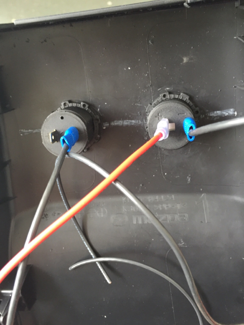

no didnt i didnt remove the whole center console... bought a fuse kit off amazon and extended the cable with more wire. https://www.amazon.com/dp/ (commissions earned)
I tucked the wire under the steering wheel followed through to the center console by just tucking it underneath the paneling. The back pops off pretty easy with some plastic tools. Just make sure to make the holes lower... i didnt provide enough clearance. my sockets hit the latch. if you decide to do it. just put the holes near the bottom of the panel.
I plan on trying to do this, but with the https://www.amazon.com/dp/ (commissions earned). I'll find room for it, or modify the inside of the console. Since there is a power outlet inside the console, I'll tap off that for power.
I think had I gone half inch lower i would of been fine. It would look funny on the outside in terms of hole placement.
I think you'll clear near the bottom. Good luck!

I plan on soldering leads to the terminals then cover with glue-lined heat shrink and putting a disconnect in the wires, or using flag terminal lugs instead of straight, to make the assy. a bit shorter.

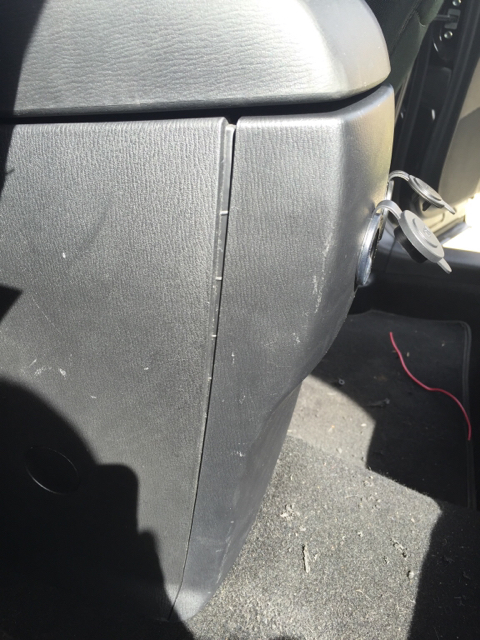

Update: was able to cut some of the plastic on the latch to create more room. Still not closing all the way. I'll work on it more this weekend
