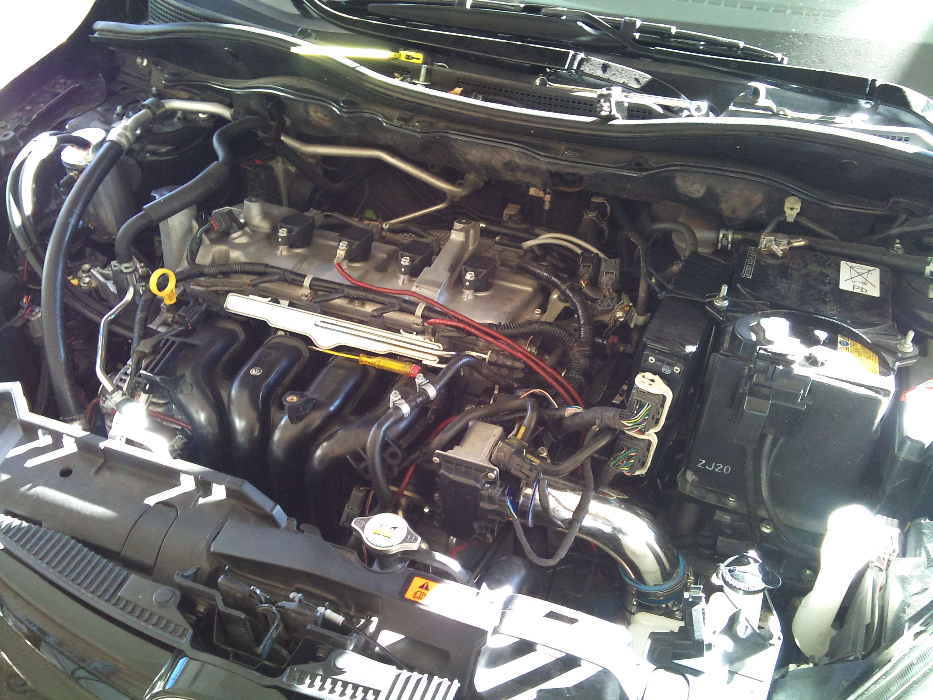

Finally i got the ecu to be reflashed

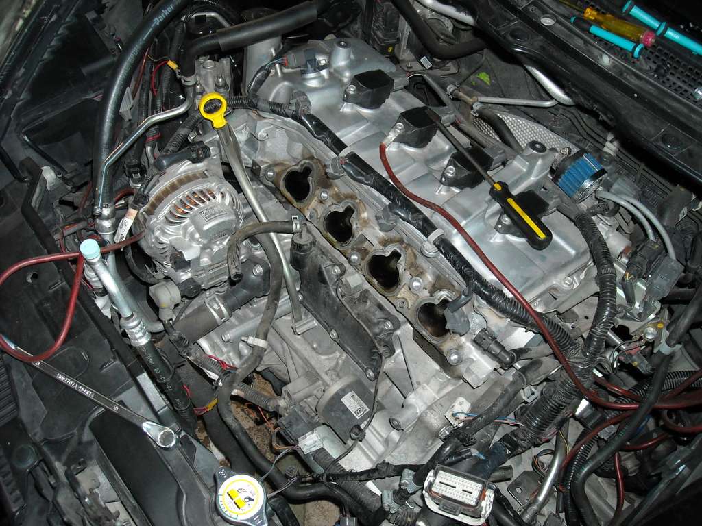

next installed an oil catch can

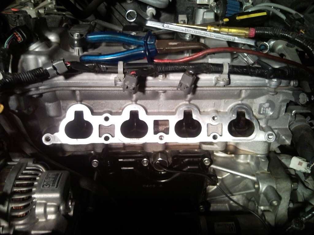

and also the airbox got the f*ck out of the bay (fuoops) (the photo is when i did a test fit before i make a mounting bracket).
+ bonus photos from cleaning the intake before installing the catch can

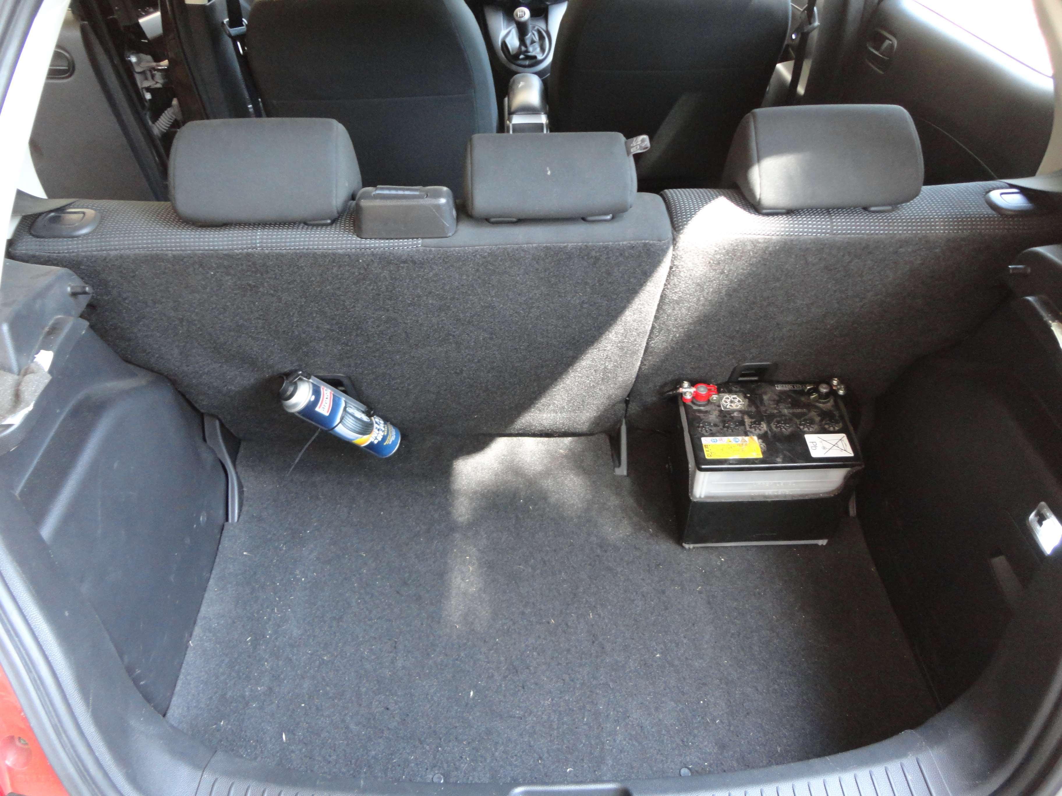

battery relocation @ boot/trunk to free up some space in the bay for the piping.

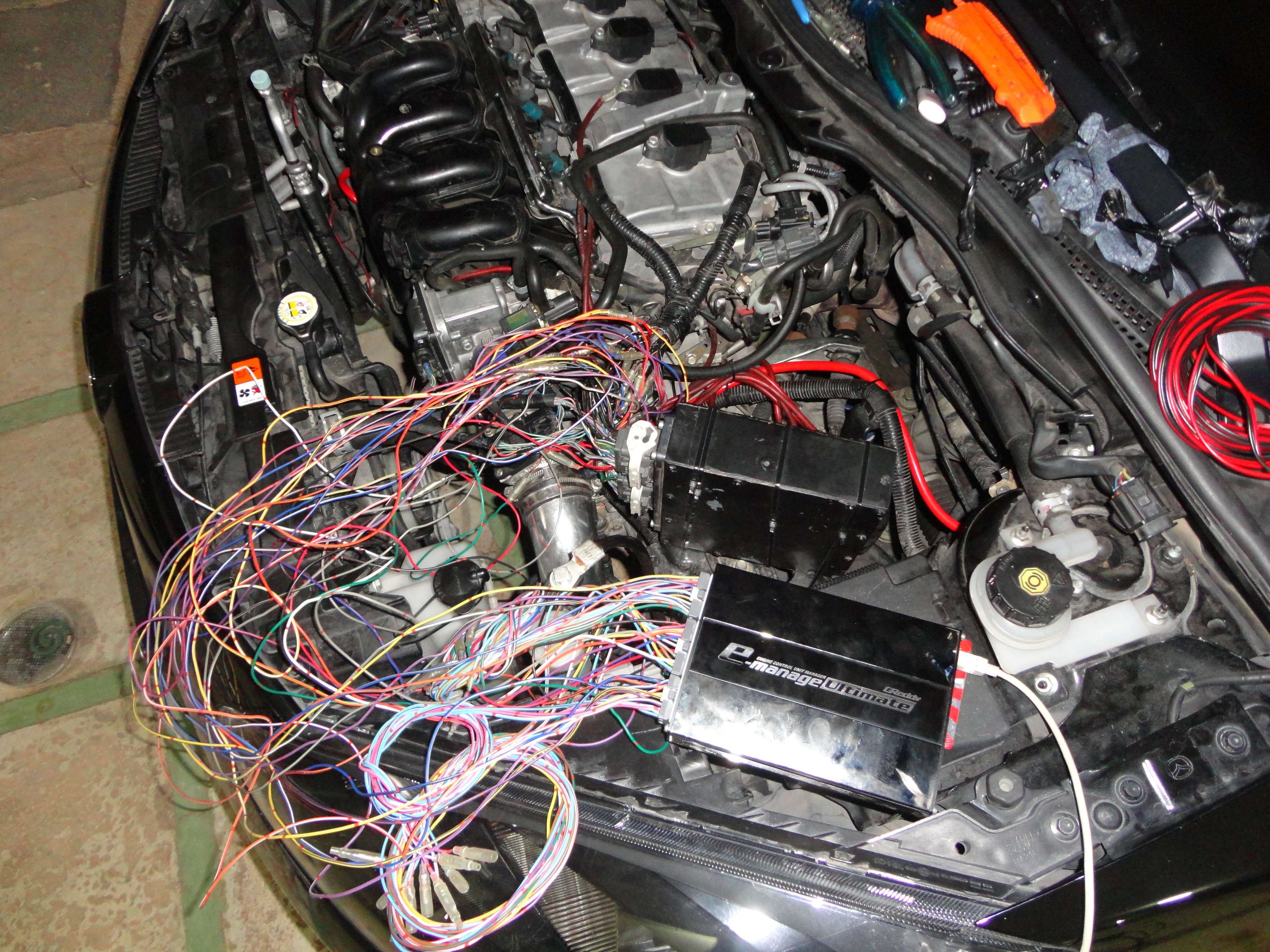

Installed an e-manage ultimate that i found very very cheap.I was able to get it for 250 with the harness and the map sensor.
Then i managed to enable the launch control. This is a video of the first try. I need to configure it a little better. The hard part was to find the vss...

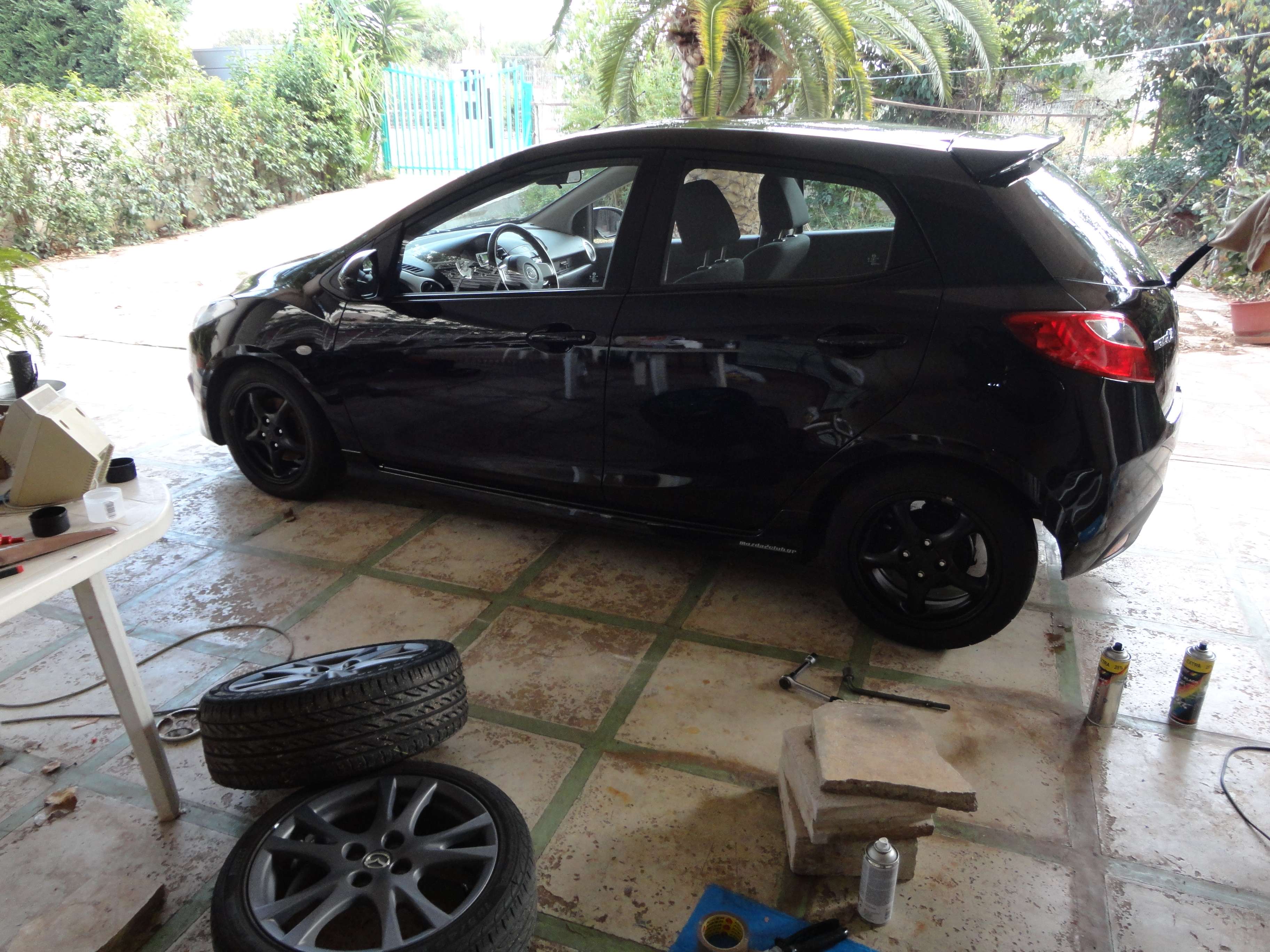

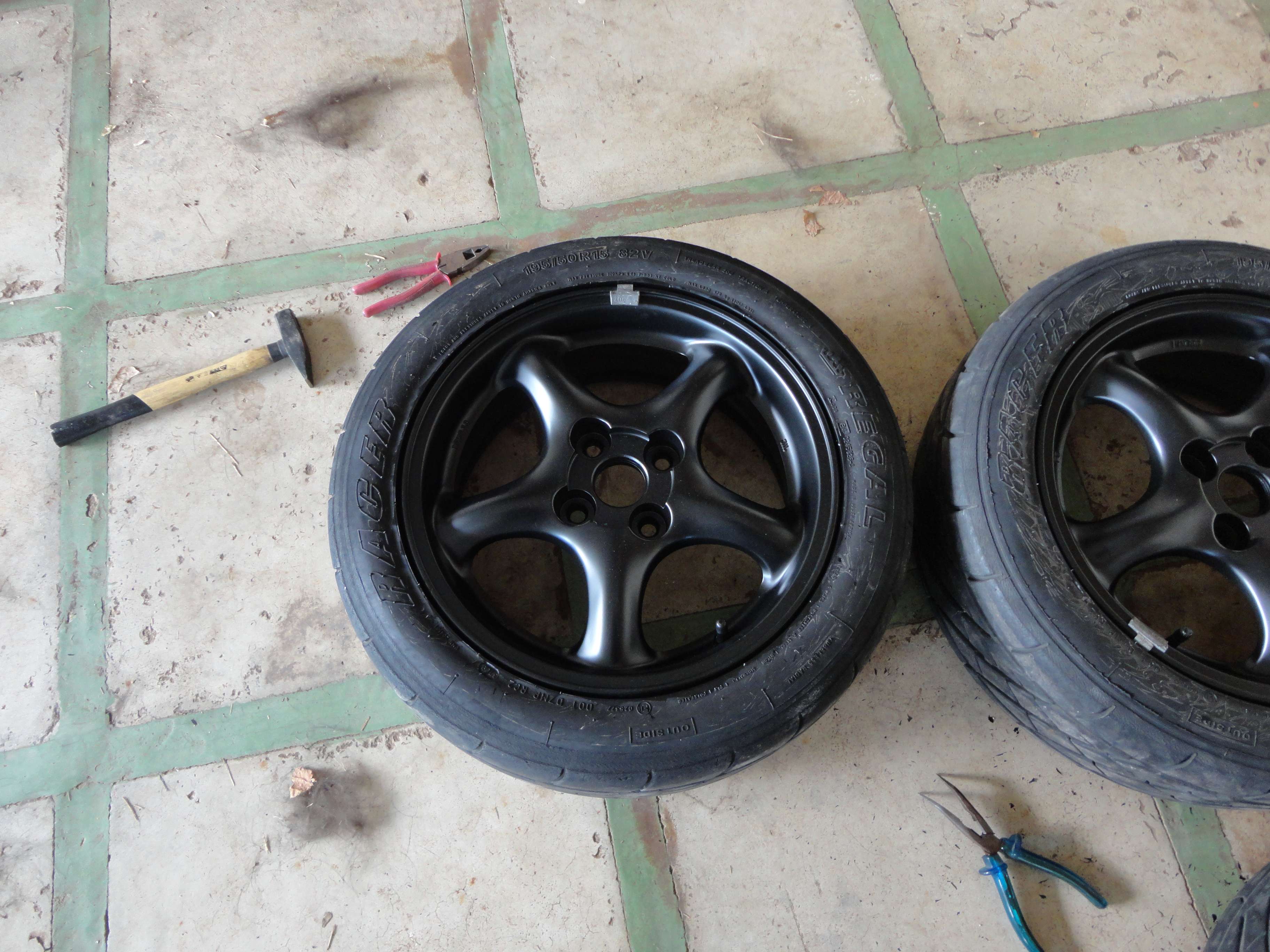

finally i painted the MX5 rims to matte black that i wanted to do over a year ago.
