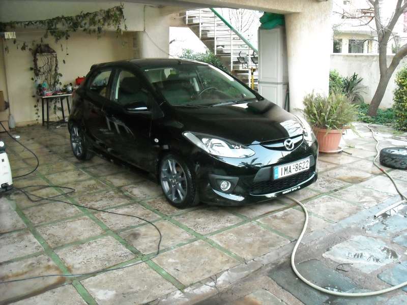

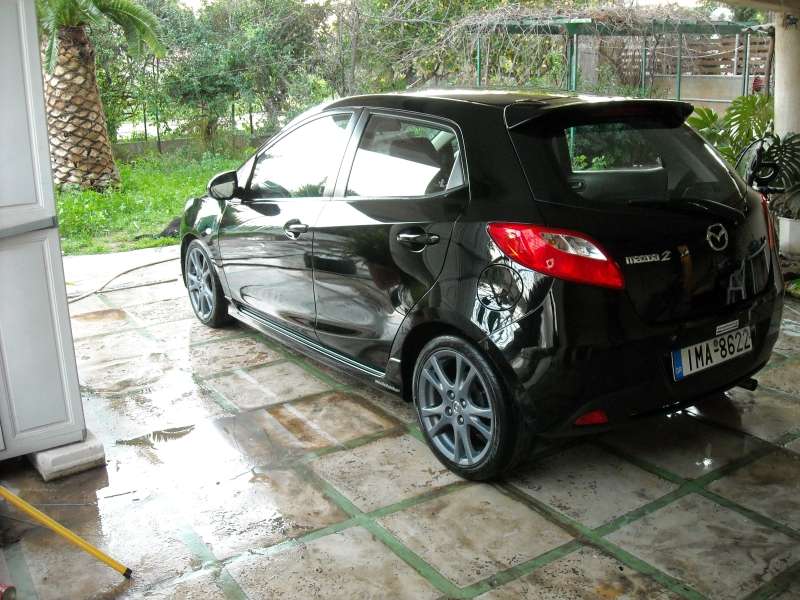

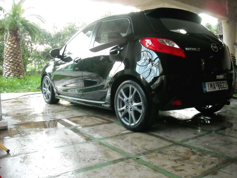

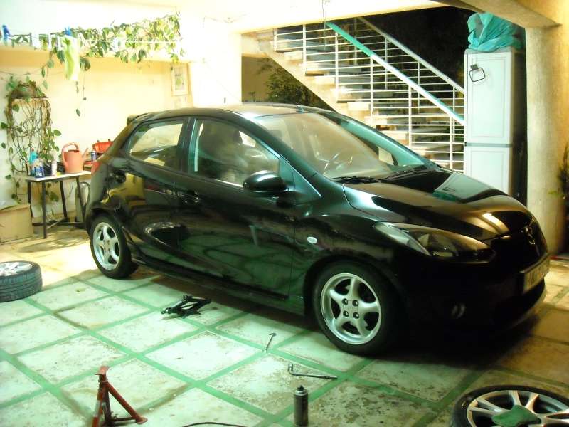

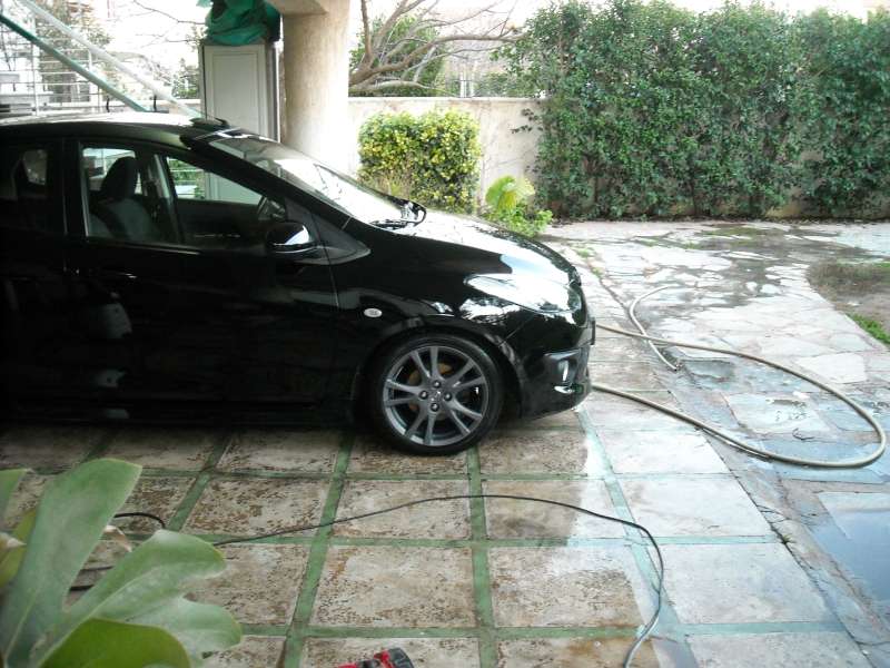

Bought a set of MX5 NB F/l rims for track use(mostly)
And repaint the stock ones

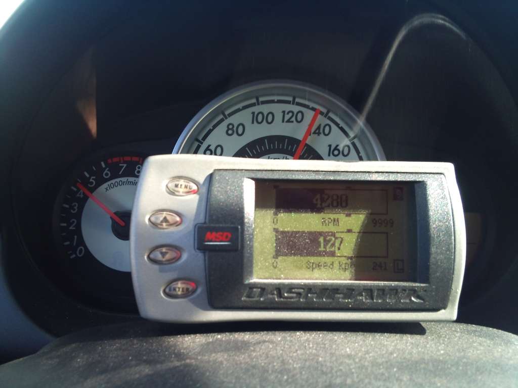

Gearbox from Mazda3 MK1 1.3/1.6cc. The gearbox case,mounting etc is identical to the 2 gearbox but it has shorter FGR(Final Gear Ratio) from 4.105 that is the stock to 4.388 and the fifth gear that is 0.820 while the stock is 0.775.
5th gear.Dashhawk shows the actual speed. The false of the dashboard it is not due to the gearbox. The same fault was with the stock transmission and i dont know why mazda did this, cause the dashhawk reads from the ECU the speed.
