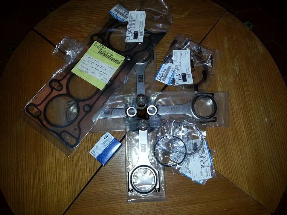

1st batch.....

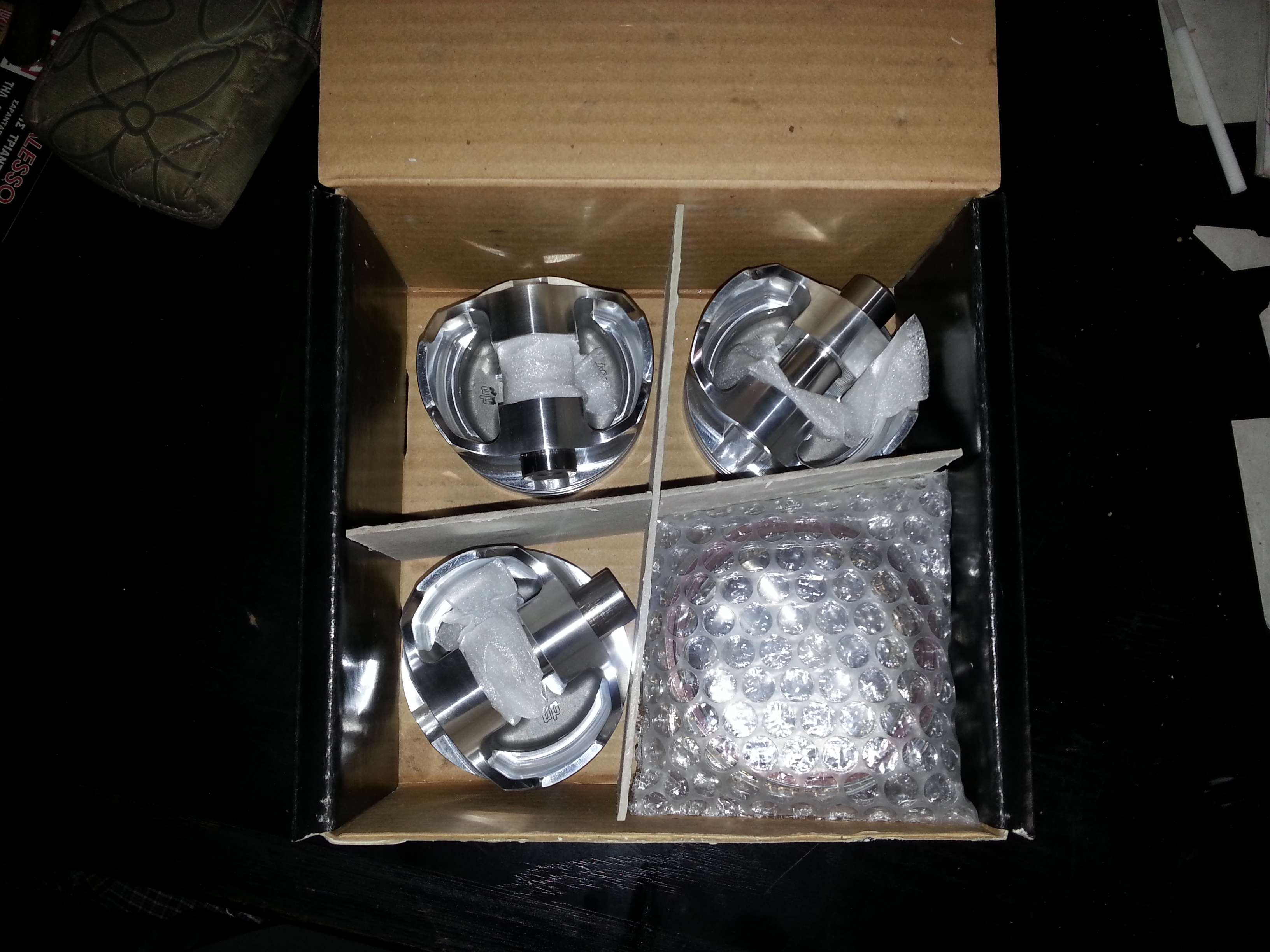

Waiting for the pistons....

my idea is use forged con rods for FS. are the same that use the mazda3 1.6 (z6 engine) but i cant find what pistons can we use whitout lose so much compression
It was exactly for this is that I wanted the measures.
I bought a Z6 engine instead of the ZY (it was also cheaper) ;)
I found out that the Z6 was using the FS rods back in 2008 when I was fooling around with the Mazda EPC.
The interesting thing is that there is also a longer variant of H beam rods for the FS(137mm vs 135mm of the stock FS rod) but still there is a difference of 1mm.

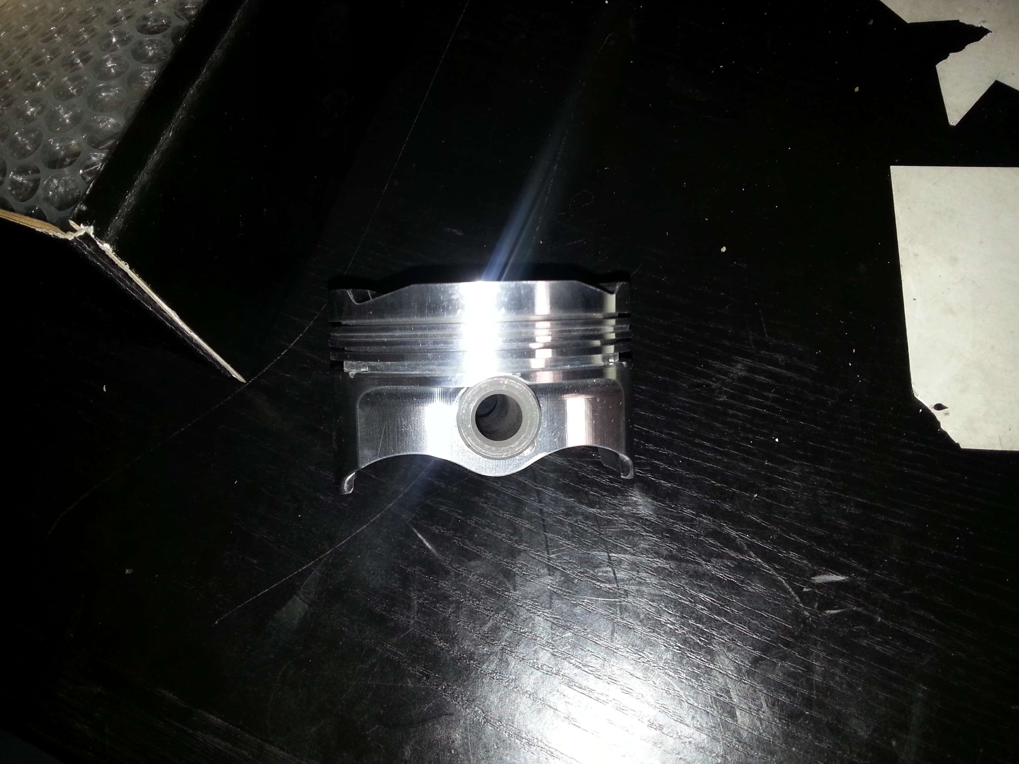

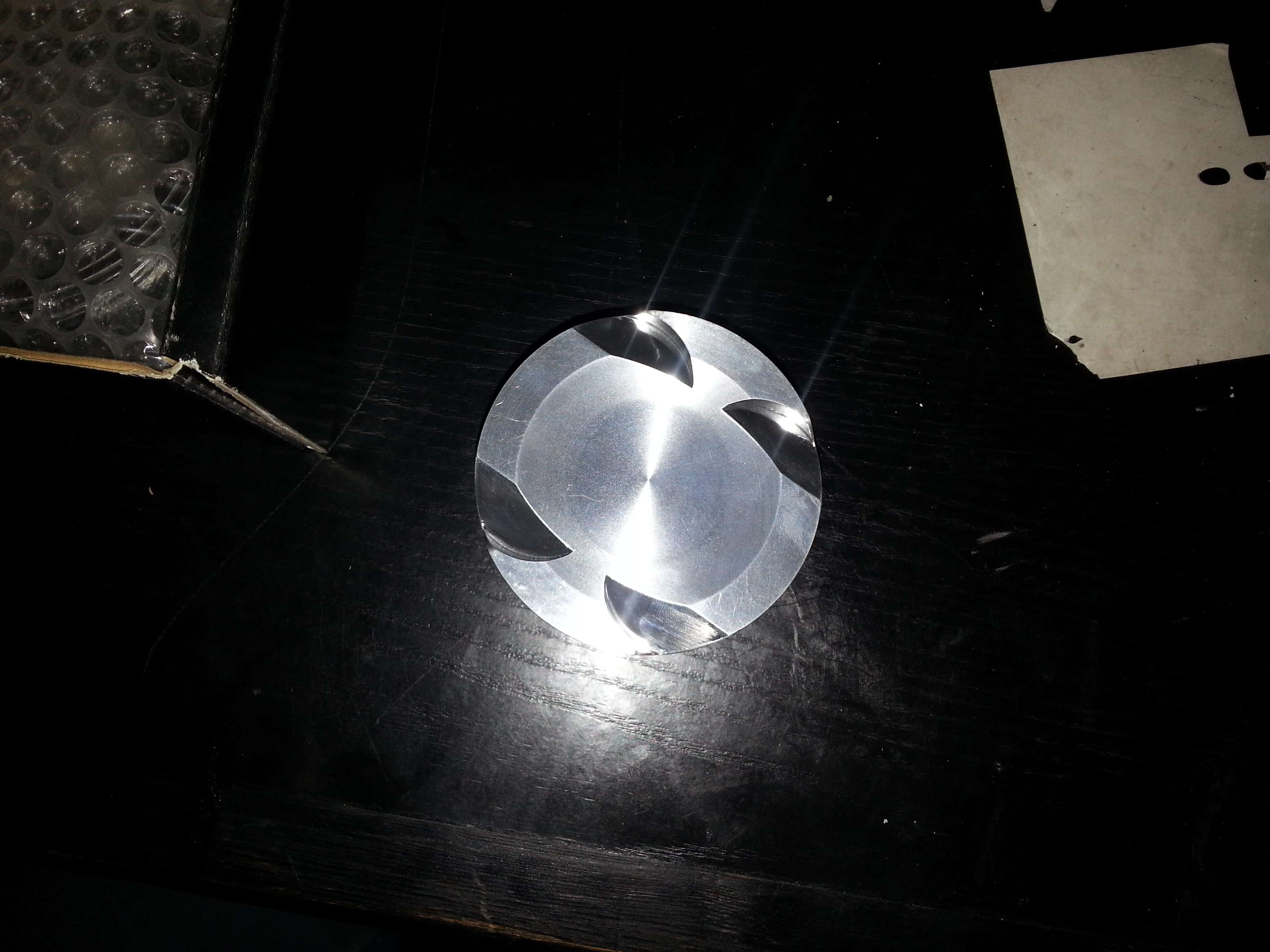

those are some pretty pistons! do the the heads have "up" printed on them?...that would be a hell of a mistake to goof that up.
