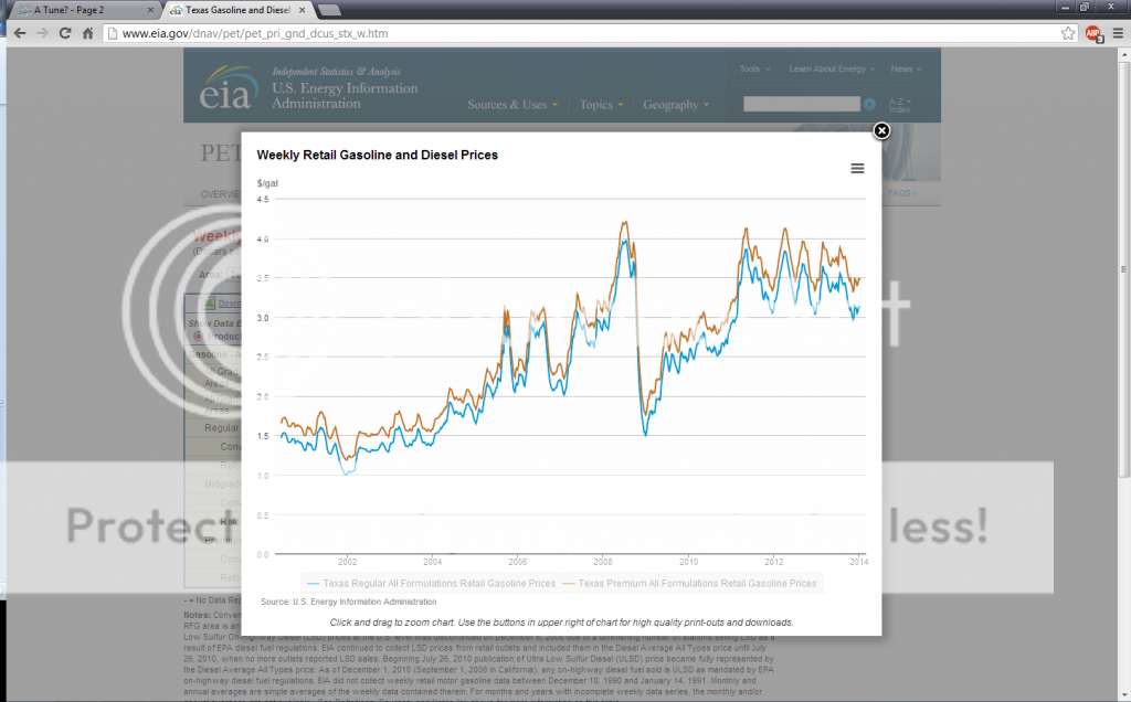

The current difference in price between regular and premium in my area is $0.319. The difference has been under $0.30 the last two years, and recently spiked slightly to ~$0.32, but we'll use $0.32 (source: US Energy Information Administration You can graph the info on the webpage, or download it in .xls form and manipulate it yourself.)
14,000 miles at 24.98mpg = 560.4 gallons
560.4 gallons at $0.32 extra for premium = $179.34.
So it costs me an extra $179 per year to use premium (about $15 per month, or $3.45 per week). I'll gladly pay $179 in fuel for 10hp. Some people might not.
