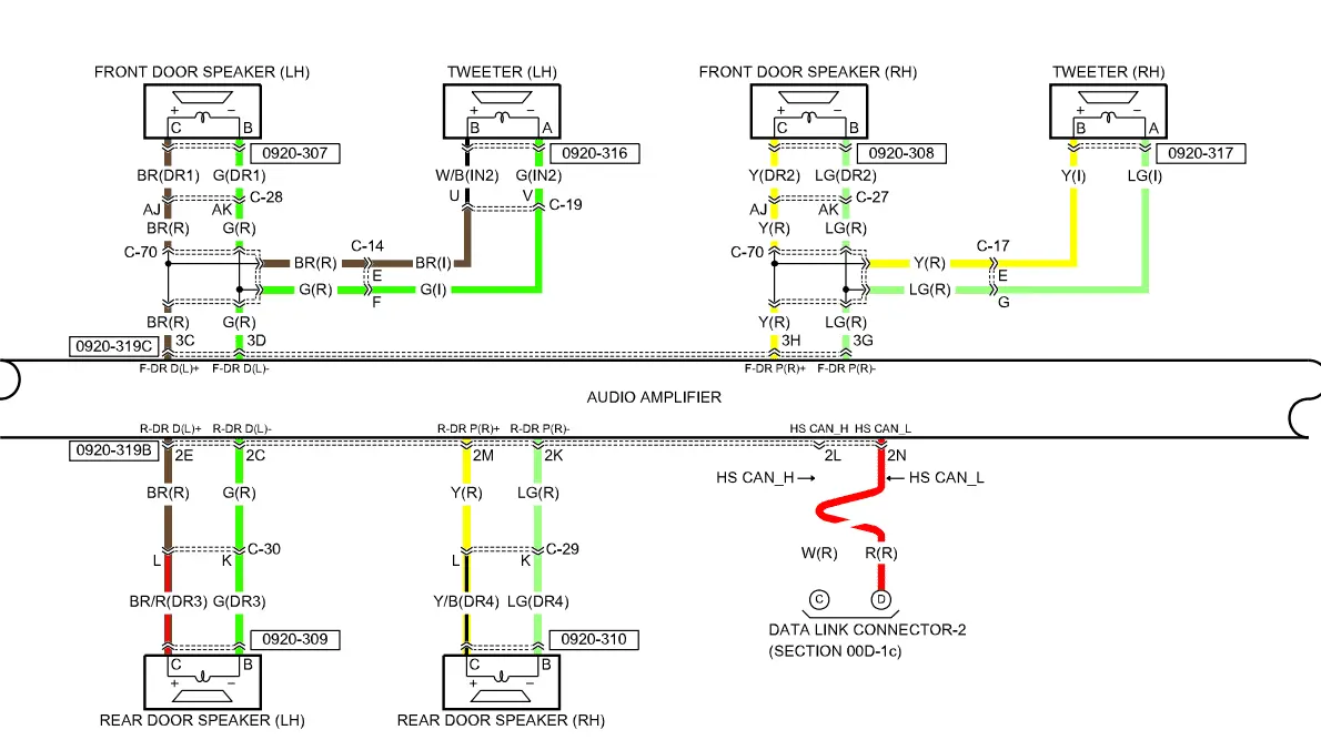

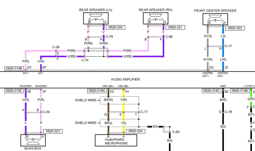

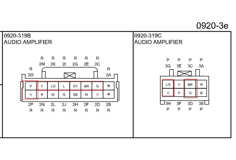

Here's a schematic and selection for the wires.
Any green wire from the selections in this harness is going to be the negative. I also did not hook up the subwoofer lines. From the factory, the wires from the harness are going to go directly to the speakers of the Bose system. Knowing this, I took the leads from the harness and fed them into the inputs of my DSP/Amp, and then connected the outputs of the DSP/Amp to the remaining leads to the Bose speakers.
Below are schematics that have been shared in this forum that helped out immensely! Thanks to all the members who have shared the wiring diagrams within the threads!

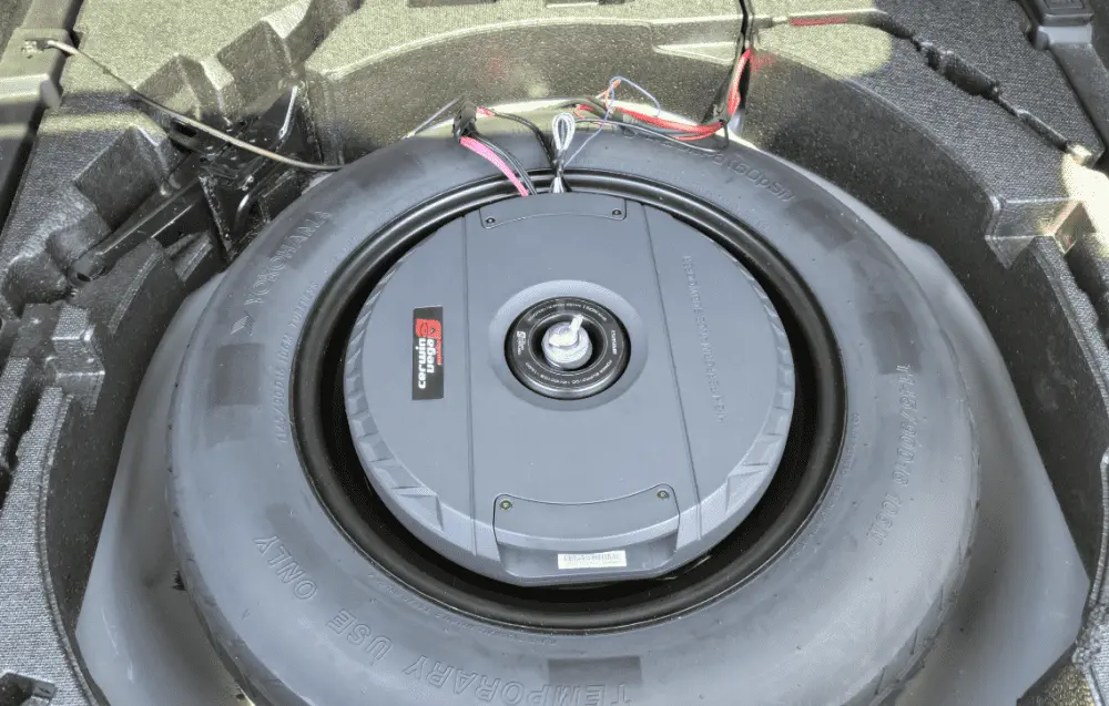

The Cerwin Vega VPAS12ST!!! I had to use the other spare tire threaded rod vs the black one with a hex bolt. There was still a gap when fully tightened, so I used metal washers and a foam spacer. I'll be redoing this, as I have some rubber spacers to add. Once I get some wire loom in, I'll be cleaning up the wires.

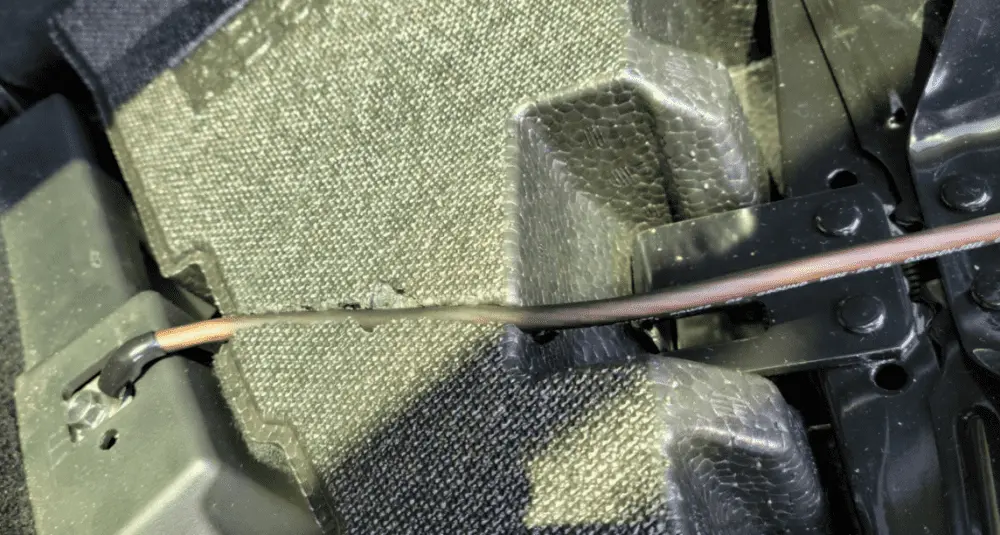

Ground goes to the cargo hook bolt. I've always used them without fail. I also filed a little channel in the foam to route it and keep it level with the cargo board that goes on top.
I'm still in the tuning process. The subwoofer sounds amazing without the cargo board on top. However, with it, I am unsure of how I like the sound. It is plenty powerful, but requires some pretty good tuning to make sure it sounds good. There is rattle due to the cargo board. In the process of fixing that. I'll probably end up dampening the board, the entire truck, and the spare tire. That's another $100 to ensure better sound.

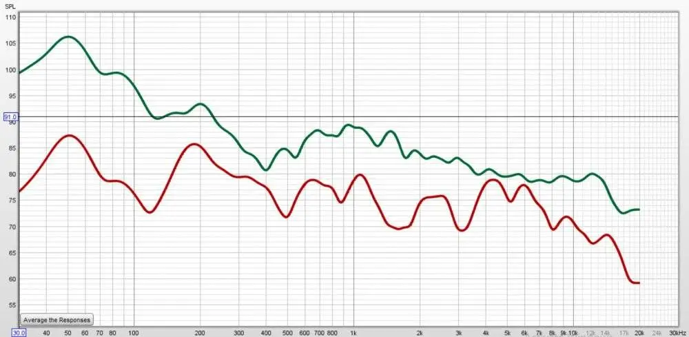

EQ Update:
It's difficult getting the curve that I'm aiming for with the current tools I have. No dedicated microphone, as I'm using my phone and Audio Tools. Best curve I can do is from 20-100 +5db with a gradual drop to flat at 250. It stays flat until 1k hz and slowly drops down from there at a total of -3db at 8k hz. Sounds great though!
Regarding the subwoofer, I do have it tuned to where I like it. It comes with 20hz bass boost. To get the right sound to where my ears weren't getting distressed, I lowered gain to increase the bass boost to about 1/3 from none. I got to say, this set up is competing with my Hertz setup in my fiance's car pretty well.

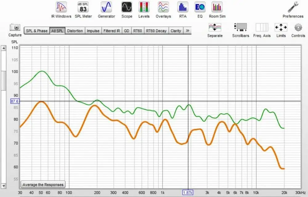

EQ Update:
AHH!!! Bro, look into picking up a UMIK-1. They aren't very expensive at all and interface perfectly with Room EQ Wizard (REW).
My DSP is the uber affordable Dayton Audio DSP-408 (first DSP I've ever played with, by the way), and I've been having terrific results with the combo of the UMIK-1, REW, and the DSP.

Mine are looking very similar except for the lower end. If you can get the 315-600 to be more gradual, you may find it more pleasant! At least for my ears it was.

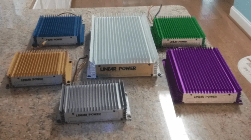

I have the Linear Power LP65ca set which the tweets will be running off of a modded green Linear 952IQ and the mids off of a purple 1502IQ. The sub is a Sundown Audio SD10D4 at 8 ohms, driven by a white modded Linear 5002 in bridged mode. That 5002 is an absolute MONSTER of an amp. I have a Lithium battery pack made of 8 Headway 38120HP cells along with an array of Maxwell Ultracapacitors to feed that beast.
Wow that is a beast of a set up - would love to hear if I was stateside ( even less likely now with (“Old Kung flue scares”) and the audio curve you show would make it pretty explosive with some lively music. Should have written this note in green ( to match my envy) Per yourself and Mike’s previous notes - regarding sound deadening - I fully agree - this can even make the most mediocre system sound much better - I did carry out to boot and rear wheel arches during install and to some degree elsewhere but due to time factors still have the doors to finish as I didn’t get around to removing the glass for full access and I agree door cards are also worth doing…. My next little project is big 3 as I said , cos I have some 4AWG left over and being of Scottish blood - hate waste - Hock Heye 🏴󠁧󠁢󠁳󠁣󠁴󠁿🇬🇧
