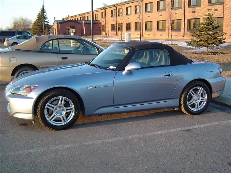

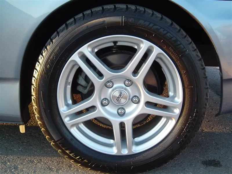

A performance winter tire is a must if it snows alot where you live. Something like Blizzak LM-22's or Pirreli Sottozero's. Unfortunately, 18" snows are damn expensive. They're twice as expensive as 16" snows. I bought a set of Blizzaks mounted on some cheap "Fox 5" alloys from Tirerack a few years ago for my S2000. I had my S2000 in Grand Forks, ND for a while. I saw snow in May there. (argh) Fortunately I kept them after I got rid of the S200 and what do ya know? They'll fit the MS3! They'll probably look stupid in 16", but I really don't care. The wheels were $99 each and I paid about a grand for the whole sha-bang shipped to my door. 18's on the other hand are going to be nearly a grand just for the tires.
