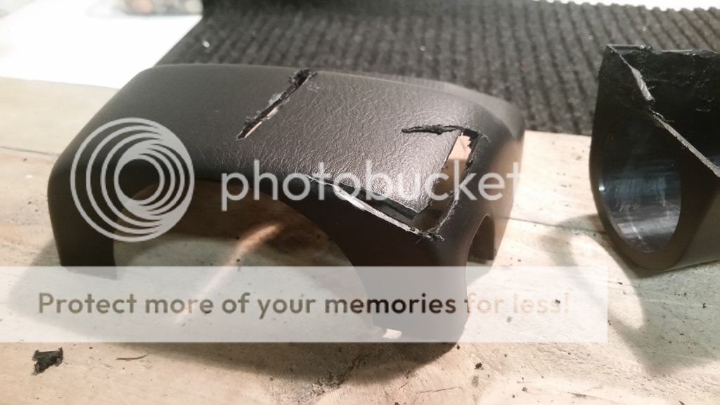

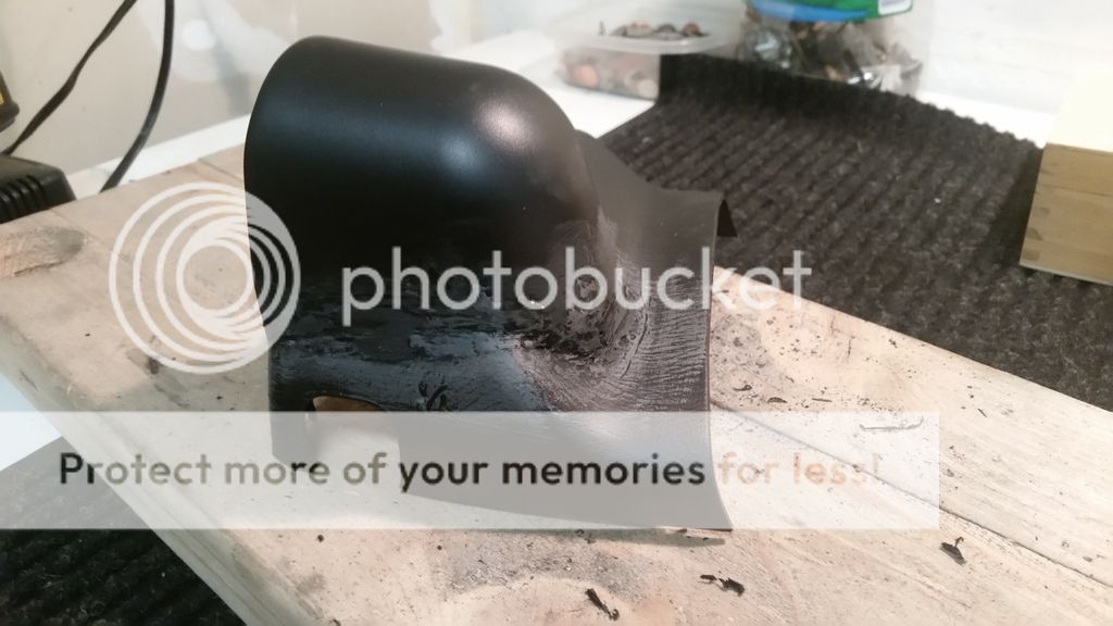

So far so good. Picked up a $6 ebay pod and got hacking away.
After a few minutes of fiddling I had some resemblance of something halfway decent.
Welded with a soldering iron using the scraps.

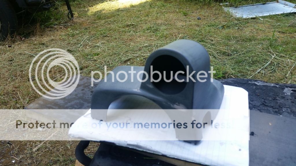

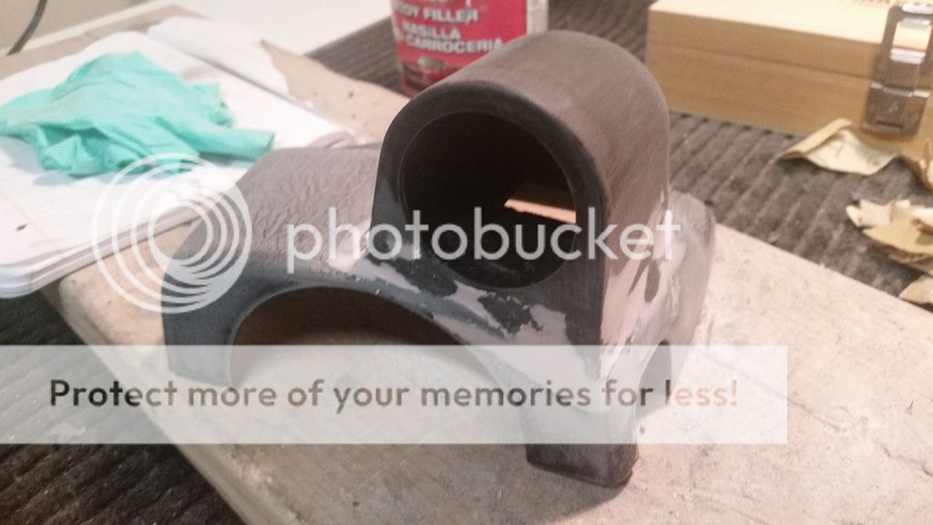

Little bit of body work.
It's coming along.

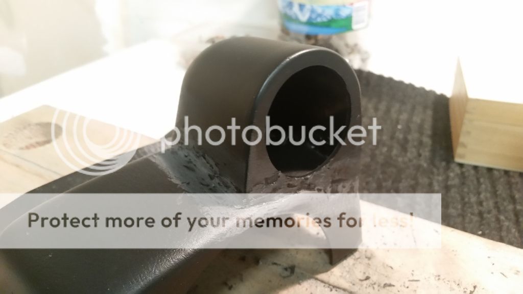

Finished up the column pod.
Here it is before the last coat of primer

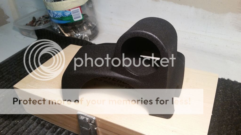

And here it is after a coat of textured trunk paint, two coats of black, and two coats of clear. Factory-looking is always the goal.

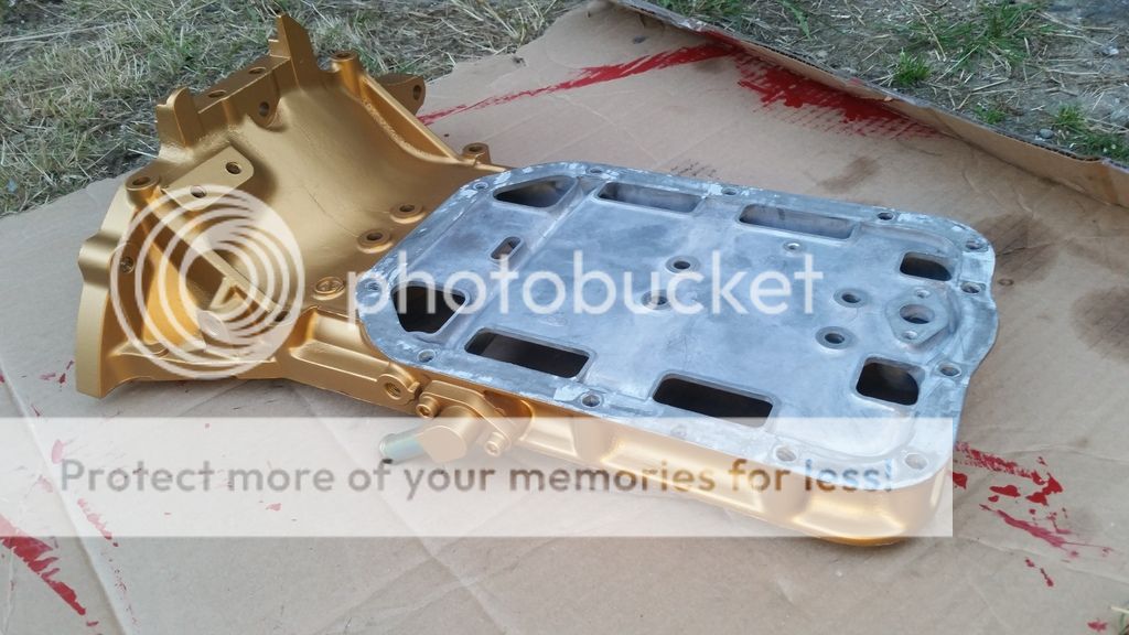

Recieved my MSP MBSP from fuadmsp. Cleaned the rest of the silicone off to the best of my ability, and I've been experimenting with colors. What do you guys think. I want to paint the block and trans a cool color, I'm sick of black and silver, although a silver block might be nice. Mostly I just want something a little more showy since ill have it all apart anyway. Still will need to be classy and clean though. Also cant clash with the yellow, so I might be ditching all traces of red, unless its kind of dark. Anyway, input is welcome.

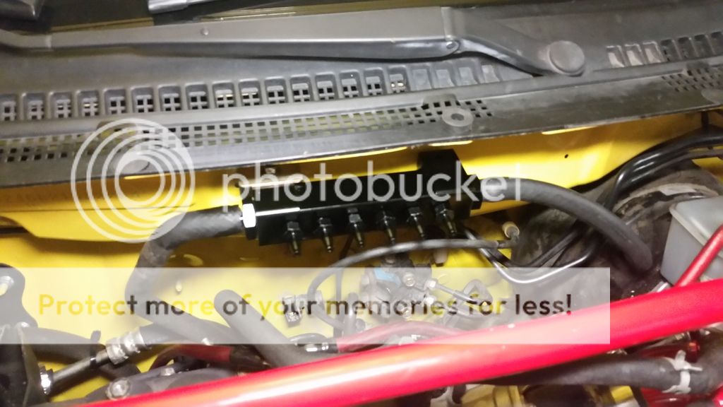

And here is a vacuum dist. block i'll be using. Mounts on one side to a bracket bolted to the firewall. And I made the brake booster hose out of a spare one I had mixed with part of one off my old MPV. The curves down to the manifold are 100% perfect.
Its hard to think of a color that will go well with yellow lol. I do like the color on the MBSP, can't picture what it'll look like with a yellow engine bay though. The hose you used for the vac block has the check valve in it right? Somewhere in between the brake booster and the vac block?
Yeah, the check valve is in there. I'm trying to picture a cream/tan. I was originally going to paint my racing Harts that color. I wasn't low enough to pull it off at the time though.
