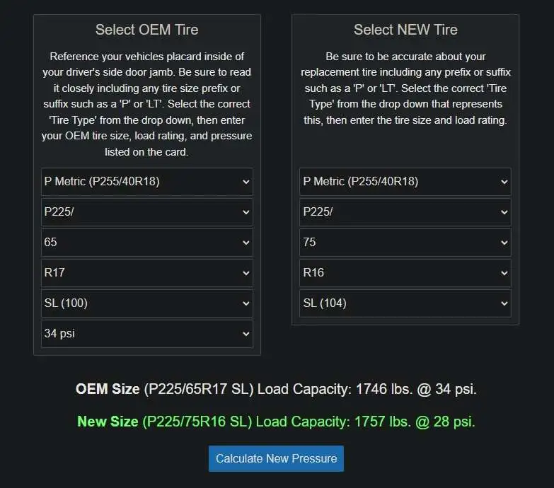

I use 27 PSI cold pressure. Tire pressure calculator is 28 psi (6 lower than the standard tire) and I go 1 psi lower. 26 psi is the lowest pressure recommended in this size.

Larger tires with a higher load index can use lower pressure.
225/75R16 104H in your calculator is a “larger” tire than your OE Yokohama Geolandar G91A 225/65R17 100H tire? And “slightly larger” OE Toyo A36 225/55R19 99V uses higher 35 psi recommended by Mazda for the same CX-5?

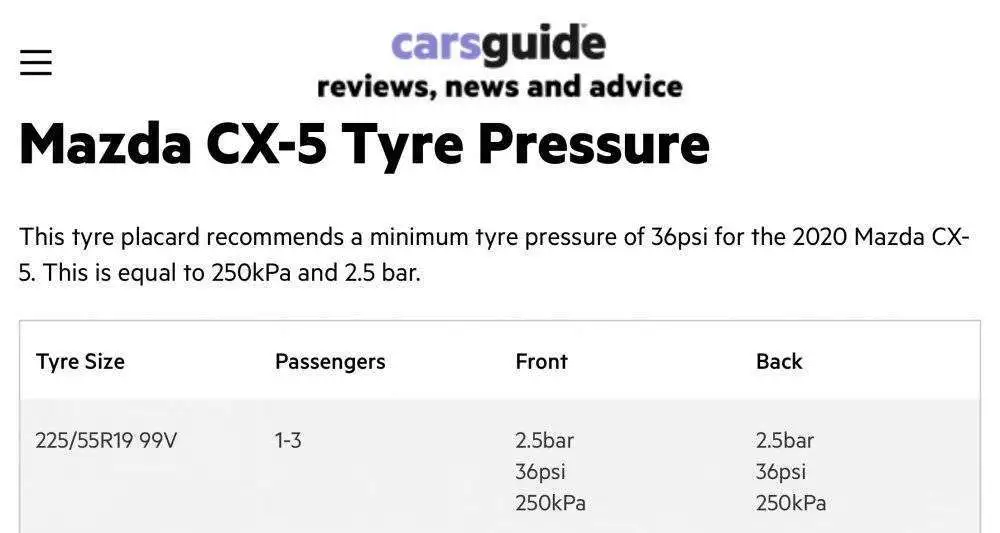

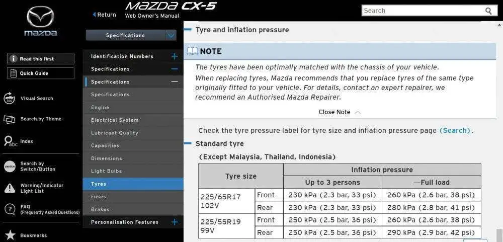

Mazda in US gives only one tire pressure recommendation. But here are multiple tire pressure recommendations from Mazda for CX-5’s in Europe:

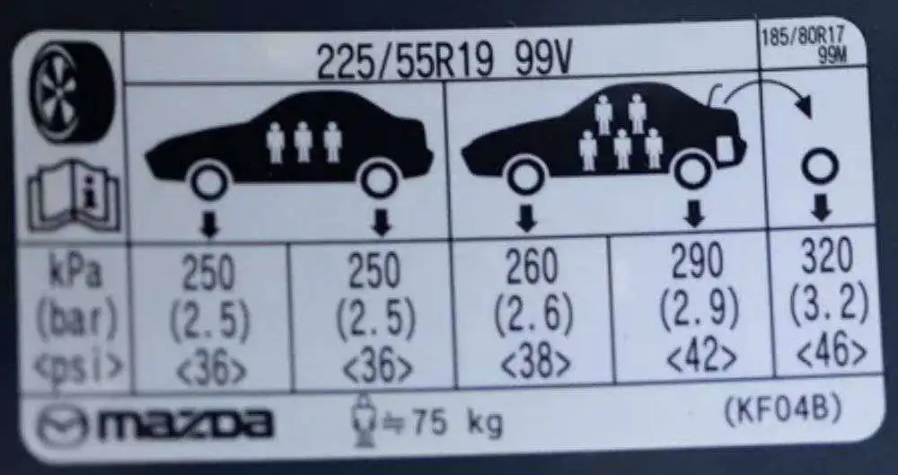

I set my CX5 19" overnight cold to the recommendations on the place card inside the driver's door. This recommendation should be all around best for Ride, Safety and longevity. If you go above or below more than 10%, then you are biasing one at the expense of the others. Ed

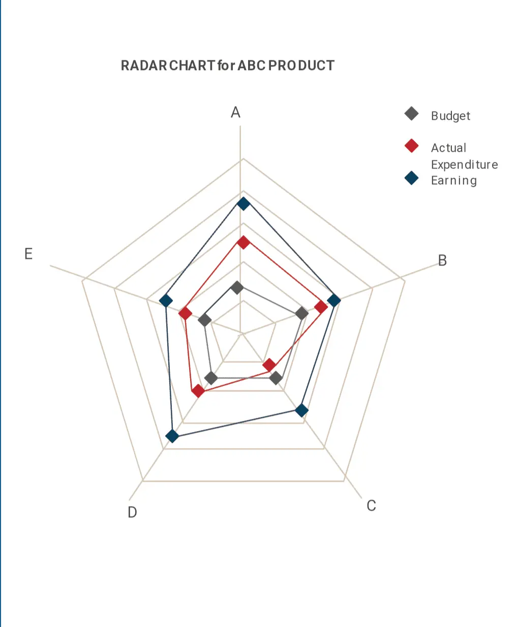

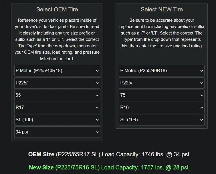

As @erhayes and some others have indicated, tire pressure effects many different things. I visualize it like those radar charts or "spider" charts that you often see on tire sites comparing different tires: (just an example below)
Where the letters around the outside would be your attributes (tire wear, comfort, wet grip, dry grip, load carrying, etc) and the colored lines would be various pressure settings.
The manufacturer recommendation is a balance but if a particular attribute is more important to you, by all means, adjust the pressure to your liking. Just be aware/understand how that effects the other attributes. If a softer ride is most important to you and you drop your pressure to 27 (or 31 or whatever) psi just realize that the tires will likely wear faster, build more heat, hydroplane at lower speeds (see Horne's principle if you wanna geek out on aviation stuff lol ) have increased stopping distances, etc.
