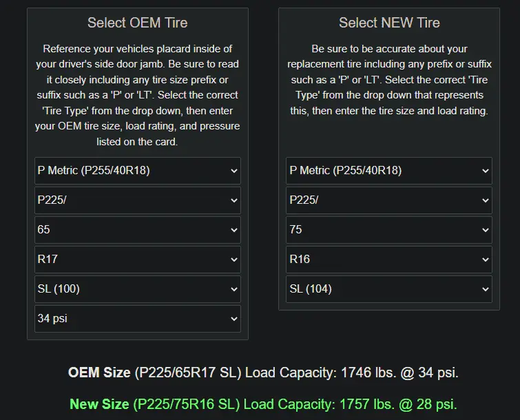

I use 27 PSI cold pressure. Tire pressure calculator is 28 psi (6 lower than the standard tire) and I go 1 psi lower. 26 psi is the lowest pressure recommended in this size.
